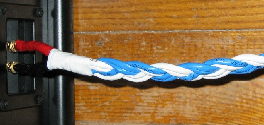

if you have the patience you could braid some cat5 cables
do you have by any cance a image how this sould look like? And how many of the wires should than be soldered?
We tried the braided cable, a single cable, and a pair of single strands from the bundle (split apart and either separated or would in opposite spirals around a neutral holder) and preferred the last -- as long as your speakers are efficient enuff that current needs are not high.

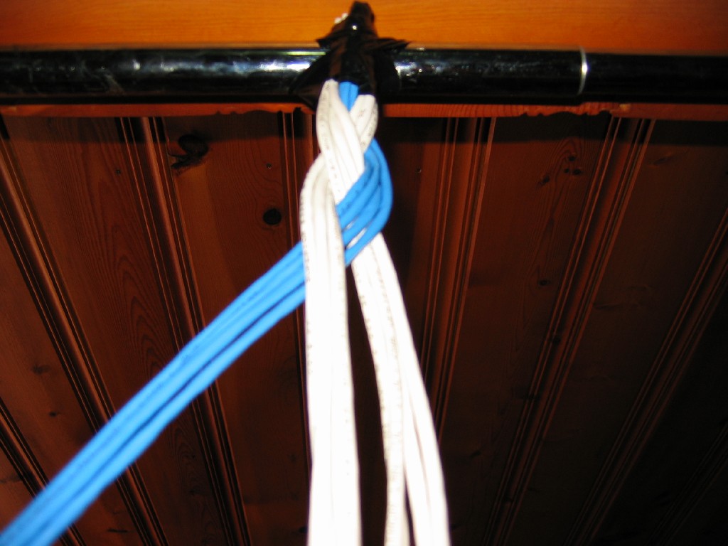

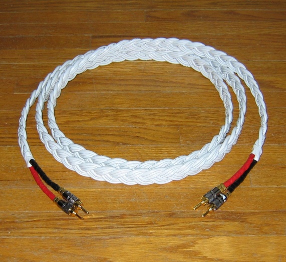

I like the cat5e cables as well, here is some info on them
Humble Homemade Hifi
I am getting very good results with 6, 9 and 12 wire sets for high current applications, and if you braid them carefully they look nice too.
Here is a helpful place to read up on braiding different amounts of wires.
OPCS - Braiding Wires
I just saved up left over scraps and cutoffs from network cable installs, the only thing I had to buy was ends which you can get for a reasonable price on eBay. Make sure you allow for the extra length required due to braiding (20% or so).
