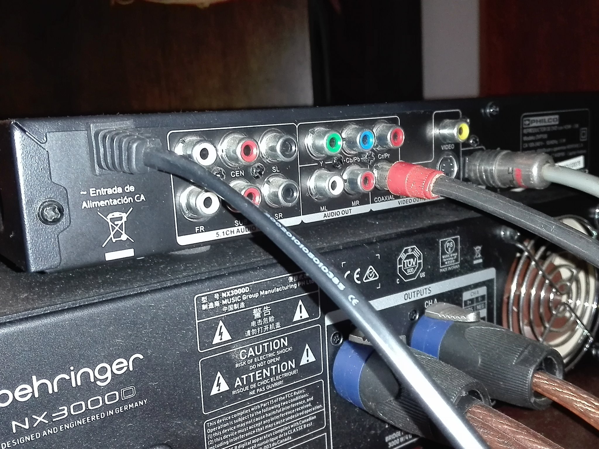

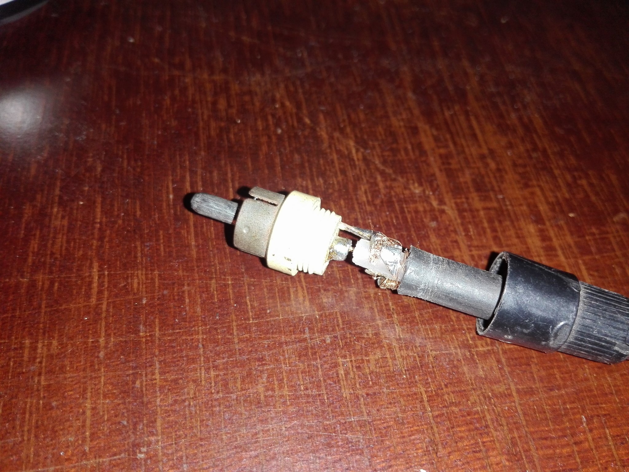

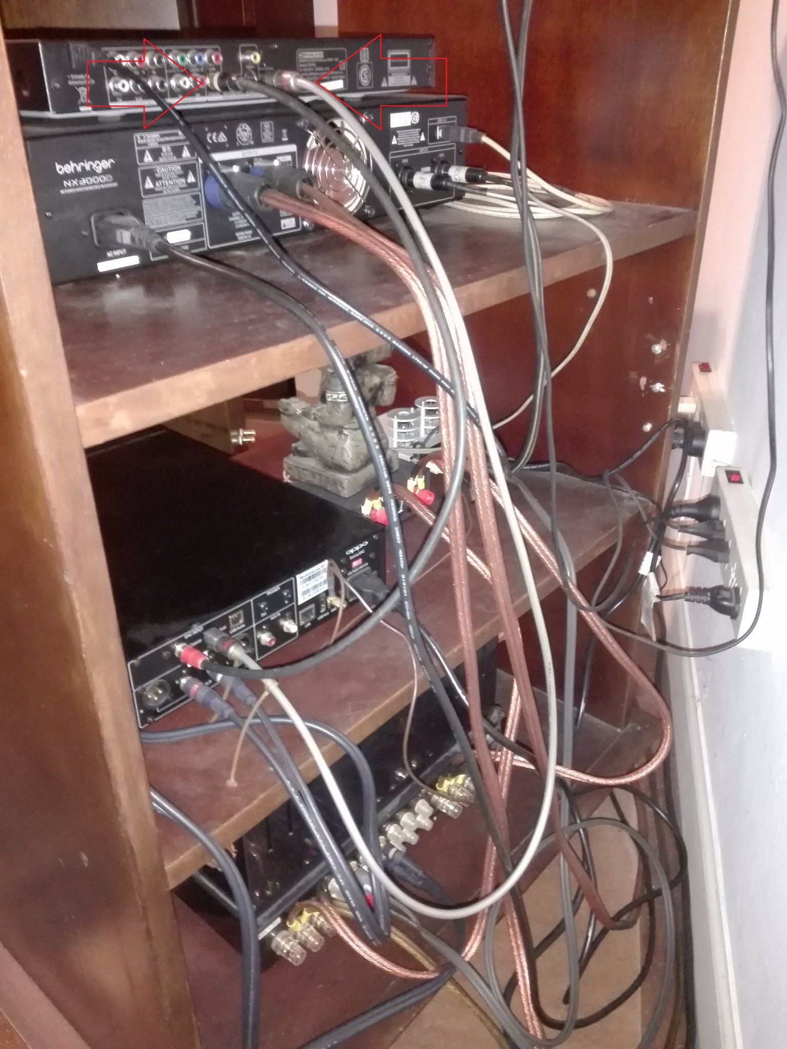

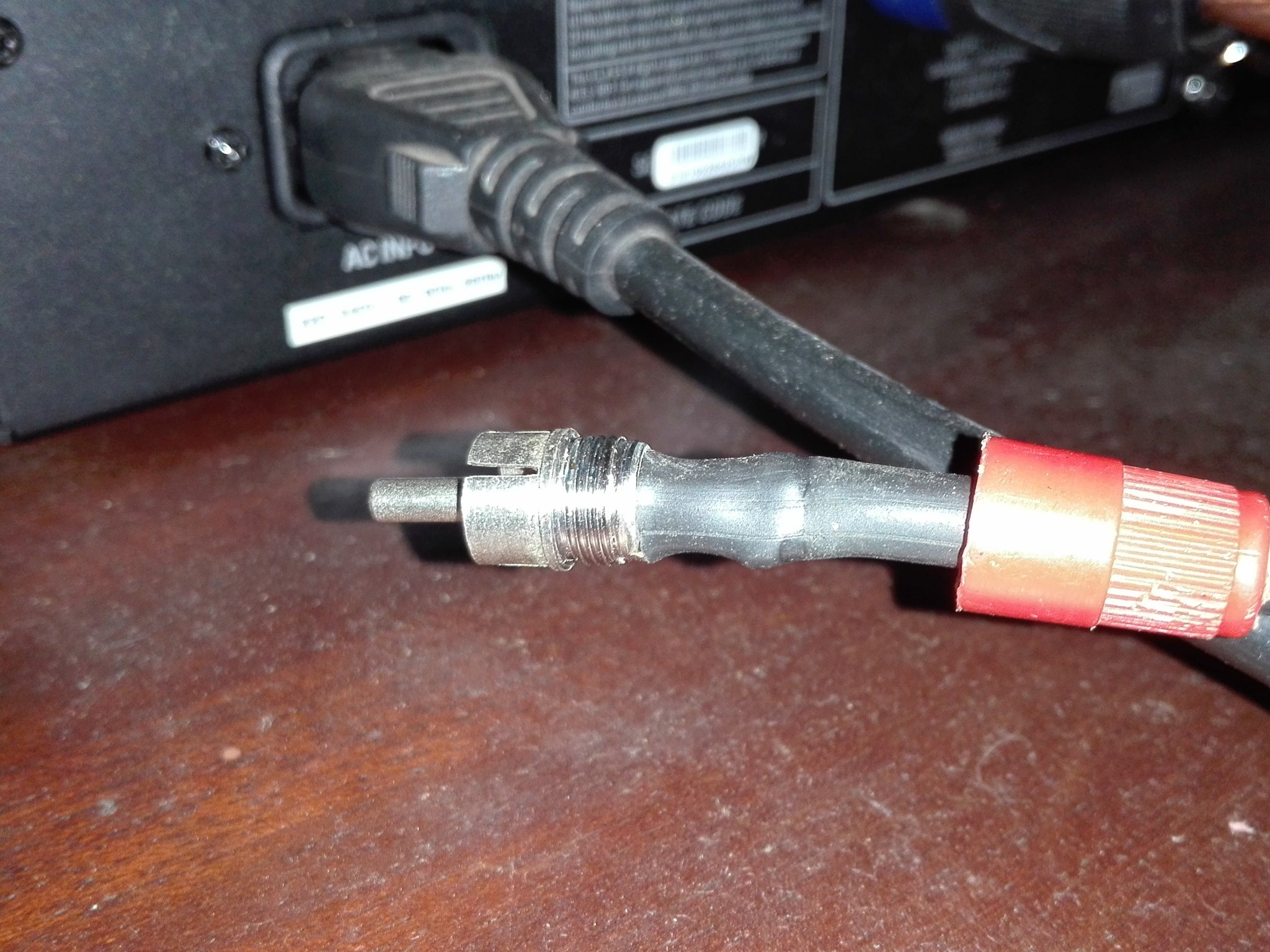

And I tell you that I found among the old junk a coaxial cable of 75 Ohms of characteristic impedance and RCA connectors at its ends.
The appearance of the connectors shows their age, without chrome plating and some surface rust, which I neatly removed with fine steel shavings, the kind used/used to clean kitchen appliances, not exactly Teflon pans or pots...
Since I consider myself an audiophile but not a regular consumer of "wonder gadgets" from the "snake oil" field, I decided to give it a try. One less job is one less job. It is the ideal length, eureka!

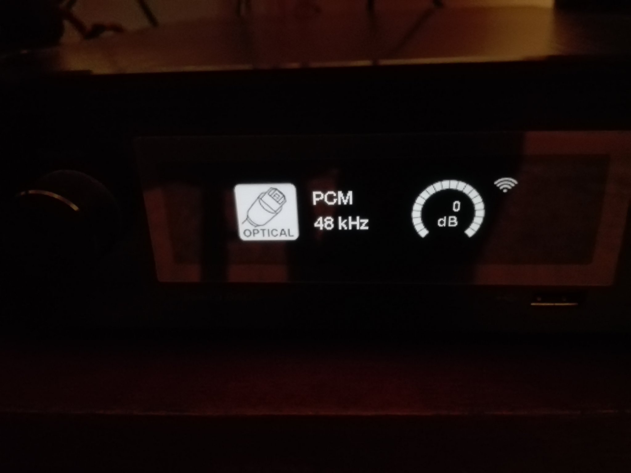

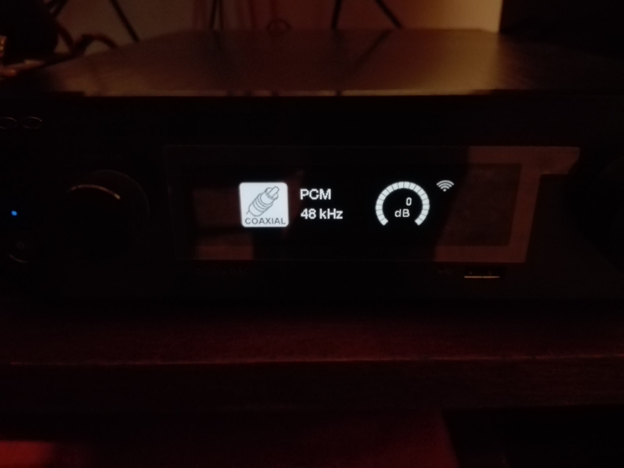

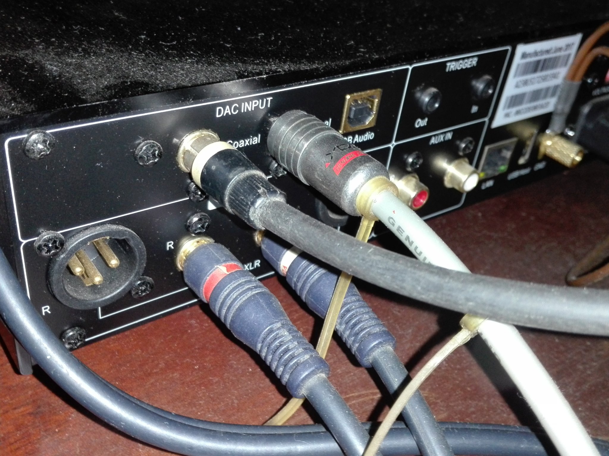

Once installed, switching the Oppo's input - with the remote control - between optical and coaxial, and being located in the optimal listening position, I tried to perceive any difference in the sound.
I could not identify any, to my ears, which are not a few years old but are highly trained in these matters.
I reiterate that the optical cable is generic, it came with an audio equipment, but now I have doubts if it was the Pioneer DVD or the Yamaha AVR receiver. I don't think it makes a difference, surely the interior is made of glass-like plastic.
Perhaps a pure glass one would make a difference against a coaxial cable of mediocre quality? I leave the question open, but for me, the conclusion is that in the audio frequency range (20 to 20 Khz) the two cables perfectly fulfill their function, and that the optical cable should be used if there is any type of electromagnetic interference when using the coax.
I am attaching photos, sorry for the accumulated dust, they are sectors of the furniture that I do not clean very often and only I am authorized to do so.

I have tried to play music stored on a pen drive with the Oppo, it did not recognize any files at all, so I gave up using that entry. I guess you think I'm too lazy, but it's not like that, only when the digital world exceeds me, I accept it and look for a good vinyl !
If you can't hear a difference between coax and optical, don't worry, be happy 🙂
