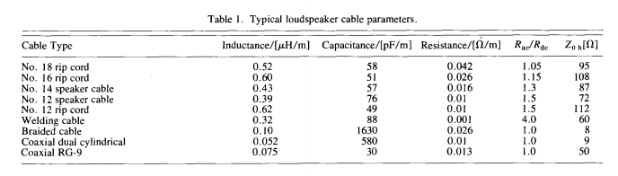

I built up a 1.2m length of star quad using 4 lengths of 1mm² stranded cord.
The capacitance after twisting was ~150pF/m
The 250mm length inside my amplifier has ~37pF of capacitance loading the amplifier output.
A 600mm length outside the amplifier adds ~89pF and then there is some from connections.

Arny said it early on, it's R that counts for speaker cables. Unless really whacked out, L and C don't make much difference in a speaker cable.
The specs I've seen on zip cord say about 17pF/foot
From Greiner's 1980 article:

The lumped values can be measured pretty easily with the appropriate instruments, but they are specialized devices. Probably more relevant would be to measure the composite system including the amp and a variety of speakers. A network analyzer would be the best tool. An HP3577a 3577A Network Analyzer [Obsolete] | Keysight (Agilent) or an Omicron Bode 100 https://www.omicron-lab.com/bode-100/product-description.html are good examples. You can see the change in amplitude and phase vs. frequency for different cables and no cable. Again you will need to remove the effects of the amp itself to the phase and gain but a modern instrument usually has provisions for doing that.
The remaining question is whether the changes are audible. These intruments are very sensitive. I believe that John Atkinson did measure some differences with different cables a long time ago that were at the accepted threshold of audibility. However he never went further with it.
