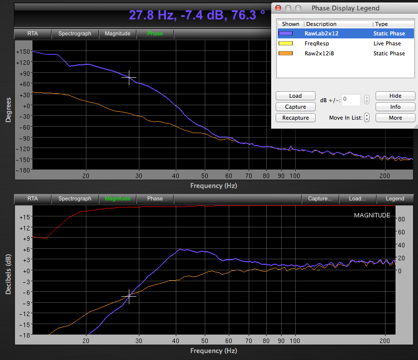

The most important place to line up the phase response of your subs/tops is in the crossover region.
Both ported or sealed subs will have the same phase response in the upper range, so the tops (or subs) will require the same delay for phase alignment.
Around and below Fb (the tuning frequency) the phase will rotate more on the ported subs, at and below FB it will be 90 degrees off, so can't be corrected without messing up the upper response.
In room, the 90 degree phase change between cabinets may or may not be terrible, but probably won't be good as far as combining ported with ported or sealed with sealed.
The screen shot below is a 2xLab 12 of about 151 liter with an FB of 36 compared to the same cabinet with the ports closed, measured outside at two meters.
