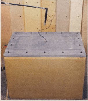

Here are some measurement from the excellent German magazine (what happened to the football team?)
The setup a wide band driver set in a box within a box
A front baffle is added and two things are measured. The sound througput through the board and secondly the vibrations of the board is measured with a contact microphone
Then a set of board are compared and with 19 mm MDF as the standard both for transmission and vibration levels

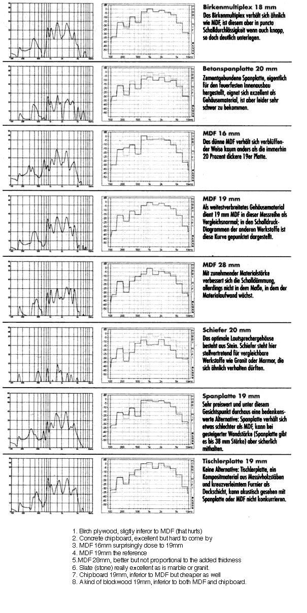

Picture 1 Findings
I. The 16 mm is very close to the 19 mm in both accounts even if thinner
II. "Concretchipboard" While hard to find superior to MDF
III. Beech plywood, slightly inferior to MDF

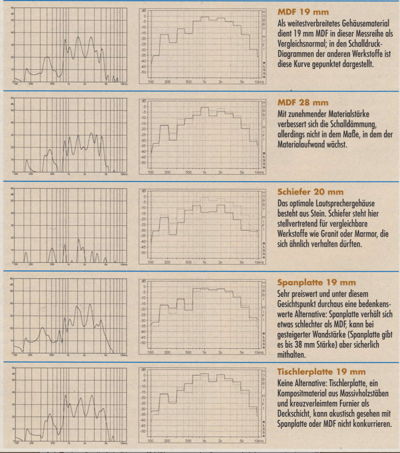

Picture 2
I.28 mm MDF better than 19 mm but not by so much as the increased thickness suggest
II. 20 mm Slate (stone) way better than anything else!
III. 19 mm Chipboard, while inferior to MDF it is cheaper so a given amount of investment gives a thicker board...
IV. Blockboard 19mm inferior to both MDF and chipbord

"box within a box"- does that mean a speaker inside a sealed box, or a speaker machannicaly decoupled from an outer box? I just want some better clarification ( the pictures don't show up well on my cheap phone) so I can understand the reasults a bit better. I prefer ply top, bottom and sides, with mdf front and back, but that's mostly from a practicality point of view.

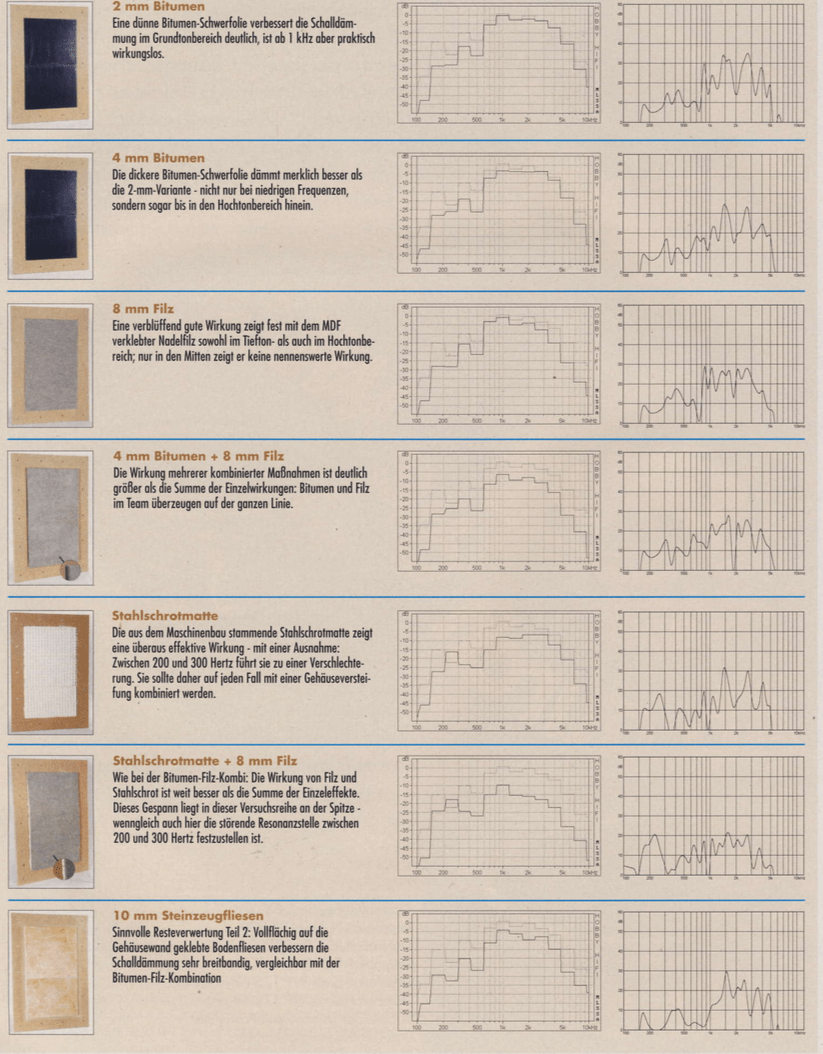

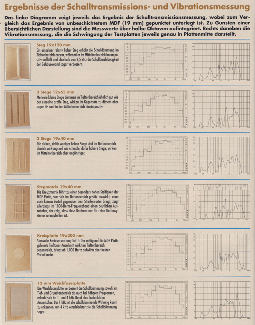

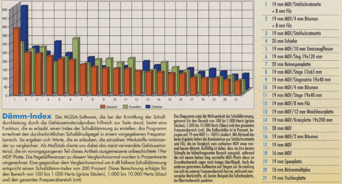

Here is an other set of measurement from Hobby HiFi. In the article they note the surprising effect of a humble layer of felt glued to the walls. (Just as Troels Gravesen does in his constructions). They also suggest that adding ceramic tiles to the walls adds both mass and damping. I recall a DIY article in the danish magazine High Fidelity with a 15" Tannoy in a large box with ceramic floor tiles covering the inside. The guy who built them needed several friend to help him move the speakers to the living room. One of them remarked that he did not need any theft insurance on the loudspeaker as nobody could move the damn things🙂
Now to the graph. Redish bar is average damping green is damping in 100-1000 Hz range and blue bars is 1-10 kHz.
The whole thing is normalized to 19mm MDF (100%) and then the constructions are in the order from best to worst average damping.
The take home messages are:
1. Damping and bracing is better than just thickness
2. Bracing is really good below 1 kHz but not above that
3. 4mmBitumen and felt glued on top of that is really good.
I hope the pictures are explanation enough and that translations are not needed.

It try to model how the panels behave in a loudspeaker box. A "model" imply a simplification or constrains. Instead of having a contact mic at one point it would be better to measure the whole surface with laser as well as calculate the polar response of the panel and so on.
If I was to do a Ph D in accoustics and I had a very big grant to spend, I would love to go bananas on the Klippel tools and have the time and brains to use them properly. This in close work with people working with psycoaccoustics or what ever it is called and spelled.
The finding suggest that for a bass box good bracing will bring the resonances above the working range of the bass driver. For the mid and high range a "limp" box with thin walls and a lot of damping material (as per Spendor BC1, Harwood BBC LS3/5A) seems better than a brute force box with very thick walls

You could i.m.o. move quite a way forward with measuring the entire surface with the contact mic at a matrix of closely spaced (e.g.1 cm) measuring points instead of just a single point "sort of in the middle". If I properly recall Earl Geddes long ago stated in another thread such panels tend to resonate in a rather chaotic way.
I am well aware of the BBC experiments, but that is now almost (or over) 50 years ago with rather crude measuring techniques.
I am sure KEF, JBL, B&W and others have measurements, but public ones are hard to find" There is a PDF "
"Akustisch „optimale“ Materialien für Lautsprechergehäuse "With findings similar to the one above, the tapped a suspended panel and measured and recorded the output (I think I have the mp3 files somewhere but at the moment I can not find them and I have work to do)

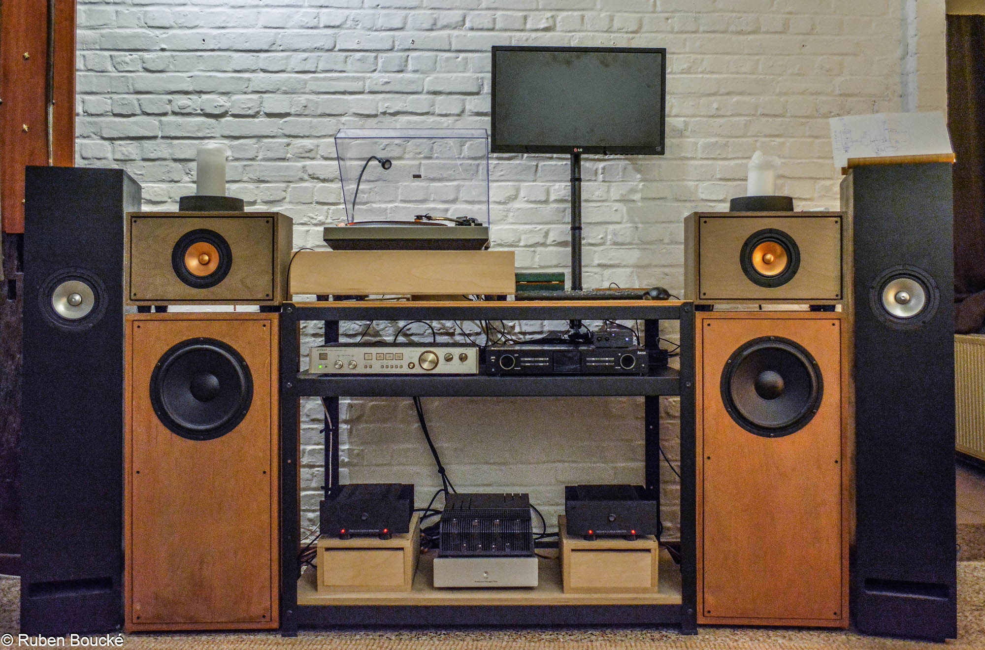

Yes, that works well, the woofer is a 10" in a stronly braced cabinet to bring the resonance higher than the passband, so the opposite of the top cabinet. The top was made in 12mm birch ply except the front and back plate and damped with bitumen. The woofer cabinet in 18mm birch ply. Like this the cabinet resonances are so reduced that they are even not felt anymore. This is a picture of it of a year ago. I build some more speakers so it's place is taken by a newer builds now. But it's still in use upstairs now, in my bedroom for the moment (but all move a lot here, a lot changed in that setup).
