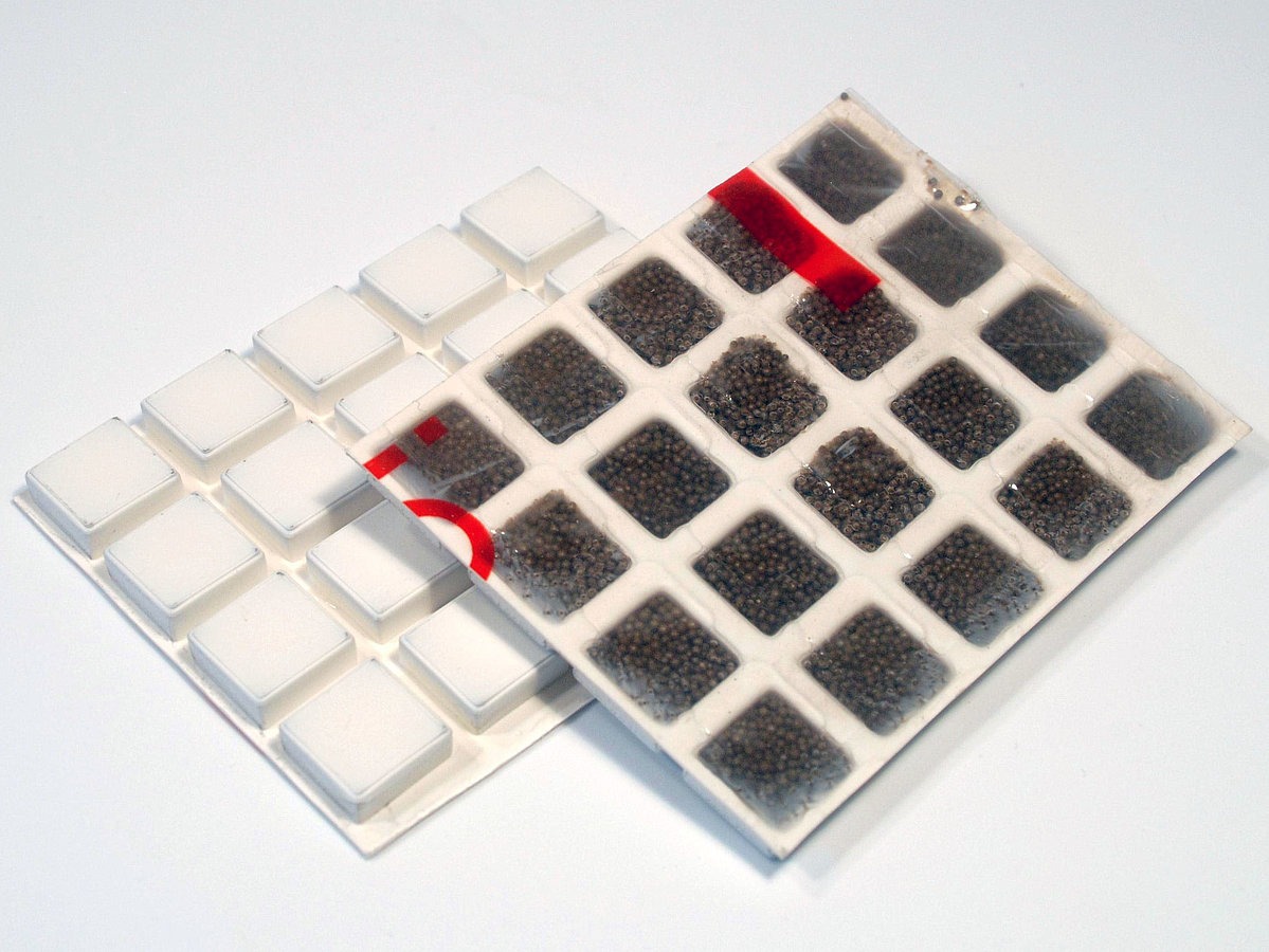

However anyone heard of Hawaphon?
It's like sand but easier to use
Here is the producer
https://www.korff.ch/produkte/hawaphon/
They designed it to dampen conference or directors doors so nobody can listen through the door

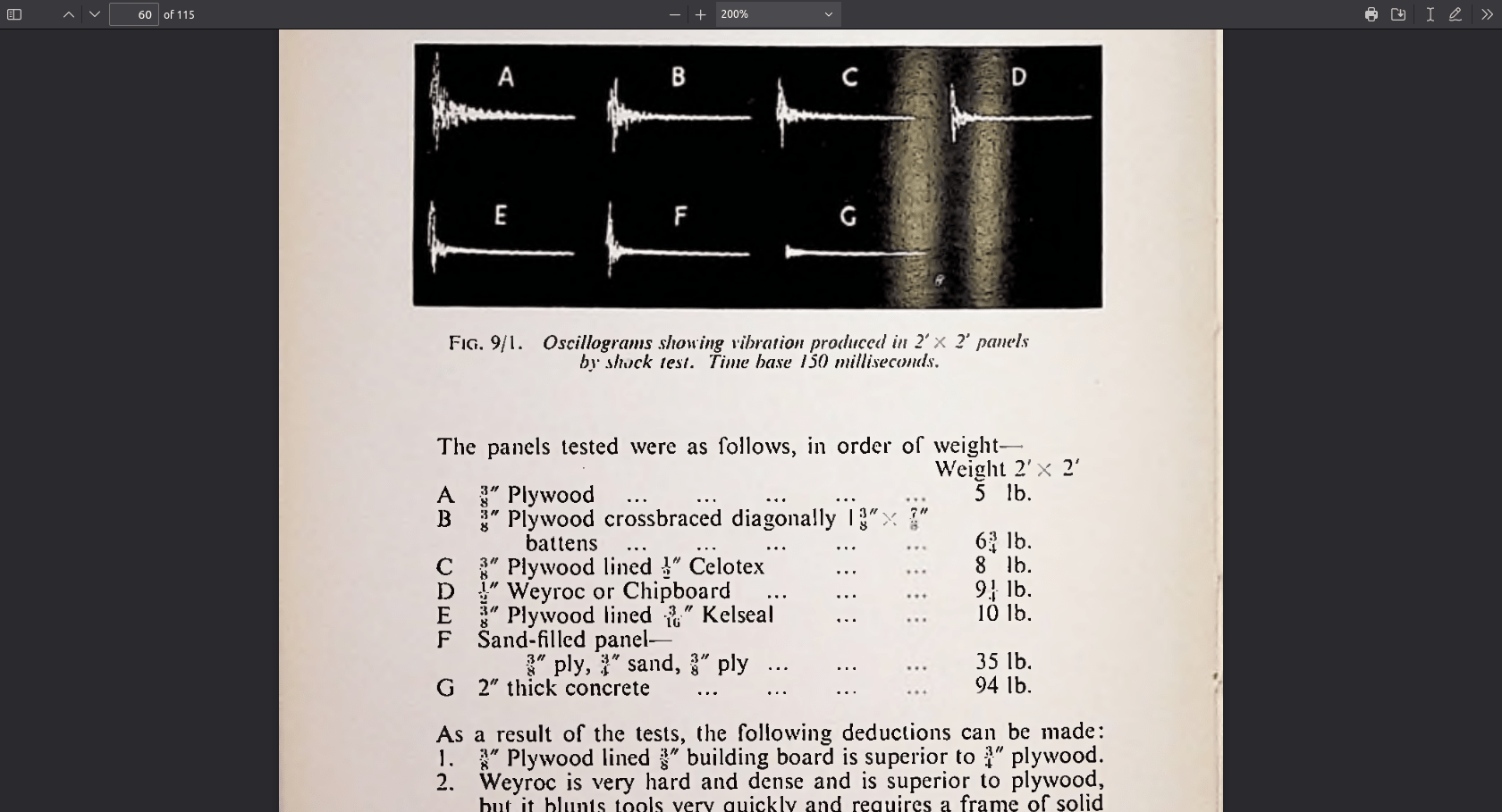

Here are some measurement from the excellent German magazine (what happened to the football team?)
The setup a wide band driver set in a box within a box
A front baffle is added and two things are measured. The sound througput through the board and secondly the vibrations of the board is measured with a contact microphone ...

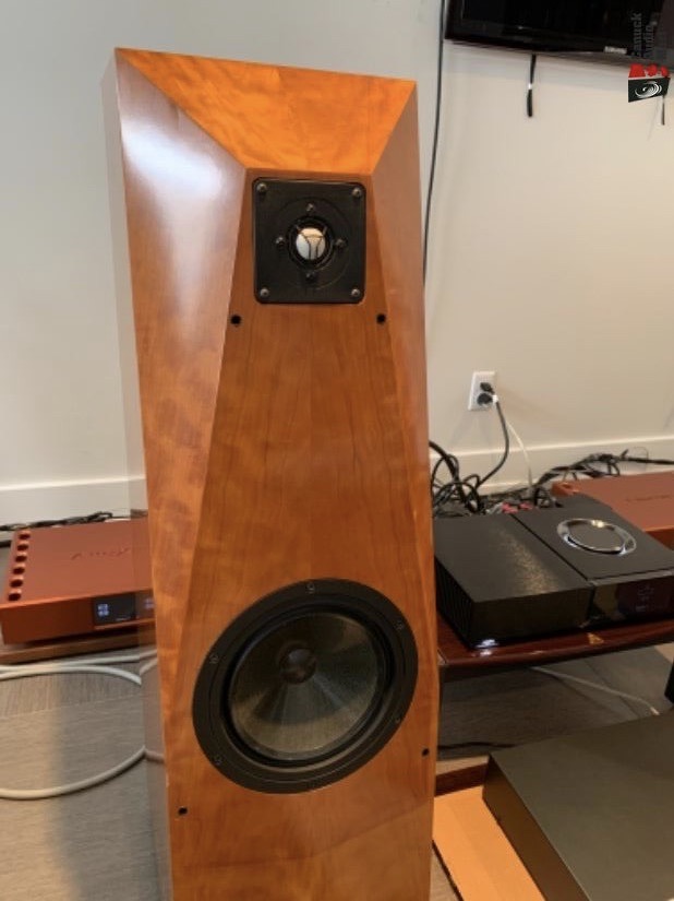

Just out of curiosity i have read that an Avalon Eclipse model has a 4.5" max thickness baffle I guess it's a Guinness record
Moreover i have read that the brand it's criticised for using MDF for cabinets
I think that the result is what counts
Sure. Although Avalon being Avalon, they're at least using MDF 'properly' (as in 'as well as realistic'). If memory serves, the thick front baffle is made up of 1/2in layers rather than 3/4in so you have more laminations and more boundary losses in there -arguably it may also be a bit stiffer, although that depends to a point on the adhesive etc. The rest of the box is, as I recall, made up of at least 1 1/8in panels, and heavily braced. The thick front baffle makes cutting the facates easier (assuming you have suitable tools -it can be done by hand but it's a swine for experienced woodworkers & completely beyond the likes of me), and gives the drivers a high mass, high rigidity 'sink' for their structural resonances, as well as a very inert platform for the expanding external wavefront / 'bubble'. It also gives the other panels, with the bracing, a similar high[ish] mass, high rigidity structure to key into. Strictly speaking it would probably be better if they used HDF / valchromat (I suspect their MDF isn't too far off HDF), panzerholtz, or preferably a quality void-free multiply e.g. Baltic birch, bamboo etc., especially at their kind of prices. But they're a business, and in fairness, if you're going to use MDF, they're one of the better examples of how to use it well.
With would make the baffle 9-ply MDF plywood. One of the prime reasons for such a thick baffle is that is gives tham room for the big chamfers they use.
The 5-layer (dirt cheap MDF) plywood in the curved PE boxes was also better than straight MDF. I suspect that Avalon starts with a higher quality MDF.
They could probably get teh same stiffnes sout of 3” quality ply, but there would not be enuff room for the big chamfers

i think that the cuttings are superflous i think it is done more for look
It does make them look more dramatic but the big chamfers do a lot to decrease the loudspeaker’s diffraction signature which i would think is the prime reason. Cosmetics are a bonus.
i cannot help but notice that in the more recent models they have also added felts around the upper drivers Maybe to increase the edges diffractions control ? the chamfers are still there But if great speakers can be done even without these difficult to make chamfers for me they have no reason to exist look aside of course But i like listen in the darkness Look is not important to me at all

The Avalon that most distrubs me is the one with the tweeter at teh tp and the woofer at the bottom. How do they get them to blend given the huge C-C.
dave
maybe the listening distance comes into play ? maybe at 10 feet and more the emissions of the two drivers will blend ?
Huge reduction in diffraction signature (partly after Olson). Personally I prefer the slightly less outre Vimberg configuration, but in fairness to Avalon, it does work.
They were crossing at 1KHz, LR4 acoustical & electrical with the old Eclipse, full impedance compensation for that MB Quart tweeter. A bit ambitious for that unit TBH, as it was starting to struggle, but some more recent tweeters can do it better assuming we're talking modest spaces & SPLs rather than 'ballroom & live Motorhead'. 😉 Spacing is within 1 wavelength so integration is reasonable; not as good as 1/4 wavelength, but there aren't a whole lot of speakers that can do that, & a lot better than most despite the large spacing, so they could get away with it. Predominantly it was about reduction of baffle diffraction for the individual units & to a lesser extent floor-bounce and the ability to use symmetrical electrical orders in the filter.
