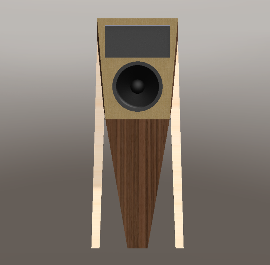

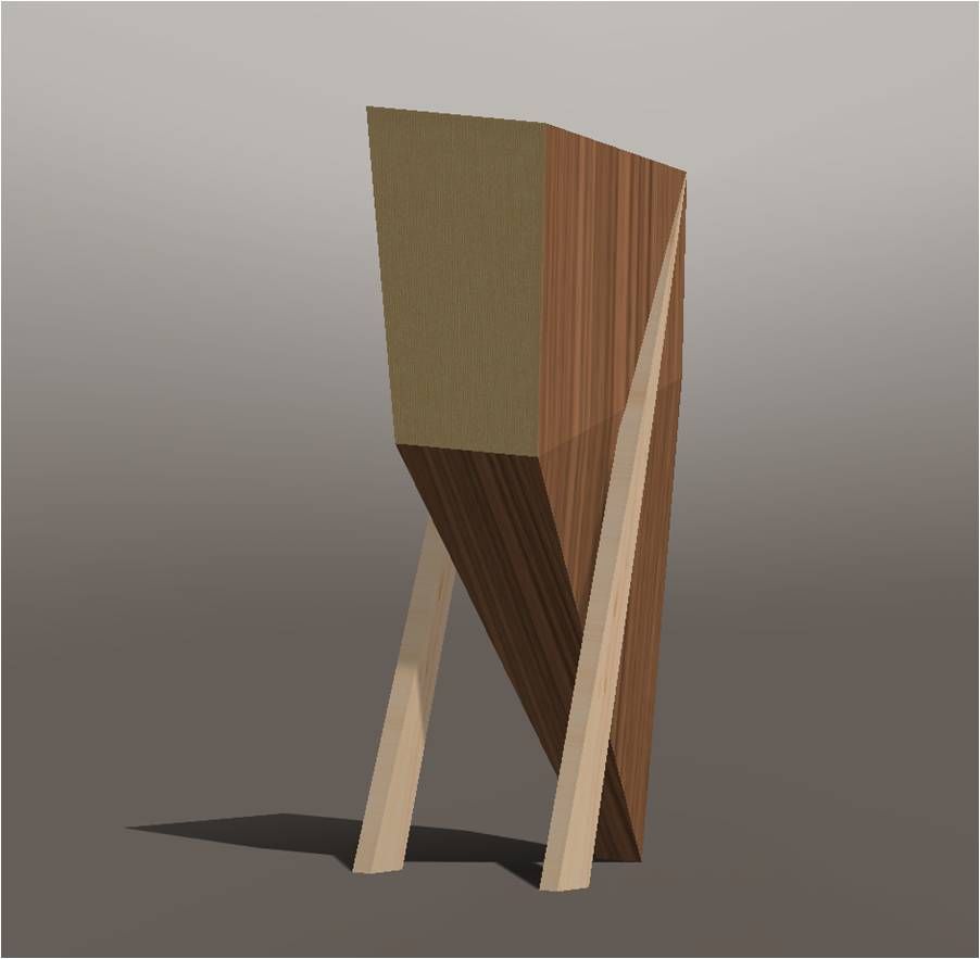

I chose a 65L cabinet volume. Port tuning is around 35hz I believe. Wife was on the PC til late so no pretty cad or winisd plots til tomorrow.
first stab
They're OK. I still think the proportions are off a bit. Needs some more tweaking, and maybe a curve or 2 to break up all those angles. Maybe a little too drastic design for my room too. Might tone it down a notch. Will see where it takes me.

I do really like the Davone speakers. Very elegant design with the bent ply. I think my design is still too top heavy. I may reduce the bottom front slope and add a slope on the top backside to reduce some heft on the top. Again, its the problem with that horn shape in that it forces the top width. I may need to embrace the width rather than fight it. Still much tinkering to do, but that's all fun stuff.

That top wide horn does throw up some aesthetic problems.
Ive looked at a lot of speakers, and your eye is always naturally draw to the top driver.
I'd be inclined to try it the other way around with a large base and getting narrower towards the top, and have the horn in its own box with a spiked seperation, would end up looking rather like the old style pics above...
