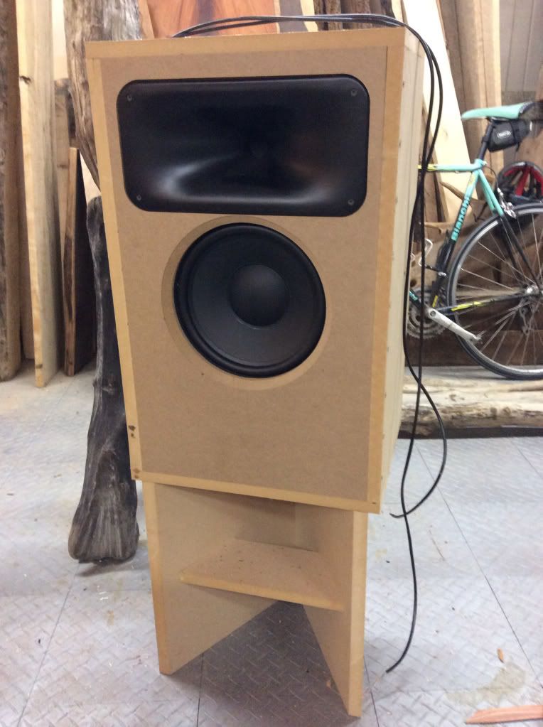

I'm running a test box similar to what you are looking at. Pairing the 10" beyma with a DNA compression driver and the seos 12 horn. I'm currently in tweak mode with my minidsp setup. So far so good. My goal is to make a small, good efficiency, wide range floor stander and the beymas range with the comp driver looks like a good idea.

I'm still working out the XO. My shop test enviro is not ideal and I'm tuning my test setup as well as the xo. 2 10s would work well with the comp driver. I had to dial down the comp driver to play with the single 10. The sound of the beymas is great. Great detail and they reach down low in the ported cab. The comp drivers need some taming. Will update as I go.
OK so I finished up tuning my test cabs last week. Couple learnings from this exercise that are relevant to your thread:
Keep the Beyma's XO as low as possible. I started the XO at 1500 and it was too high. I dropped it down to LR4's at 900 (pushing the lower limits of the compression driver) and the sound improved dramatically.
Midbass/Low end on these sounds great. Reaches down into 30 Hz in my room. No sub needed.
These can play LOUD w/o breaking up the midrange.

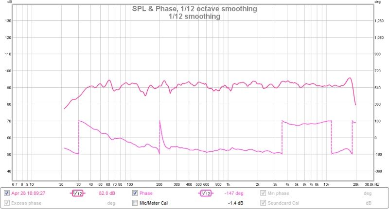

I did a ported cabinet that i had modeled on winISP based on volumes that I could work with. I still want to plug the port and run some FR curves and listening tests to see what happens. I'll give you some more details when i get home this eve.
Up to you if you want to run more than 1 driver/side. If you are concerned about bass extension, 1 should be plenty unless you have a really big room. If you are looking to reduce distortion in the midrange at higher volumes, 2 would be better, but I haven't heard much distortion at ear ringing volumes with 1 thus far.
Also, try to keep that XO as low as you can for the beyma. <1k sounds good to me. If your compression driver can't do it, might go 3 way...but then that sort of defeats the purpose. I'll post more info tonite when i get home.
