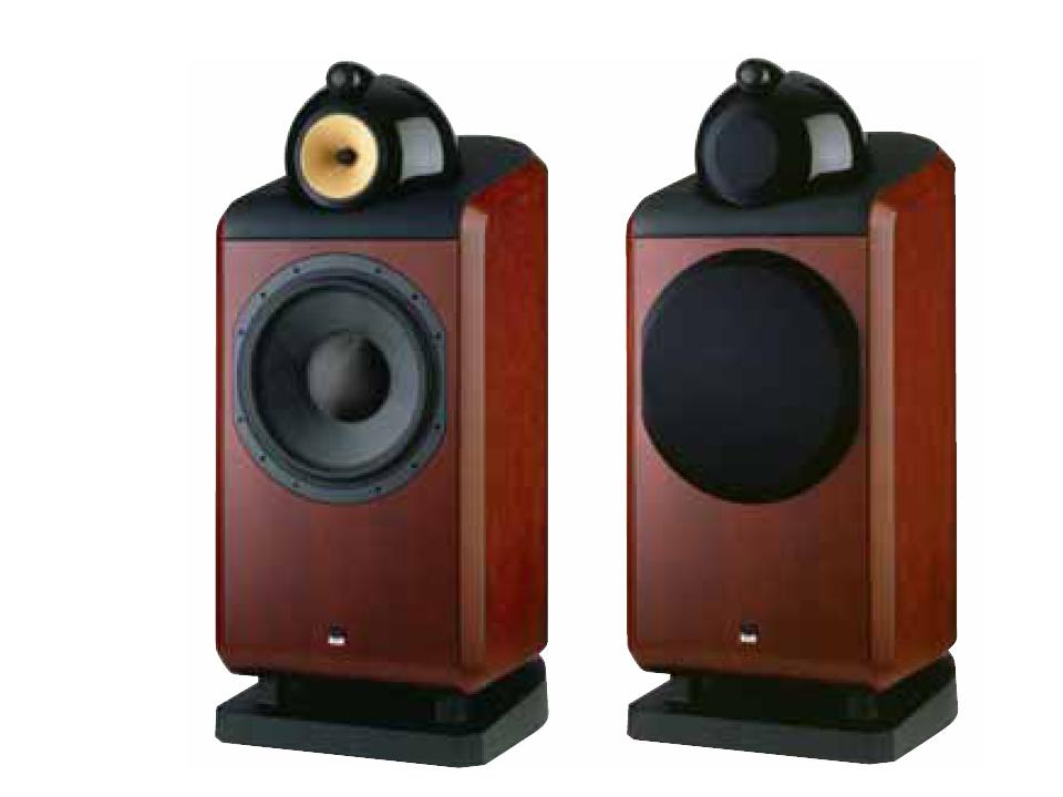

This is the idea, but with two woofers, and the curved back protruding up like the B&W

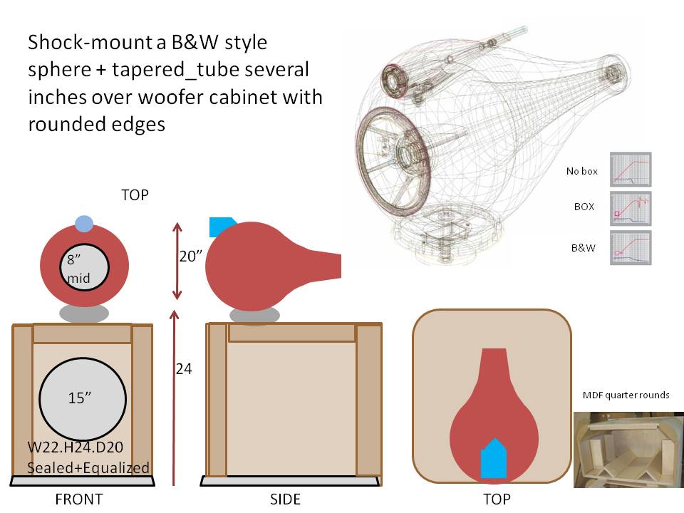

The first B&W Nautilus 801 speaker used a single 15" woofer because the company engineers found that a single large woofer sounds better than a couple of small woofers.(below). The best selling and most advertised B&W Nautilus uses two 10" woofers because the design performs well and looks sexy.
YOU ALREADY KNOW THAT:
---A single 15" woofer in a sealed cabinet with electronic Xover and room equalization will sound best. (+ Geddes Swarm)
---A sexy package would use two 10" woofers in a sealed cabinet with electronic Xover and room equalization.
---A sexy generic single-amp speaker would use two 10" woofers in a ported cabinet with passive Xover, plus a couple attenuation twist knobs.
---A three way speaker is required to approach 20-20Khz orgasmic sound. Ya need a tweeter... like B&W, Epison, etc... like SB29RDCN

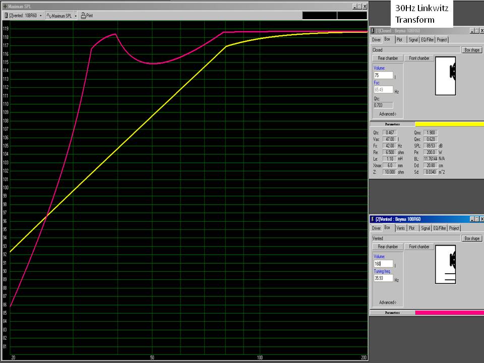

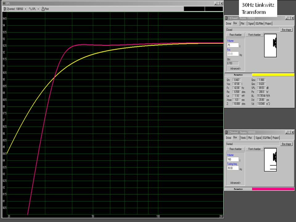

There are datasheets for Beyma 10BR60(fs=42Hz) and 10BR60V2(fs=31Hz). The 6 to 6.5mm Xmax will set the deep bass limit, especially with a small volume sealed box compared to a much larger ported box. Even with Xmax=6mm, putting two 10BR60 into a 75 liter sealed box with a 30Hz Linkwitz transform will produce near 100db SPL down to 30Hz, even before room gain. Putting two 10BR60 into a much larger 160 liter ported box allows much higher max SPLs until the normal port drop near resonance to 106 db max SPLs near 30Hz. Adding a 15" woofer at a later date might deliver good value in improving bass room modes, in addition to some basic deep bass extension.
75 liter(2.65 ft3) sealed vs. 160 liter (5.64 f3) ported is a large difference in room appearance.
