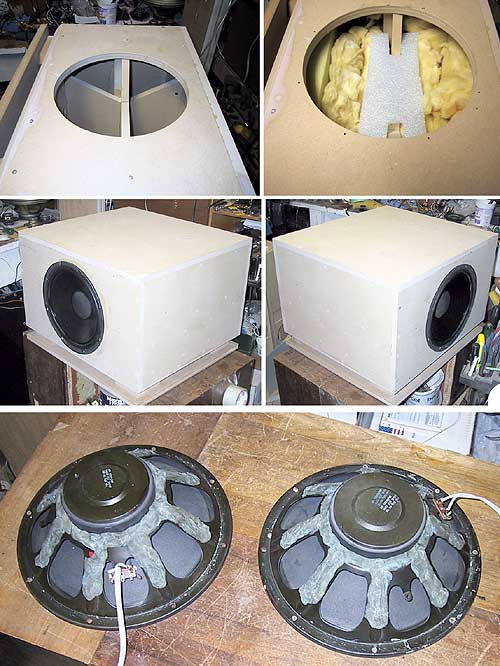

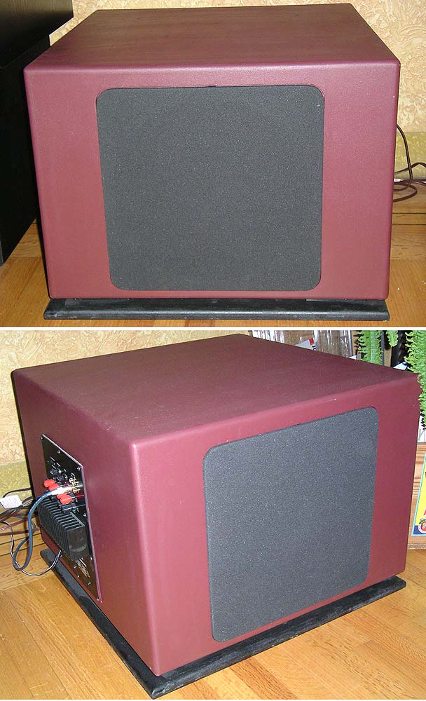

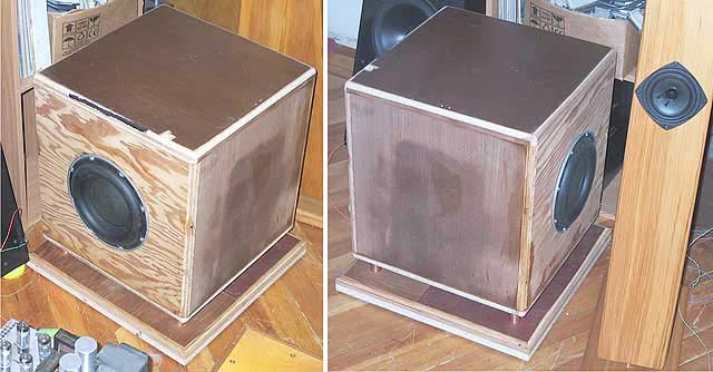

Sub is finished, 75l ported, tuned to 20Hz and it's just flippin awesome, better than I could have imagined.
and
95.4 ltr enclosure tuned around 21hz which provides a -3db of 18hz!
http://www.diyaudio.com/forums/showthread.php?postid=1184559#post1184559
there is a picture one one of the guys boxes on there.
