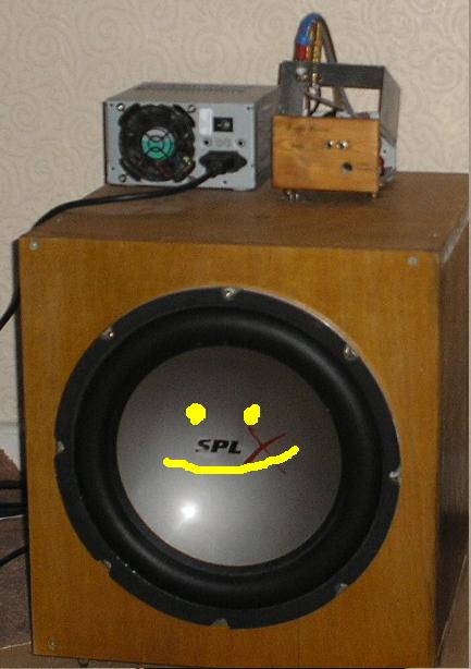

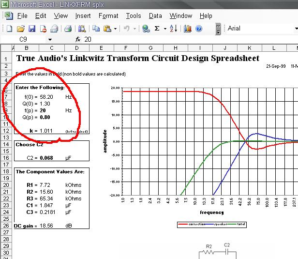

Glad to help, although others here will help you more. I'm still learning myself. Lots to be learnt, I just built a Sealed box and its a Linkwitz Transform jobby. This makes for a small sub, and the Linkwitz Transform is an e.q. that allows the driver some serious bass for a small box, I'm using a cheap 12"car driver from SPLX and its tuned for 20hz. I had a lot of help from richie00boy on here, (Readresearch), he helped me measure the drivers T/S parameters and then I sized my box and tuned everything up. I haven't got an amplifier capable of some power, so I'm using a car amplifier and powering it off a PC powersupply.
Cheers Mike
Cheers Mike
mikee55: Looks good. Is that a computer power supply for the car amp? That have enough "umph" for the job?
In this thread, Oops
Before I get shot down, this is by no means woodwork. Its a bloody mess, at the end of the day I needed a sealed box of volume. Besides I didn't make it, I was given it. Its the correct size and its airtight. I'm still learning with it.
Cheers Mike
Cheers Mike
It is...
...230watts, gives 7 amps if I remember right. The protection light comes on and I get a squeak come from the woofer, apparently its underpowered. If you sit in the same room, (5m x 4m x 2m) it booms round the room, travel round the house and you can get a sense that its reaching low. I've had a pair of Goodmans Magnum K2 which have 12" woofers and they didn't do much physical, yes they had a good bass, but not like this. Go upstairs above the room and the floorboards are going for it.
Its mad, can't wait to get myself a serious amp😀

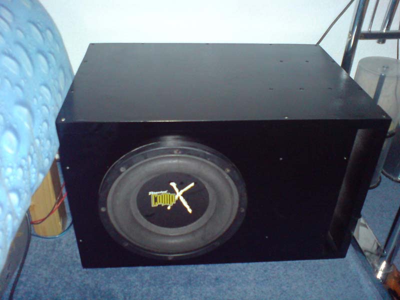

it is nice to know im not the only one to be using car subs.
right now im using a direct x sub
300rms i made a slot port as well like a car tuned to 30 hurts
18mm mdf.... only thing i think i should have done is brace (never done) new to diy) as on lower end films like the heart beat on Pirates of the C 2 the box tends to vibrate alot . music and most film it does sound really good
i use a BK 500rms plate amp.. had been down the line of psu and car amp but it far cheaper for me and more power to just get the plate amp 🙂 as UK car amps are probable more money
i also have 2 JL 10w6v1 what silly really as i like ported and found out there not the best for that hehe
was thinking about tuning and making box for that as well but unless i go slot port using a forums site where it gives u details of each bit wood u need and how goes together.
also will proble just go down the line of the bk monolith sub and then get help for the box
i just enjoy trying to design and all that bits even though i still have lots to learn

i used a car forums site that just made slot port only
it is very simple to use.
just choose the size of the speaker (10inch) and fill in its details
then choose what hz u want e.g 30 and then u can adjust the width
and height.
then other bits u can play around with like the size u want
it shows you what it looks like and gives all the details of sizes or wood and how it would look
shame it does not do the same for pipe vent ..
Net Volume: 1.3 cubic feet
Tuning Frequency: 30 Hz
Port Width: 1.5 inches
Port Area: 18 Square Inches
Port Length: 38 inches
what i went with.
another time would need to brace i think and dunno for home audio if round pipe type ports are better
