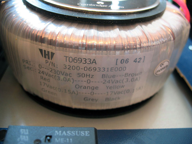

Here is the photo of transformer in my 340 (non SE):
Do You think it's fake specs?
P.s. Can I upload more than 1 photo with 1 post?

Here it is:I can't see your transformer in either photo

Here it is:
Cool, so that's about 150VA then is it?? Not very big....
