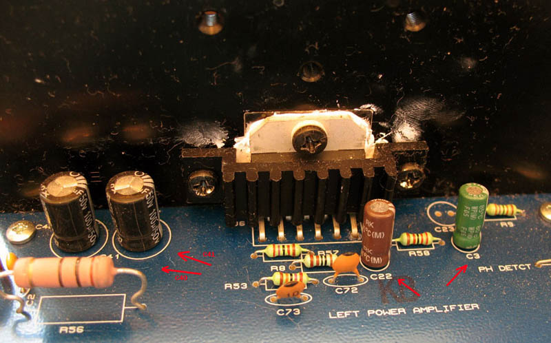

Your suggestion of all those bypassing caps could be interesting - I think CarlosFM (I wonder why the guy's now banned btw) did such a thing for an amp. Bear in mind that people who listen to these things have often found one cap or multiples of the same can sound better than various caps. Something big and nice like a 15000uF Mundorf M-Lytic with snubber might get a decent result for not much money or work.
I've just had another look at the schematic on page one and I would look at doing the following:
* replace C3 with a wire link (or bypass the whole trace with good wire)
* replace L1 & R48 with a wire link (it doesn't do anything you need)
* bypass C22, again it's not needed
* change C40 & C41 for Rubycon ZA ~100uF and, if possible, mount on chips' pins
* change R57, R53 & R82 for Kiwame 2W resistors or whichever type you favour
I like Kiwame because they're cheap, green and have a benign sonic signature (if any). They're actually industrial types that someone discovered sound good!

Another look at the pics and I see a few things that strike me as less than ideal:
* loads of fuses
* varistors/MOVs at the power input
* why is the PCB so bleedin' huge?!
* volume pot might not be great
* transformer too small for 2 channels
* tx shared between power & preamp
I notice there's been talk of the transformer size. It looks like it's about 120-200VA to me. Will the case accommodate a taller one?
Could you slip in a new, small tx for the preamp? Something like a 30VA toroid will work nicely for the money.

I could squeeze it all in with the existing PCB but sombody voiced a consideration on the Cambridge PCB's ability to carry current to the chips? I said I could wire the new PSU direct to the chip with appropriate wire but noboby has told me if this is a good idea or not. We need Brent's opinion! Hes hardcore.

C3 and C22 block DC. Wouldn't it be better to replace C3 with a good quality film cap and retain C22? Reduce the chance of burning speakers with amplified DC.
Toss out the Thiele network? This is a proposed sonic improvement?
Sorry Mike, I forgot to mention - if you bypass C3 you'll need to measure DC on the output (speaker terminals) to see if there's a risk of wasting woofer excursion due to DC. You don't even want a volt really!
Alternative that is safe and really good - Mundorf MKP!
Which is the Thiele network, the output inductor & resistor? I thought these were purely to prevent oscillation in bizarre (capacitive) speaker loads and they're in the signal path... reducing damping.
Simon
Simon
The load the amp will drive is a variable. You can connect other speakers, after all. Stability can be compromised by removing the output inductor/resistor.
If you can actually hear the effects of this in the "signal path" you're up on most. I know I can't.
DC offset should be a few millivolts, certainly I'd be concerned if it was as much as a full volt.
