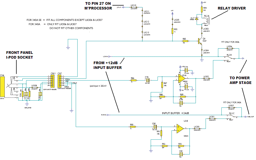

Im thinking about re-jigging this for the CDP input so while using the CDP the signal isnt passing the selector ic. The realy would be activated by the 'direct' switch. Do you get the idea? It seems easily do-able and the relay is close to the rear panel so the signal path wont be extended considerably. I need that manual though so I can see whats going on.
Now that sounds like a worthwhile project Mike! I'd go for it, and it sounds like you are.
-Chris
Hi Chris.
The circuit is as I suspected.
When a plug is inserted into the i-Pod socket the relay activates, switching out the selector ic and +12 gain buffer and switching in the +24 gain buffer.
Therfore, it can be used for the CDP input thus removing the selector ic from the signal path while listening to CD! (I might invest in a new relay with gold or silver contacts). I dont know if it will require a latching push button switch or not. Ideally Id like to rig it so the existing (non-latching) CDP button (and LED) still works. Is it just a pulse that open and closes the relay?

i-Pod buffer and relay circuit:
Hi Mike,
A normal sealed, gas filled telecommunications relay would be what you want here, coil voltages are commonly 6, 12 and 24 VDC. You may find 5 and 9 volt coils also.
Yes, not unless you want to build a circuit. Most relays require the normally open contacts to have the coil constantly energized. You can get pulse type relays, but those are more expensive.
The same question as above. On normal relays, the coil needs to be constantly energized to close the normally open contacts.
-Chris

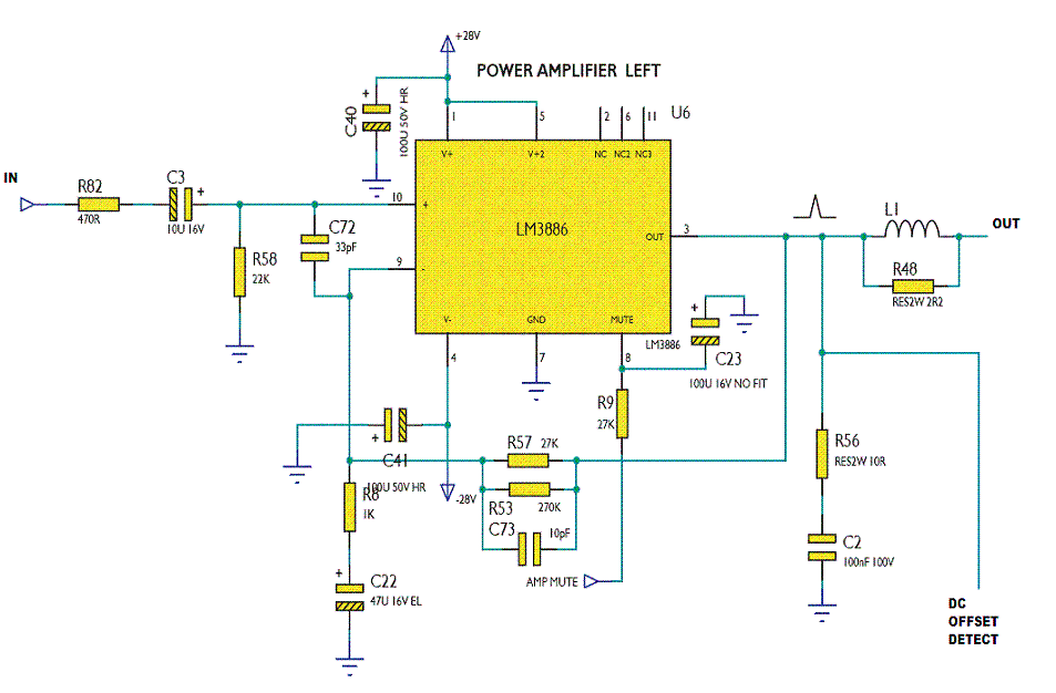

C72 is the input RF filter. It's a bit small, could it be 330pF?
C73 is a compensation for the HF response of the chipamp.
C3 is too big relative to C22. If a smaller DC blocking cap is fitted to the source then the two caps operate in series to give a lower effective value.
Increase C22 to 150uF if you can squeeze it in.
If there is no DC blocking in the source then reduce C3 to 4.4uF or 4.7uF.
If there is DC blocking in both source and poweramp then you can add a bypass to the power amp (labelled DC input), tapping into the top of R58. But add a series resistor, ~1k0 to make the RF filter work.
Its tempting to whip out all the 'extra' components and go for a minimalist set up employed by many chipamp builders. However, with this being an integrated there is likely much more filtering needed to reduce noise etc.
Those 2 ceramics are in the signal path so they are potential victims for replacement with silver mica or polystyrene. If the value is low (as Andrew suggests) it can be replaced for a higher value. The BOM in the manual also reads 33pF. Theres always the cance the amp could sound better without them....
Another feature not shown in the 340A sevice manual is that there are also small ceramics at the speaker outputs (labeled EMC supression). 1nF from SPKR ground to mains ground. Any idea what these are for and if changing to mica or pplyprop (for example) might sound better?
Hi Andrew.
Im confused about this feedback cap. On another forum I was advised that using a 22uF wima MKS2-XL would be great in the feedback and that I wouldnt get any audible decrease in bass as the low cut off would be below what most speakers can produce anyway. But you advise to increase it considerably? I dont get it. I know you mentioned earlier that the low bass allthough not audible can give a more natural sound? How is this the case if it cant be heard anyway? Im not being argumentive, Im just a little confused by the conflicting data.
The National Semi datasheet suggests a 22uF in this position with 1K0 resistor.
National Semi LM3886 suggested set up.

If you up the supply voltage it will go louder into 8ohms but will be a problem for 4ohms. There's a graph that illustrates this somewhere - have a good look on the LM3886 datasheet, it's probably there. I think 20VAC secondaries are about right for 4 ohm speakers.
