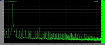

Hi Joshua,
This is the (quick and dirty) breadboard measuring of C3g (C3g triode connected, B+: 400V, 18mA CCS anode load, 235R and 100uF in the cathode).
Input: Viktors 1kHz generator (0.0004% THD), inverse RIAA -40dB output, output level: 30mV RMS.
Measuring set: 100kOhm attenuator, EMU0404 USB, Visual Analyser, laptop.
As you can see, 50 and 100Hz harmonics are dominant below -90dB (no shielding).
C3g THD: 0.0186%
C3g harmonics: -75dB, -90dB, other no detectable (too much noise).
C3g THD: 0.0186%
euro21, interesting but for the relevance it would be interesting with a comparement with another tube, for example D3A in the same setup. Otherwise its hard to know what devise in the test setup that gives what result. Is that possible?
At 30mV output, you're probably measuring the distortion of the source. Take a look at the distortion spectrum of His Master's Noise, which uses a D3a at the input.
Again, in a phono stage, the distortion will be limited by the second stage, not the first, unless there's a severe design mistake.
