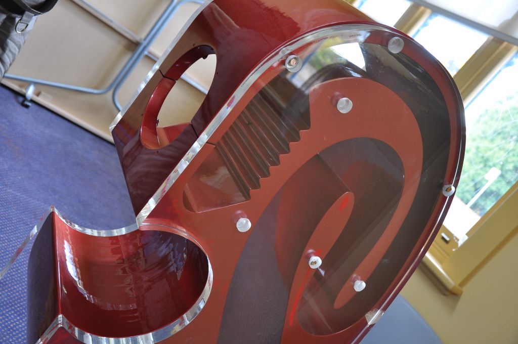

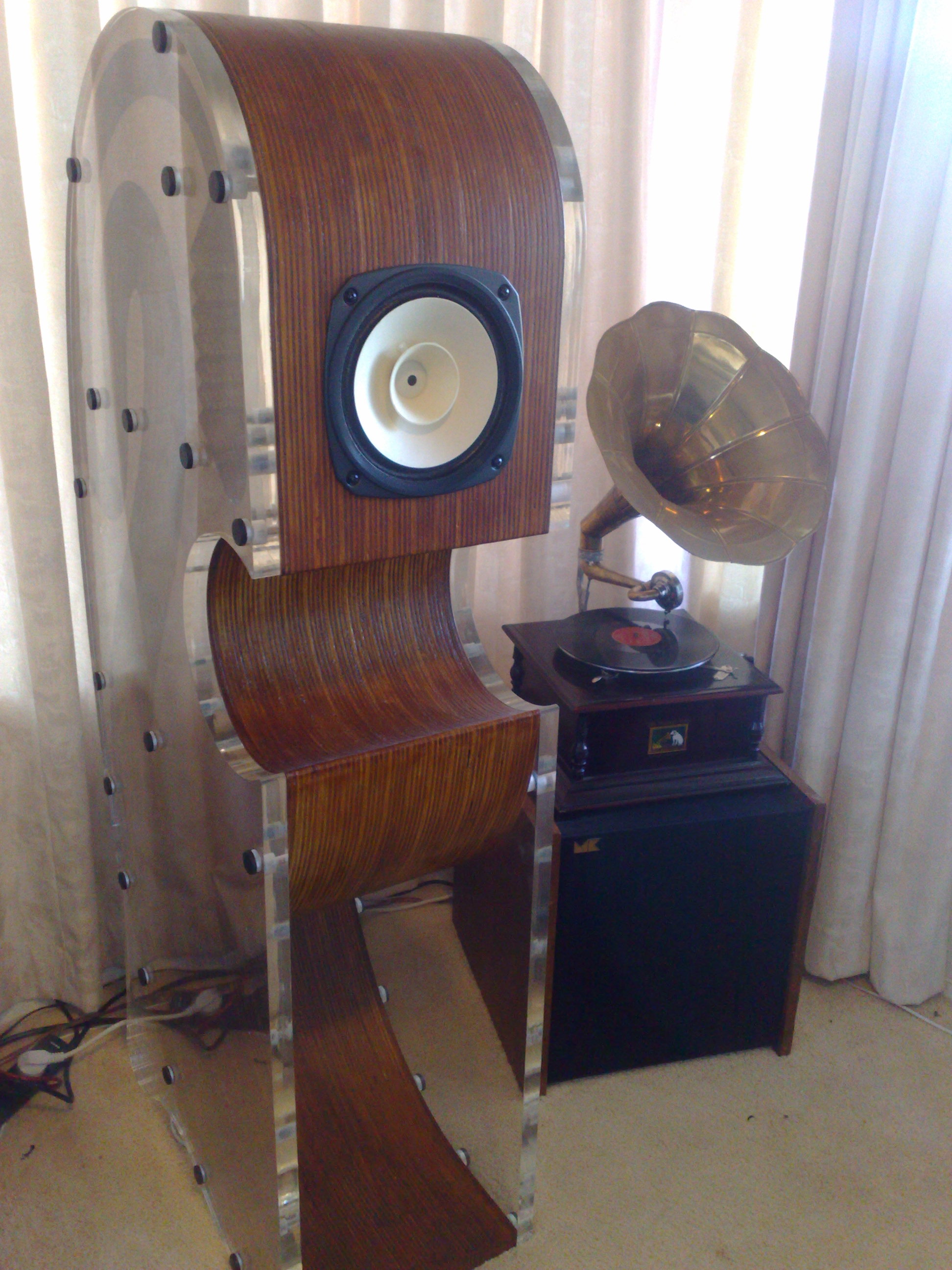

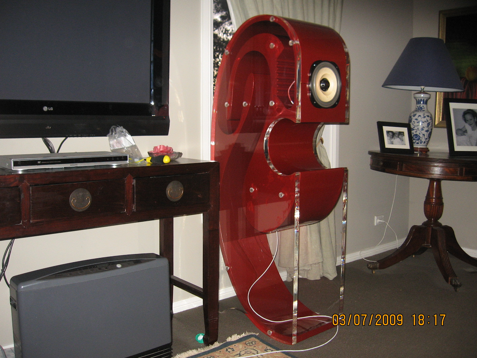

We machine Plexiglas with conventional mills all the time. I'd like to try the lazer. What kind of finished edge do you end up with.
as acrylic will cut via laser cutting machine, edges will be very sharp and elegant, so I'll use polishing machine... I'll use micro-fiber cloth polishing 😀 the final result will be a very nice-looking and clear and soft edge which seems like the surface of the acrylic 🙄
one easy way for polishing plexi edges is with a torch but can't recall the gas used (the flame temperature is important)!
haven't done it my self so if someone tries it please do it on a small scrap piece cause i am not sure if it leaves it crystal clear!
The shape below the driver is cosmetic, hence the C-horn name.
25mm (either German or Chinese) is expensive...I provision $500/side.

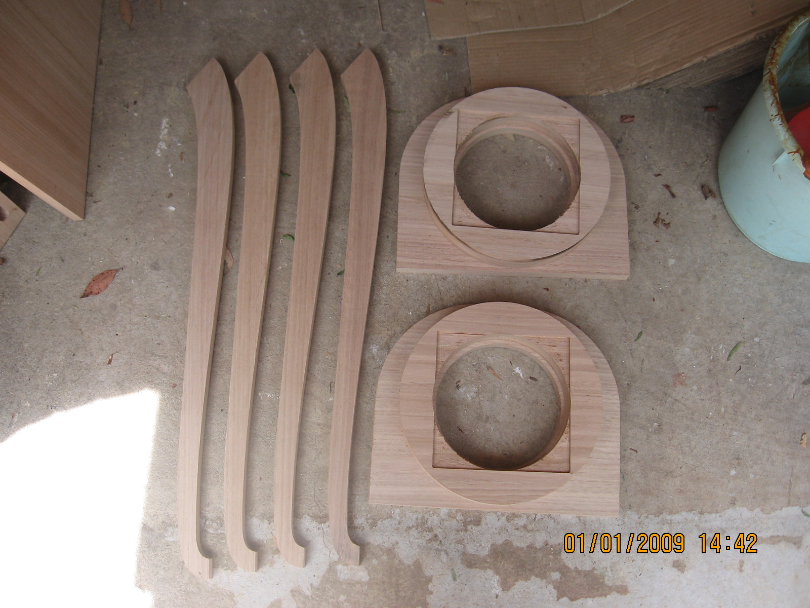

Cnc used for plexi...my cad file is modded for the acrylic shape, but holes align perfectly where the dowels fit...allows extra strength.
Edges are blow torched....not a DIY task...!

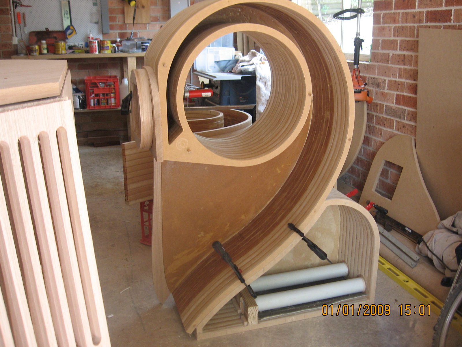

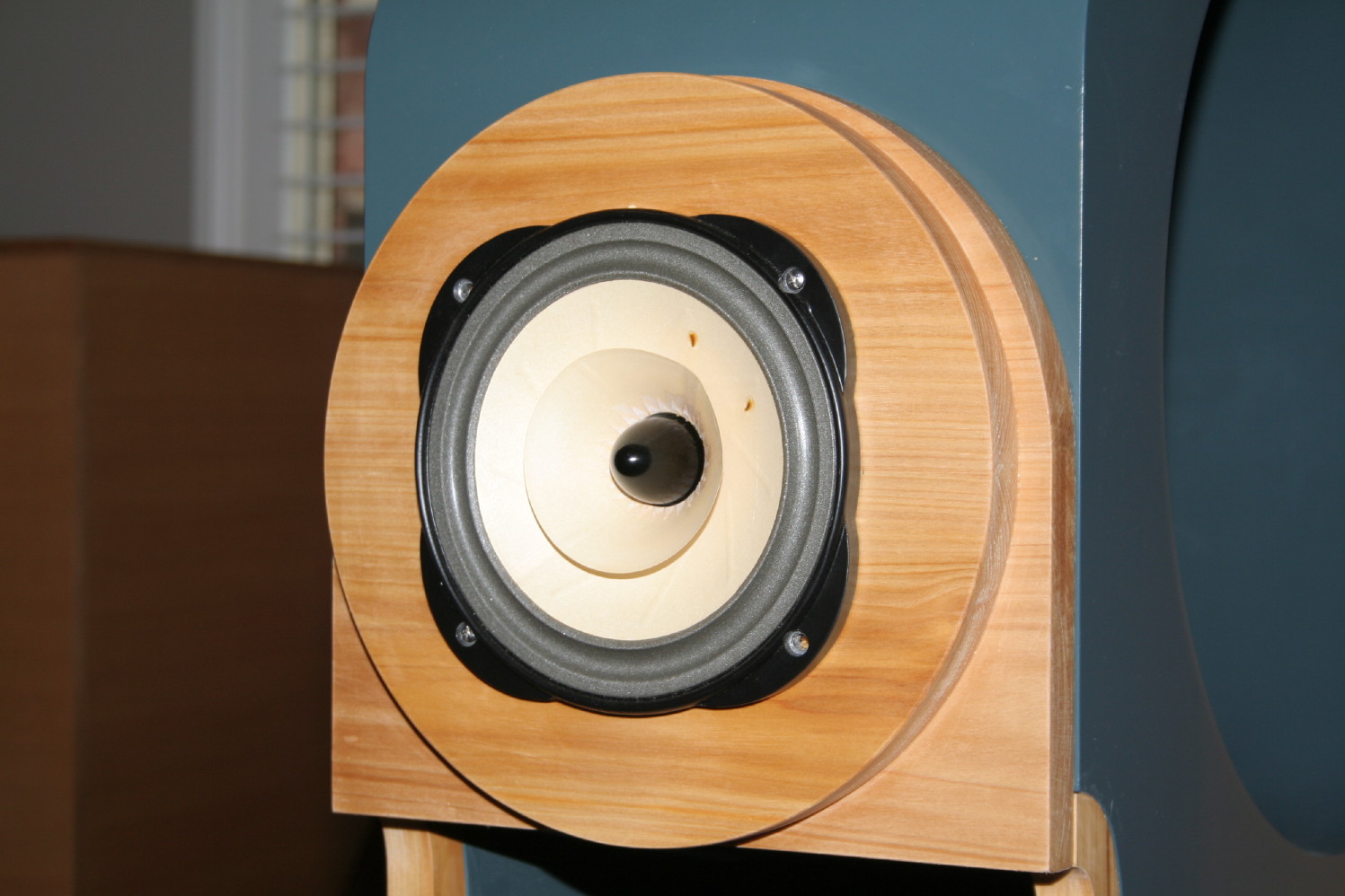

I've had lowther dx3, 206e's, and visaton b200's in the c-horn...all good.

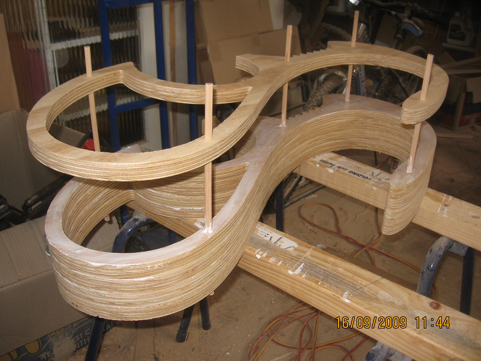

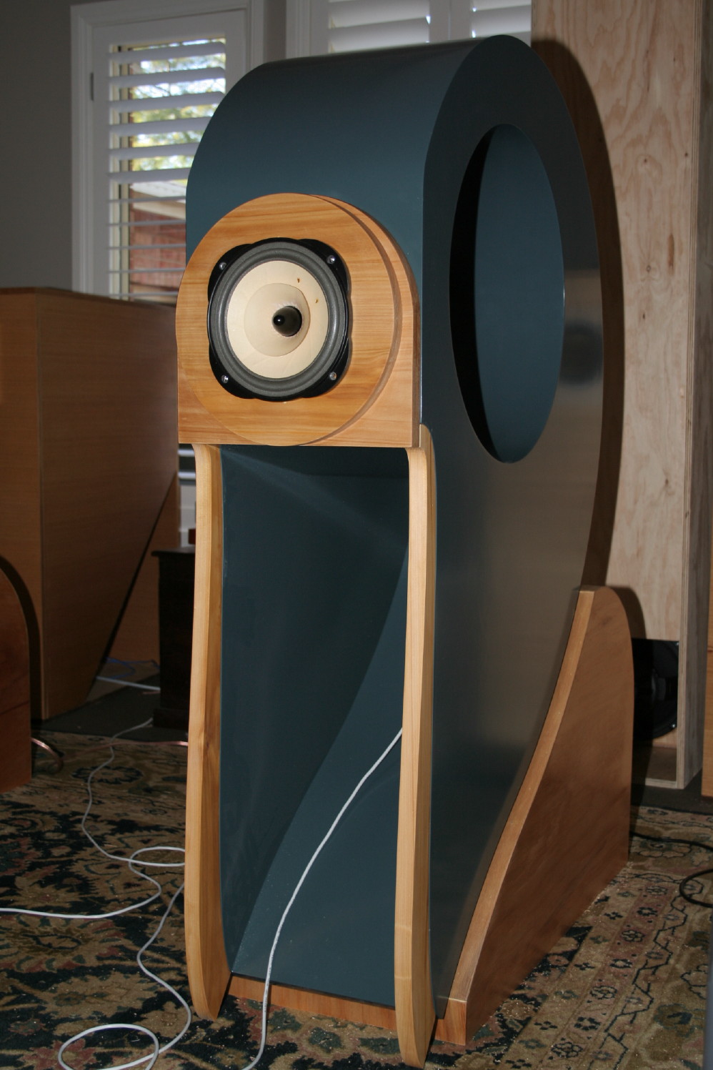

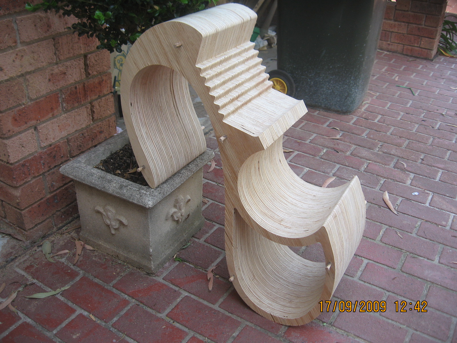

A mate just built the unit using birch ply...looks stunning with all the end grain showing.
I can't talk about providing/selling cad plans and cnc cutting files in the public, as this site is non commercial.

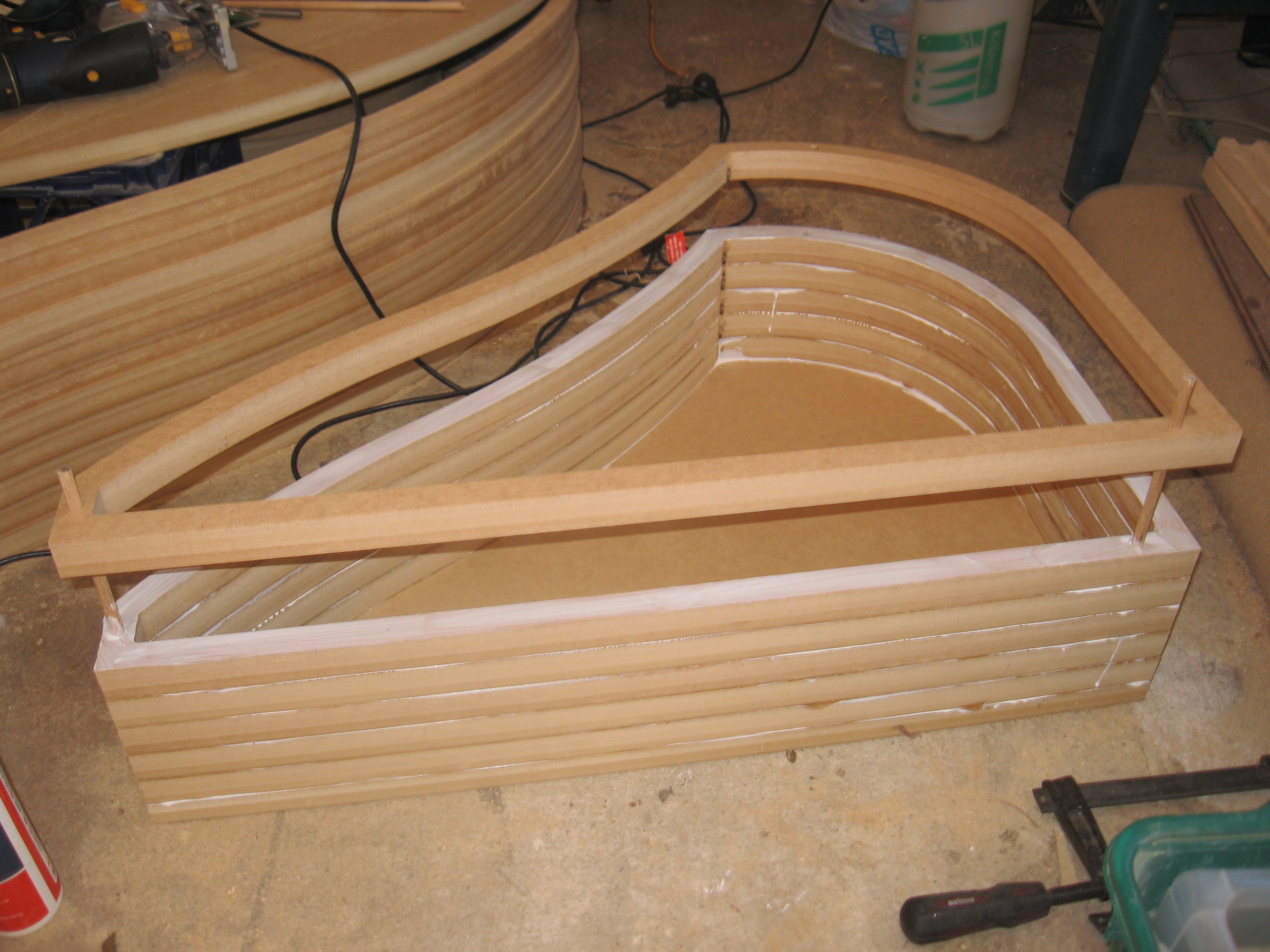

My mate's ply version...

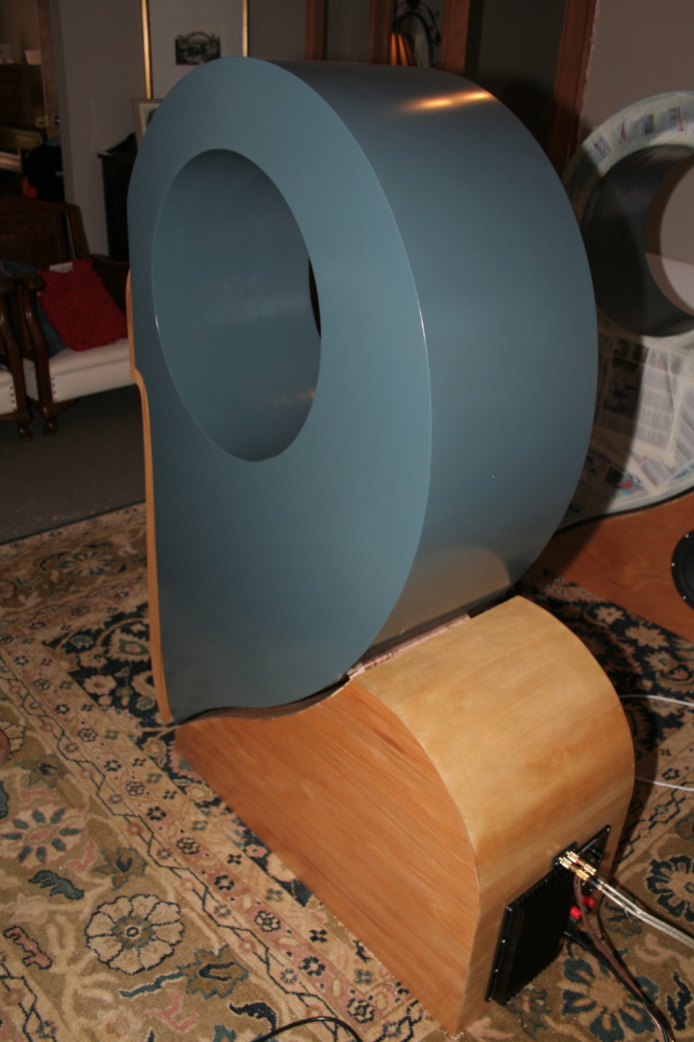

I also build the Carfrae Little Big Horn under arrangement from Jim Carfrae.
While the C-Horn can be a DIYer's dream...the Carfrae cannot be sold as such.
Lowther DX3 shown in this build.
Lowther 'Big Fun' horn and massive tapped horn shown in background of last pic. My lounge was being overtaken by horns...!!!

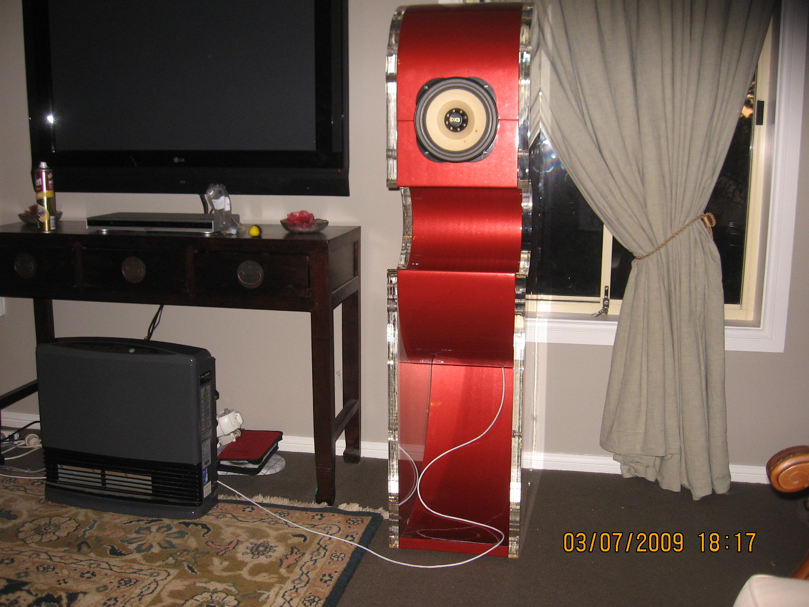

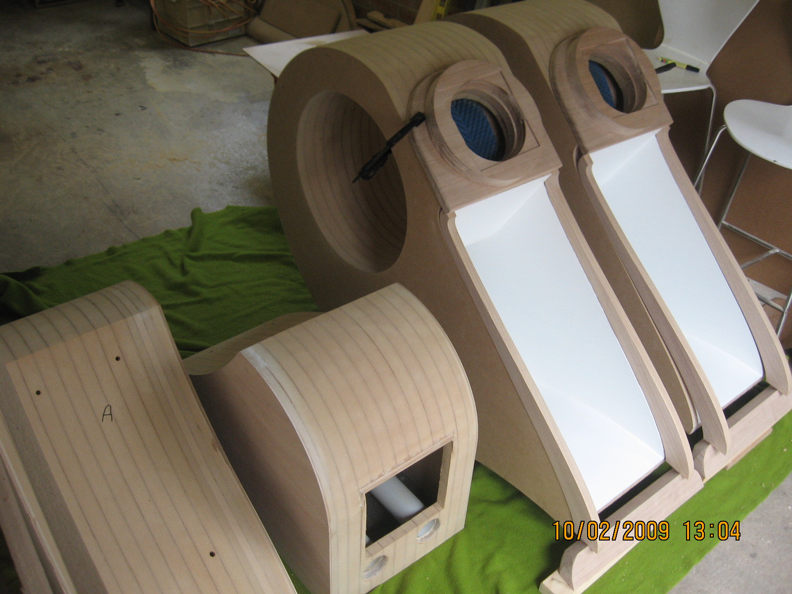

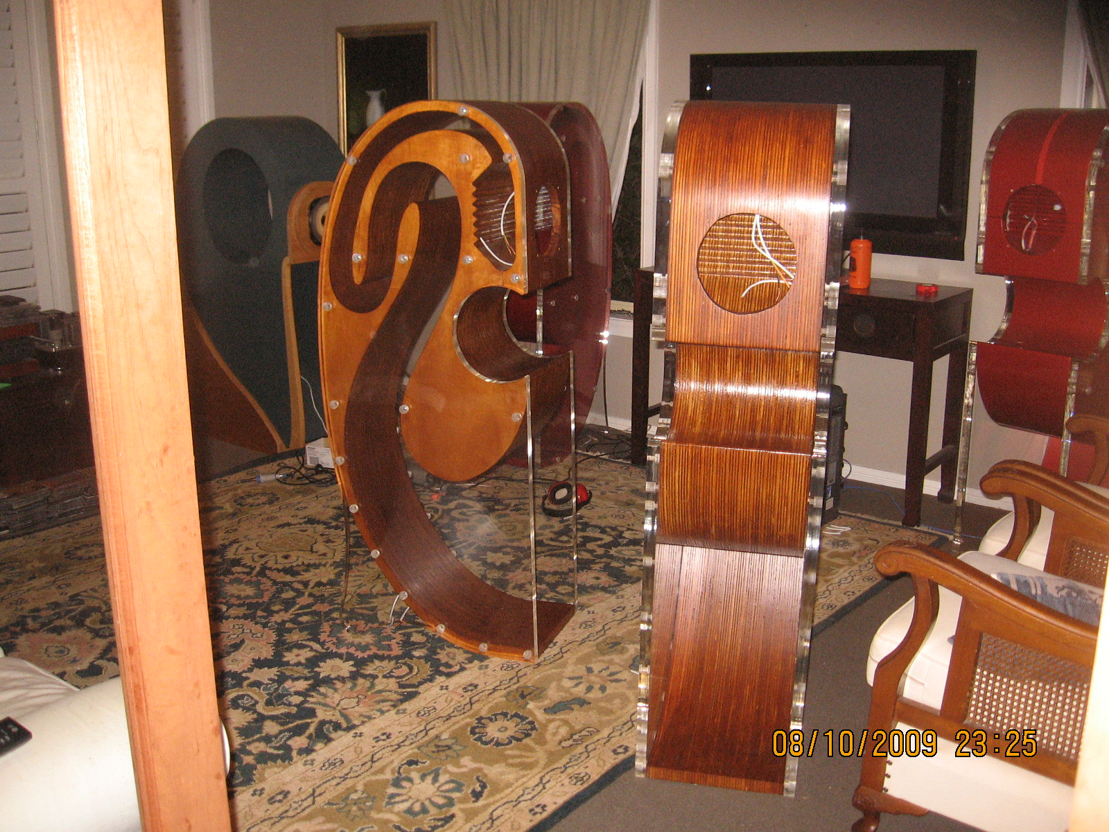

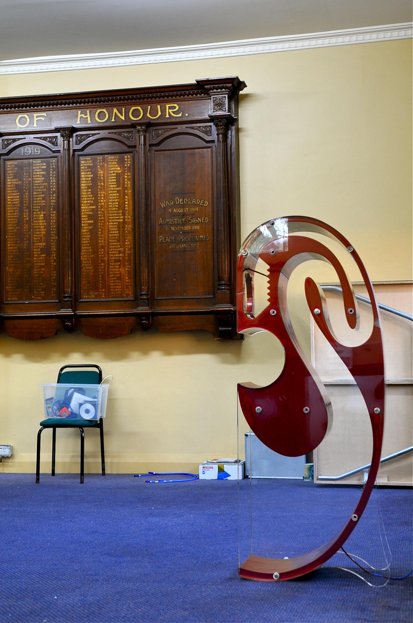

Andrew I have a few question, if you don't mind.
1) Why the change in the internal horn path from the CAD picture (Red/Smoke plexi) and your real picture (Red/Clear plexi)?
2) Which CNC version is the latest for cutting in two sections? Split in the speaker cutout (face) or split at the beginning of the "C" cutout (underside)?
3)How do you secure the plexiglass sides to the internals? Wood screws into the dowels?
Thank you for your time.
Hi.
1. No real reason. The CAD picture was the original mock up I created with the design engineer. When it came to the final workings, I opted for the current horn path. I guess the longer internal sections of the current design were easier to model.
2. The new design has the break below the comp chamber...refer to the pics of the all-ply version.
3. The side panels are designes to be fixed via large hex screws (eg 2.5 inches) directly into the hardwood dowels. The CNC cutting files have this all worked out.
It's a rewarding project for sure...but requires dedication and care...though it is straight forward. I've put a fair amount of thought into the design for the DIYers.
Kind regards.
