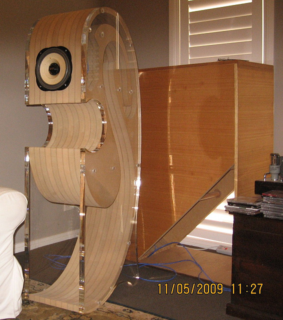

C-Horn Project!
No I don't think so. Acrilic (Plexiglas) should be cut with Laser cutting machine which one of my friends have
Acrylic cuts beautifully with a CNC router.
It takes a pretty powerful laser (100 watts or so) to cut acrylic thicker than 3/8 or 1/2"
There are not many non-commercial lasers that can take a sheet of acrylic as large as this speaker.
A DIYer with a hand router can cut acrylic very nicely if he makes a 1/4 inch plywood temple to follow the contours.
