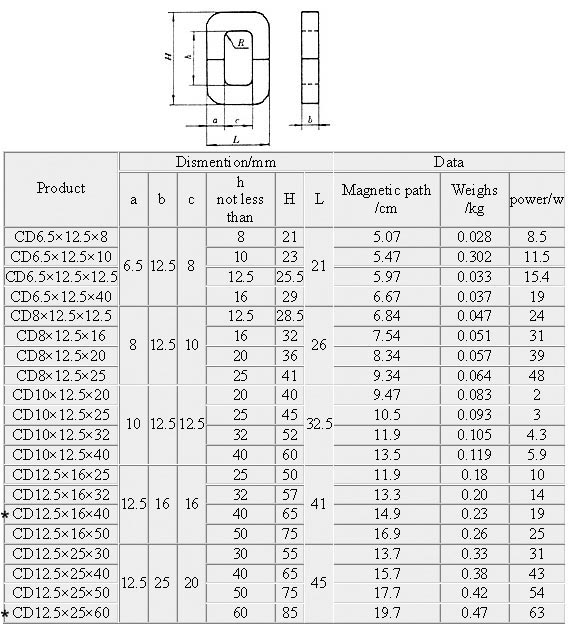

I have two types of c core, one is M5 0.30mm material and diamention for the gap surface is 12.5mm X 16mm, and the length is 40mm when two halfs of c core butted together . Magnetic path length is 14.9cm. It weights 0.24KG for a half piece.
another type of C core is same material, but bigger size at 12.5mm X 25mm X 60mm. magnetic path length = 19.7cm. The weight is 0.47KG for a half piece.
I want to try a smaller one first, to get winding experience and it might suite interstage winding ( future 845 project)
The OPT I'm going to wind is for a 6C45pi single ended , with 4Kohm primary and 8 ohm secondary. the core size seems can handle 2 watts ( 6c45 only gives 1.2 watts or so at clipping point) previously I calculated the primary of 6200 turns is for 25Hz at -1dB point, and DC current will be at 45mA.
Thats the spec for my first transformer, and the bigger core might keep for my future 845 SE projects. if the core size is suitable.

I'm not using old core that I mentioned at the first post , that is for a push pull trans.I just use it as comparison, but my new design will use new C core.
The two types of c core are new core that I purchased from transformer lamination manufacturer. The manufaturer did mentioned effective AREA around 0.92 thats right. Now I need a OPT as shown below:
M5 0.30mm material
Single C core 12.5mmX 16mm X 40mm
Single ended 1 x 6C45pi, single stage power amplifier,( driving coral Beta 8 speaker.)
4Kohm : 8 ohm
the core surface is smooth since it is new one.
The dismention is as below:

You still need to tell me if your using a single C-core arrangement or a Double C-core arrangement...look at the attached photo and tell me wich one you plan on doing....
.92 is not the AREA...it is the Stacking Factor... This should be very close to what it is....
Does the manufacturer say what the "effective" AREA is???
It's gotta be close to 18.4 cm squared.....

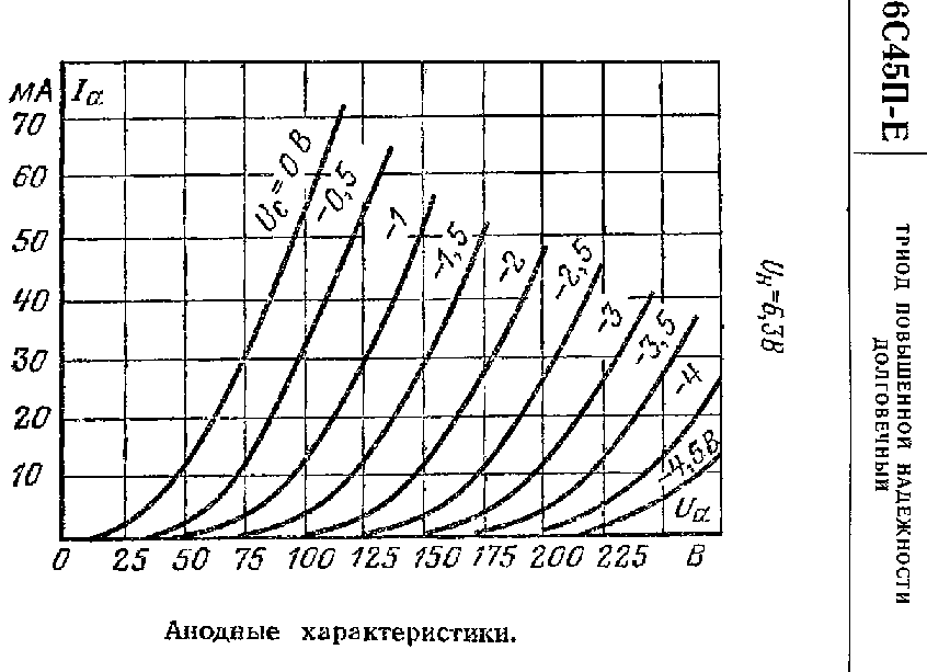

BTW: I looked at the curves for the 6C45pi...I can't see how you get 1.5W under your conditions of 45mA at 4K load ?????
Unless you plan on going into A2????
The MAX plate voltage is 150V...
Max plate dissipation is 7.8W.....
I attached the curves..

The 6C45pi can't get 1.5 watts. I build mine supply B+ with 215 volts and plate current at 40mA , plate dissipation 8.6 watts ( this tube can take a lot of abuse...) and already run for a year ,listen to it everyday. Currently I'm using Hammond 125ESE and my scope show clipping at 8.6V Pk-Pk into 8 ohm resistive load at 1 Khz. That gives around 1.2 watts of output. I wish to have the OPT design that can handle 1.5 to 2 watts, more headroom for it, if possible. The amp is a single stage amp, CD player output directly goes to grid of 6C45.
Sorry I didn't mentioned it clearly, 0.92 is stack factor,Manufacturer says " times 0.92" actual AREA is 1.84 sq/cm.
I'm not using double C core:
SINGLE C core 12.5mmX 16mm X 40mm (NOT DOUBLE C CORE)
4Kohm : 8 ohm
