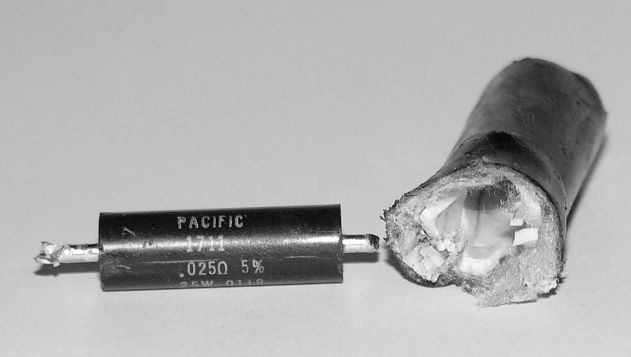

Note the ceramic still in the outer casing. That is where the action is, not the ceramic itself, but what is layered on the ceramic that actually conducts current too. I measured it, myself.
It is important to note that the material on the ceramic shell is what does anything interesting, the resistor just measures as a resistance, for the most part.
So does the whole "device."
No, I just measured the DC resistance, but many people might assume that it is just a ceramic shell, which would have a very high resistance. I am not equipped to test the device in the GHz region, where the 'action' most probably is. I don't know for sure, but that is where I would look, if I had the test equipment.
I am, I did, and there was nothing unusual. It's a resistor with a coating of fraud, but it does give you a mechanism to stir things up. 😀
An important point: SY tested a completely different product that is basically a special kind of resistor. The part being discussed is made of a separate quantum device (on the ceramic tube) and a resistor. They use a separate design path to apparently do the same thing. I would think that the ceramic tube type would measure something at GHz frequencies.
Really, how far out did you go?
20GHz. We have a nice R&S GVB20 in the lab. As you'd expect, a series L of a few nH, a series R of 30m-ohm, and a shunt cap of a pF or so, and not significantly different than the cheap resistor I sourced from Mouser or Digikey. Not that any of this is relevant to audio, but since that seemed to be the last straw you were grasping, I thought it would be entertaining to look. The component I tested is labeled as a Bybee Quantum Purifier with all the same claims attached to it, so your second statement would seem to indicate that you agree that it's a fraud.
