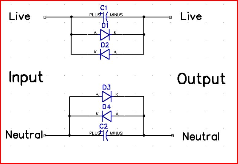

Sorry, meant to include diagram in earlier post. Here it is, 10000mfd caps 63v. You can wire up a bridge rectifier to give you 4 diodes per cap if you see what I mean, doubleing up on what I have shown.

Never tried this so can't say if it will fix problem or not. As to whether to use in both lines, just remember that that the primary side is a series circuit. It should'nt matter (from an operating point of view) if it's in live or neutral. Using two networks I guess allows for more D.C. to be removed (0.7v + 0.7v). If you allowed for a higher reverse voltage across the caps then two diodes in series (still two sets in inverse parallel mind) and one cap would achieve the same, as would the two original networks in series. I am just rambling now 🙂 what about two networks in series, with a single diode across each cap for reverse polarity protection and a string of say 4 diodes to limit the foward volt drop and connect the two networks so they form a bi-polar cap. Have to think about that one :bigeyes:
Regards Karl
I tryed this version of DC trap.
http://sjostromaudio.com/joomla/index.php?option=com_content&task=view&id=62&Itemid=27
The results was too poor for my big problem.
The stray effect was too high (1kW toroid).I tryed also to potted with 3mm double steel shield....rounded and H style.
The best choice is to replace the transformer with a dedicated toroid special made FOR AUDIO and not to try to make from an industrial tranny "something" good for audio.
Plitron-special design for audio- is one of the manufactures in audio transformers with very low stray effect and noise..
The type of winding and shielding of the bobin in such tranny is quite different from an industrial one.
Also R-core have low stray efect and noiseless tranny.Be careful with chineze manufactures.
Hi all , RyanW I have never found any product that works, we used to remove transformers, not large toroids admittedly, and heat them and then dip/soak them in varnish, no good :bawling: There is so much energy (magnetic field) involved that if the laminations are "loose" your never going to cure it this way. If the mains is spiky with harmonics present the transformer does a pretty good job of audibly reproducing these. I am also not a big fan of oversized power supply capacitors as the charging currents are huge, made even worse by the small conduction angle of the bridge rectifier in "topping up" these caps every half cycle. Where do all the negative half cycles go that we dont use 😀 😀 😀 ?
Hello Peranders, regarding live and neutral, we have the neutral bonded to earth at the consumer unit, there is no potential difference between them. From a safety point of view any network is better inserted in the neutral side as there is less chance of getting a shock if it is accidently touched.
Regards Karl

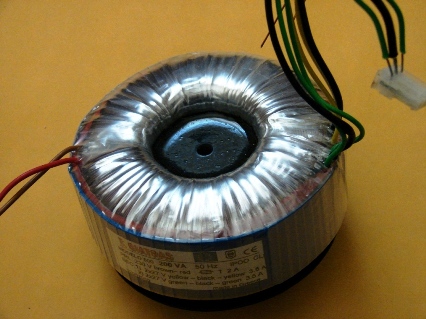

Voila a sample of a custom maden toroid according to my references in post #10. Its power it is 200VA
Fotios
