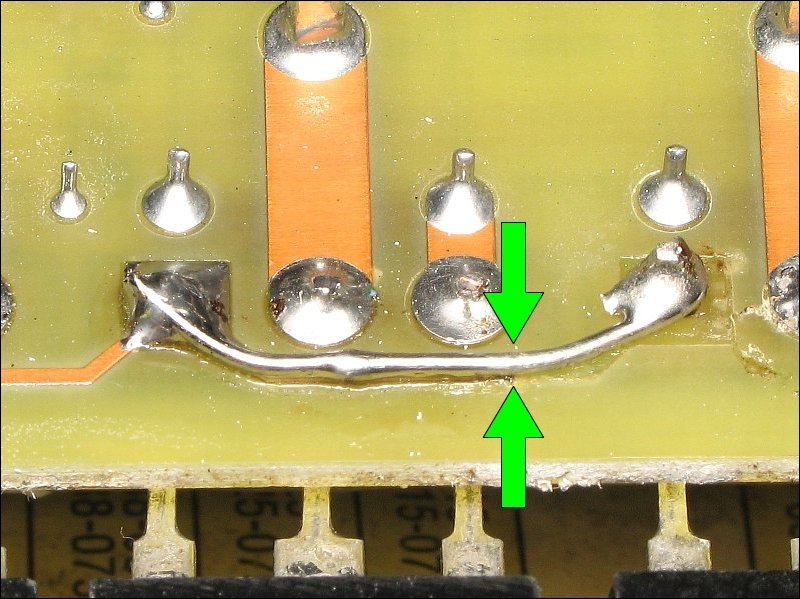

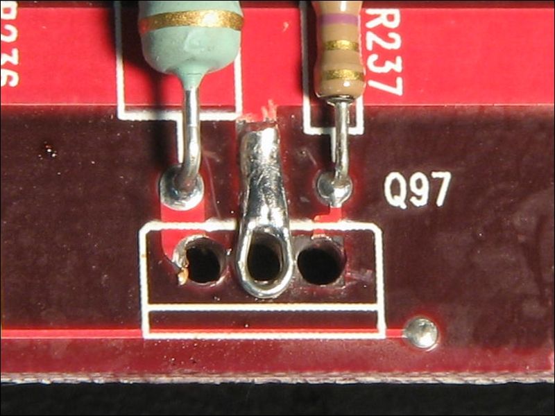

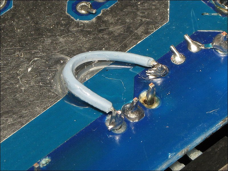

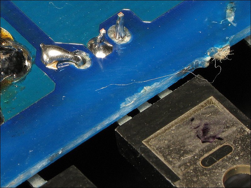

While taking the mosfets out, I "accedentaly" pulled a few of the solder holes along with a tiny peice of plated through hole trace. And now when trying to install new fets the there is nothing where to solder them to. Is there any repair holes i can purchase and istall myself? Also, after reading a few posts, when replacing burnt fets is it a good idea to replace the resistors? If so what is the value? Please advise thanks.
Any of the following will provide reliable connections. If the broken connection is between the FET and a surface mount resistor, you should use a small flexible wire so no stress is put on the SMD pads. The insulated wire below is from a computer IDE cable. It works well for low current connections. Using a drop of adhesive to hold the wire will prevent the wire from breaking (in case the amp is subjected to heavy bass/vibration). For connections that will have to pass significant current, you will need to use something that can handle more current than the insulated wire shown. The method used on the red board below is suitable for high current.

Perry showed some nice pictures of how you can install the transistors and make the connections if the lines are broken. If there was no chance of fixing the lines Perry showed you can cut out a small part of the curcuit board completely and insert (using heat resistance glue) a small part of standard printed curcuit board from Radio Shack.
