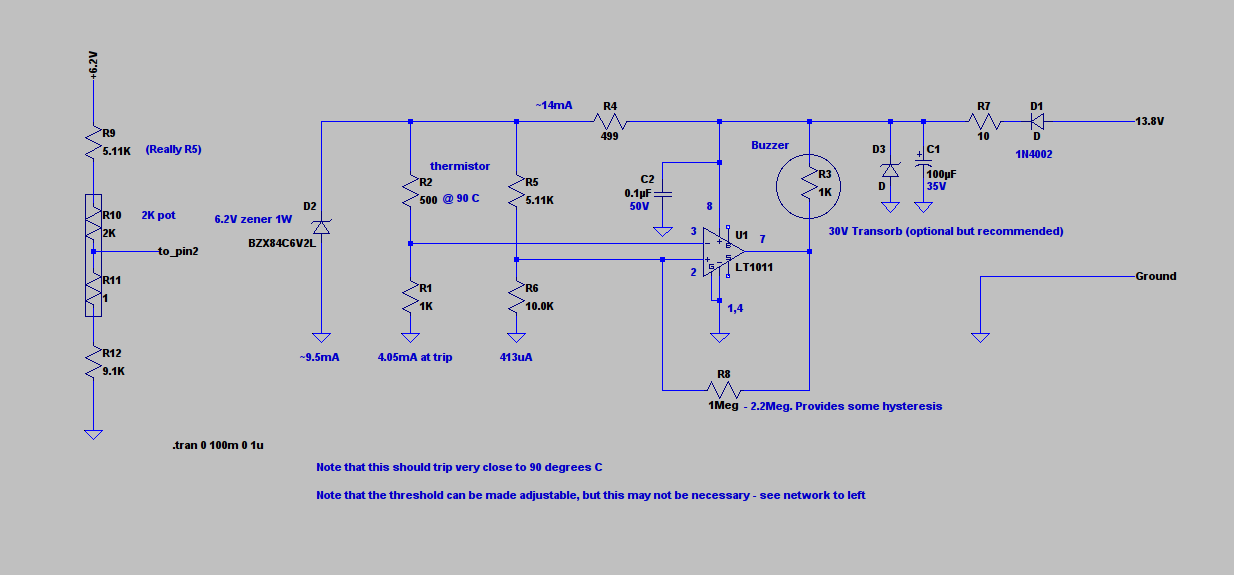

I have a thermistor in my car that measures air temp going to the engine. How can I make a circuit that buzzes when the resistance drops below 500R? I want it to let me know if my car is running too hot.

Use a thermistor to sense temperature as one leg of a resistive divider, and a comparator to set the trip point, an LM311 would do just fine with a cheap reference and a pot to set the threshold. There are lots of 12V piezo buzzers available that can achieve sufficient (sometimes way too much) spls to get your attention. These parts should be available from a variety of online sources, RS Components or Farnell.
Edit: The LM311 is open collector and will run most piezo buzzers directly off of 12V. The thermistor would be connected to the - input of the comparator and the adjustable reference voltage to the + input. Some hysteresis to the + terminal from the output is advisable, a 1M resistor would probably suffice.. Look at the app notes for the LM311 for suitable circuits.

Ignore balance and balance/strobe pins. The LM311 is well suited to single supply operation and in fact is often used that way. I'll try to post something for you tomorrow morning. (my time)
Please post all of the electrical information you have for the thermistor you have, and the desired trip point in degrees C.

The thermistor is RS part number 697-4553. It needs to trip when the thermistor value drops below 500R which is about 90c. I've got a buzzer with a built in occilator, so it just needs to output some voltage when the trip point is reached.

set up the Vref string and the Thermistor string as a measuring bridge using the same +12V and 0V tappings. This removes voltage variations from the comparator functionality. It compares thermistor resistance to reference resistance.
As promised here is what I would do - should work with any bogey variety LM111 - 311 or the LT1011..
I prefer to operate the thermistor and reference string off of a lower voltage in order to avoid potential input common mode range issues, although in this case device CMR is sufficient for operation directly on the supply. Being relatively ratio-metric as shown a regulated supply is not is not strictly necessary, but 1 watt 6.2V zeners are quite cheap. Depending on the degree of precision required you might not even have to calibrate it. (Depends on the accuracy of the thermistor) The lower voltage is preferable I think in order to reduce internal self-heating of the thermistor.
1% tolerance, low tempco resistors are assumed. Except as noted all may be 1/4W CN55 types or similar. Transorb/TVS diode is optional, but recommended - largely anything you can find in a through hole package should be adequate for this task. R7 should be 1W type, and I do recommend a 1A fast blow fuse ahead of all of this, and I assume this will be switched by the ignition switch as current consumption is significant. Non-destructive reverse polarity protection is included.
Buzzer current should be no greater than 50mA - if this is not the case a minor change is necessary to add a driver transistor. Most solid state buzzers I have encountered use less than 50mA so you should be OK.
Note: You could omit R4 and D2 and operate the thermistor directly on 13.8V supply if you wish. (I wouldn't..)

Note that the measurement and reference resistors constitute what is commonly known as a wheatstone bridge if that helps you understand a bit better how it works.
