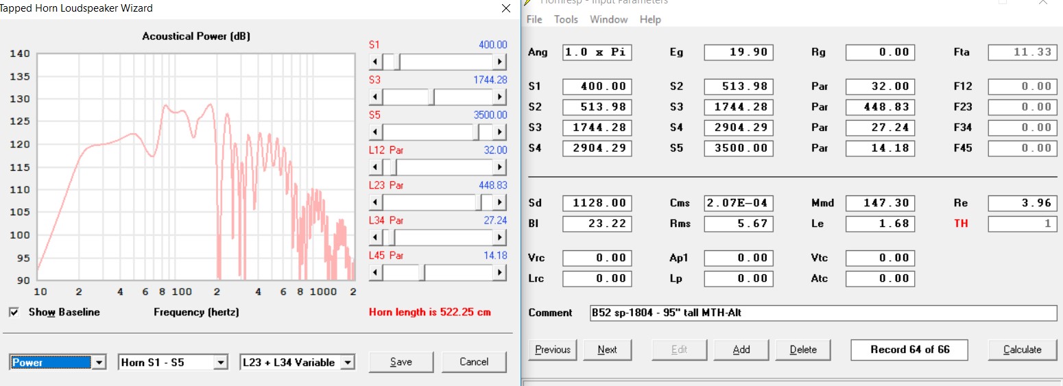

Hmm, short of a full on compression horn or large, well damped TL, LR2 with this driver, desired BW pretty much limits you to simple reflex, sealed alignments and room/corner gain to get 'flat' to 20 Hz in room at some reasonable amount of efficiency.
The TQWT I considered posting is ~375 L and limited to 80-90 Hz with just 2nd order, though Xmax limited to 80 W sims a minimum ~118 dB/m/1pi from 20 Hz-up.
GM

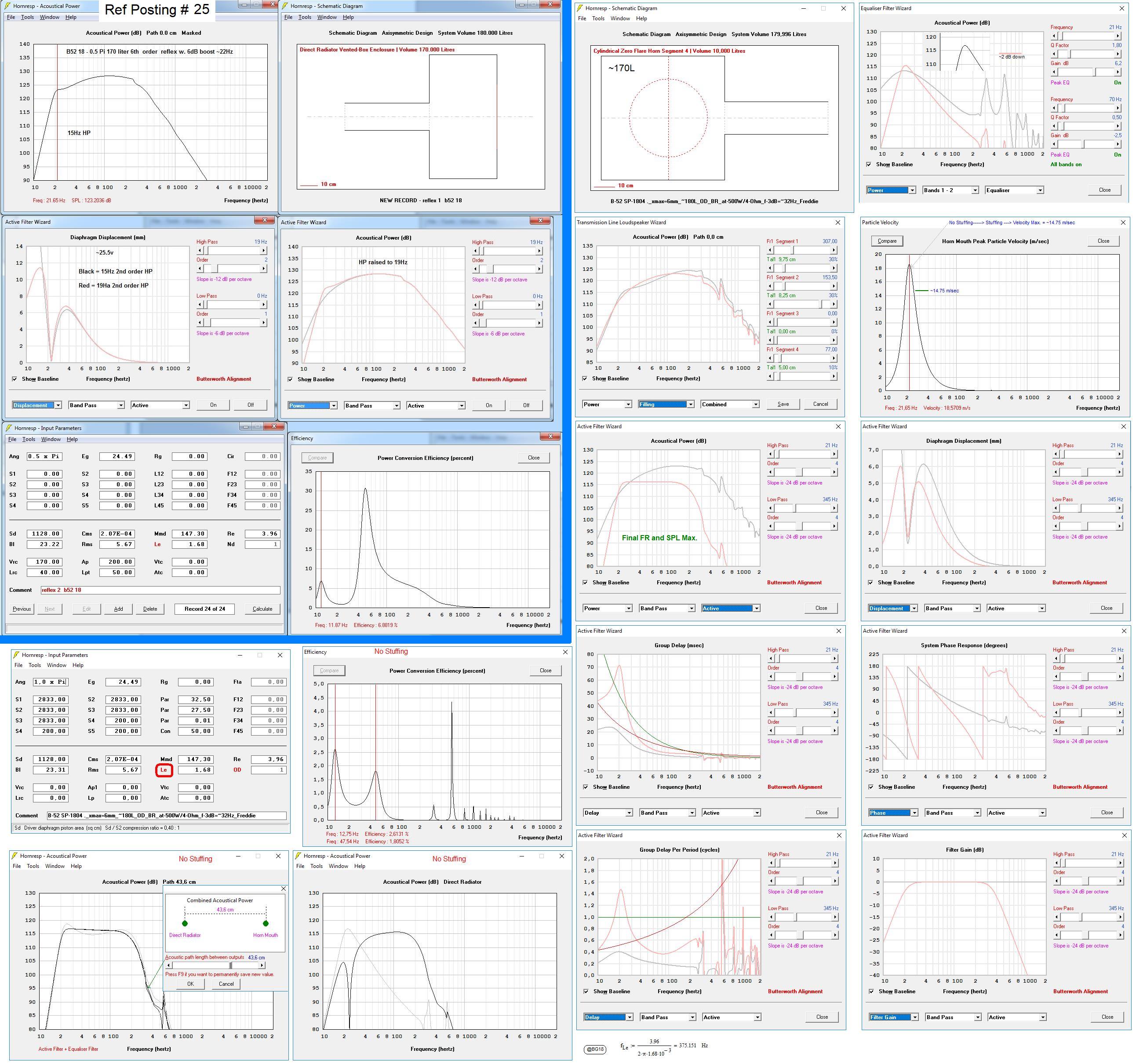

I think I’m gonna end up going with the 170l 6th order that Freddi posted, the response looks fairly flat in the target bandwidth. Simple construction is a plus, too.
@ snappyturtle
Looks quite good to me, for 20Hz - 80HZ

Your 375Ltr sounds good too, So please post it

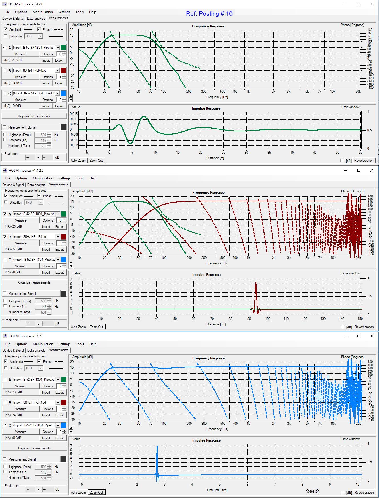

but consider the 170 liter reflex in 6th order mode with 16Hz HP and 6dB/Q=2 peaking at fb - - that takes more amplifier power as a tradeoff but only in that one narrow region
FWIW I think theater organ recordings would sound "ok" on the eq-ed reflex
and the TH is a bit over double its size - and the reflex has less excursion from 25-~40Hz
(and less in the sub-20 region)
I wish EQ-boxes for 6th order reflex were available - wouldn't take much circuit or cost wise

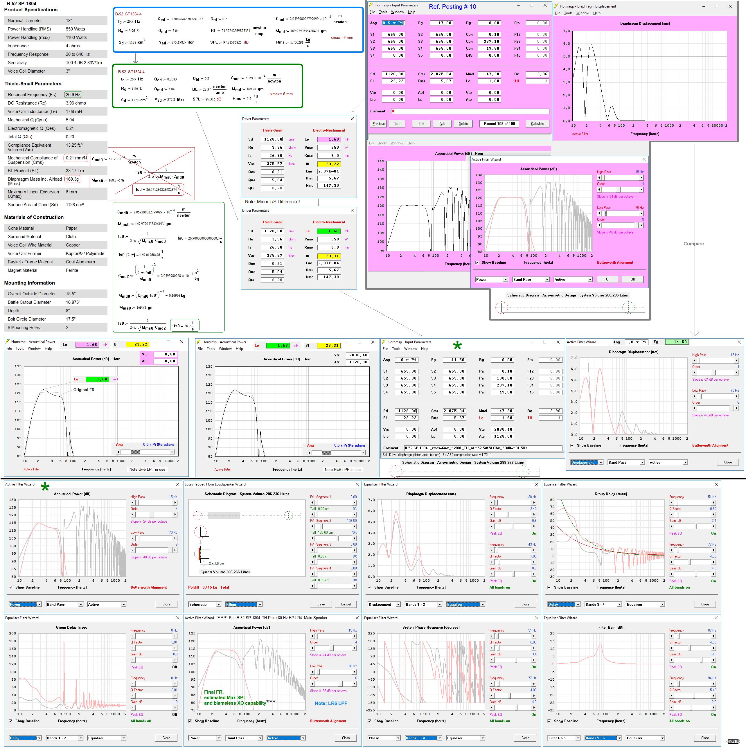

At the end outfoxhyperion must measure the driver with rew when its delevered, and with the real t/s and the semi inductance values all we´ll can make better simulations 😀

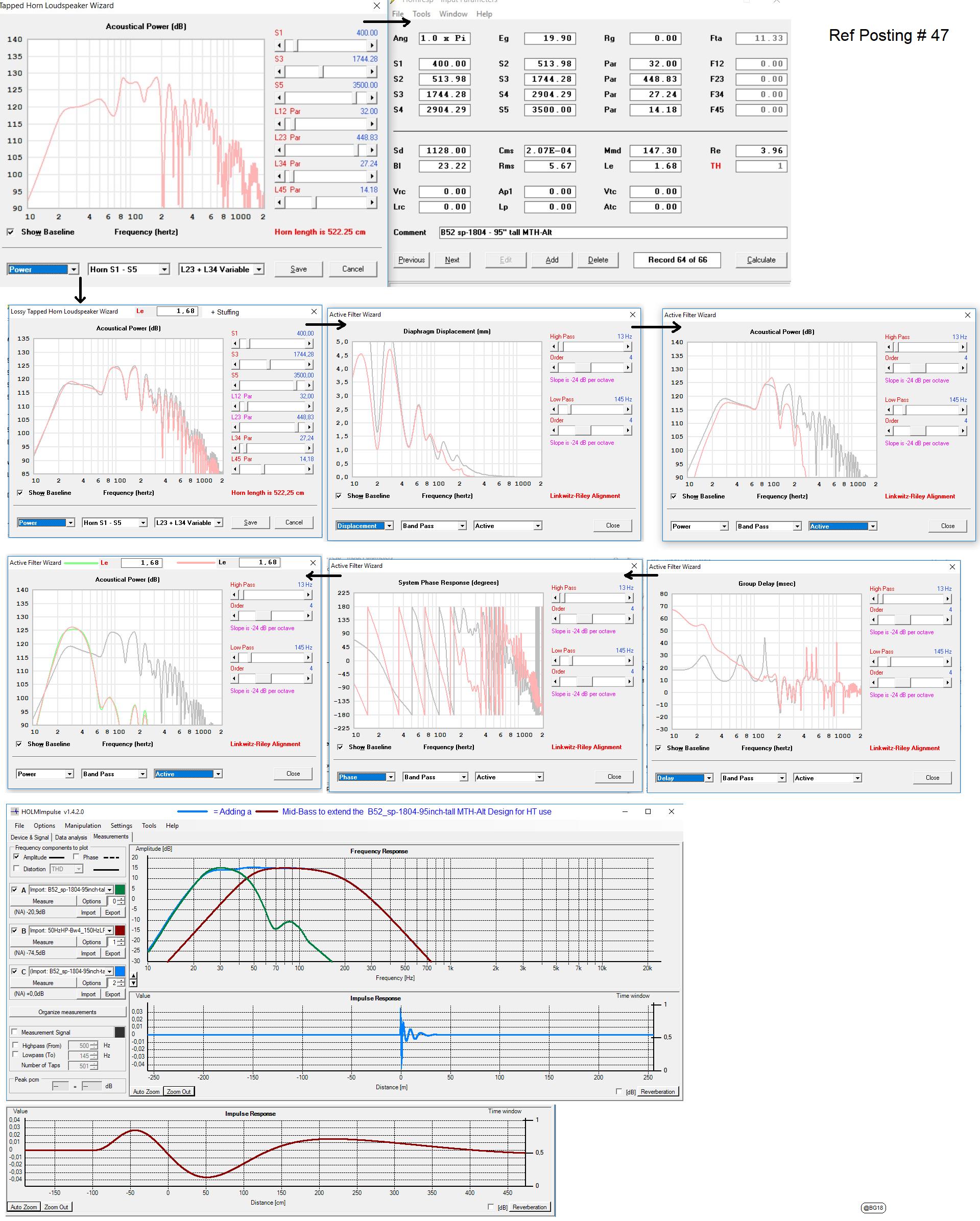

I’m probably going to end up going with the 6th order reflex, as I’m willing to trade off a little bit of sensitivity and ultimate SPL for the sake of maximal flat extension and improved cone control. As of right now, though, I don’t have any measurement tools available so I’ll have to trust the manufacturer published specs. If anybody has any measuring tools they’re looking to part with, though, feel free to PM me...

With that bit of knowledge, should I still proceed with the 6th order reflex or maybe go with a large sealed alignment and do something like a LR transform to keep it flat to 20 Hz? Reading the reviews, it looks like the built in subsonic filter only goes as low as 25 Hz, so using filtering to prevent overexcursion on subsonic content with this amp isn't an option.
