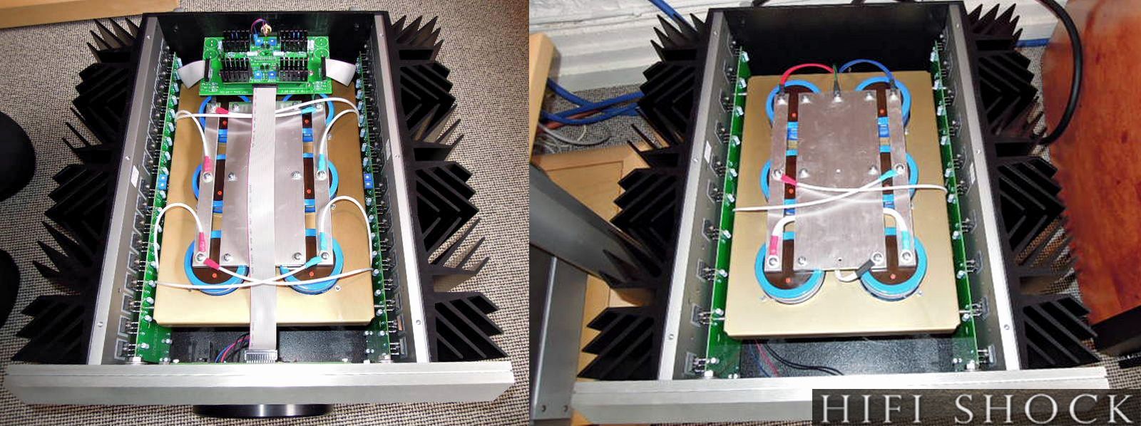

The power supply in post #5 looks stunning. I'm guessing that's from an XS product?
Yep, from the XS Pre though. Unfortunately you can't see the transformer in the amps.
