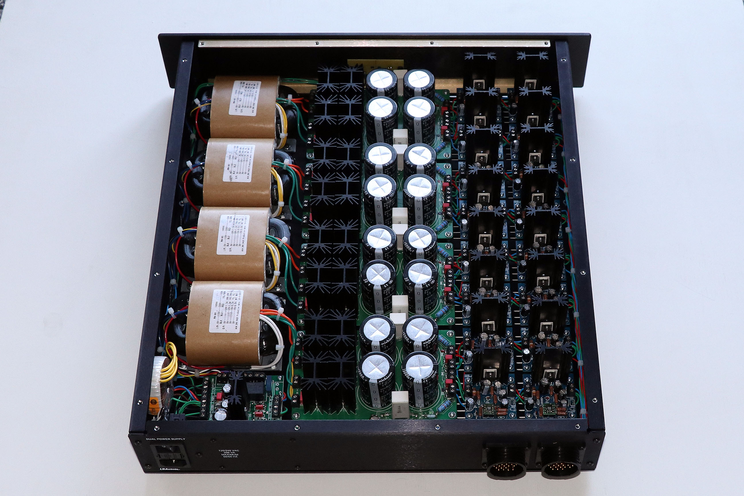

Yes R cores have lower inrush- no thermistor or soft start required in the dac or preamp - Fuse is 2 amps for the 4 x 100 va in the preamp chassis - load is about 100 watts class A in the preamp / phono -yes 100 watts class A for a balanced jfet/fet preamp and phono. There are almost 100 TO247 fet and bipolar devices running at 45 C, most are in the power suply - Jung super regulators, then the fet shunt regulators, the output of each analog stage is Hitachi fets running at 80 ma and 24 VDC - 2 watts per device - very deep class A
