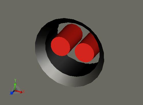

Rather than twiddle my thumbs, I'm making a dual LED holder to fit our chassis.

By adding that round tube to the heatsink the airflow through
the sink will slow down so the benifit of more heat disipating
area will be lost. Wakefield enginerring had a short article on
this in one of there old catalogs and the conclusion was in a
properly designed heatsink the volumn of the sink was a better
indicator of thermal resistance than total heatsink area.

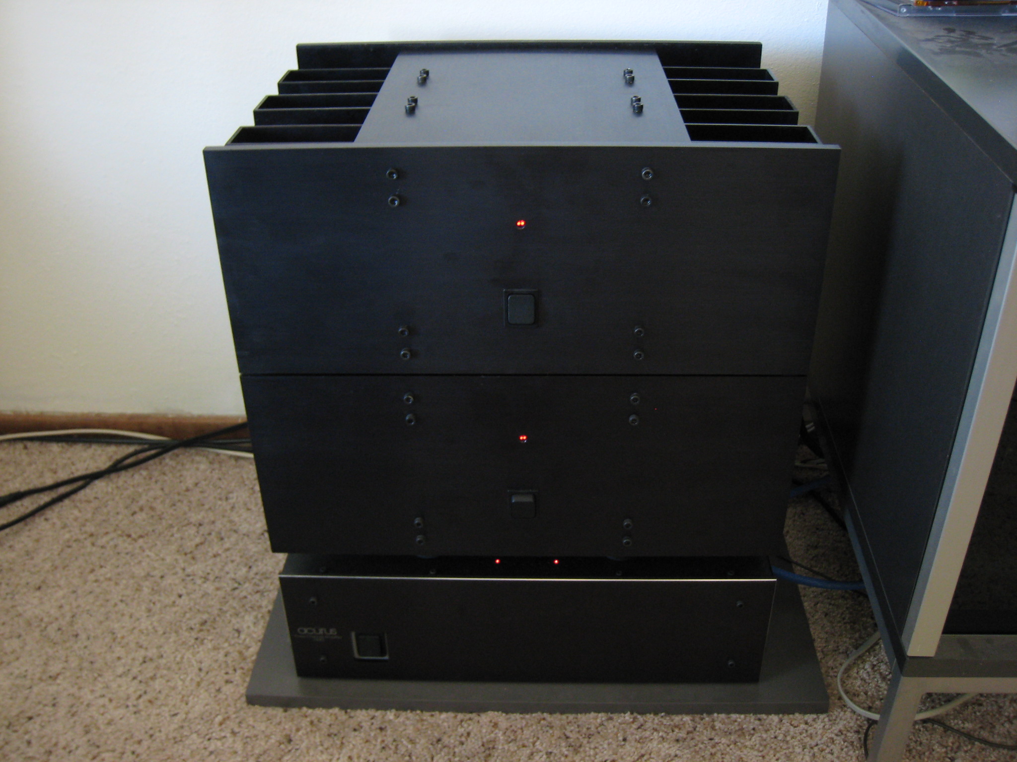

I guess this would be the right place to post...
I am part of the fortunate group that has chassis from Mr. Pass he generously donated for the 2008 Burning Amp. The very case this Burning Amp BA2 is intended for. Case was originally used by Mr.Pass as a test bed, and who knows what great amps came out of it. Just for that reason and the fact that Master worked on it, I treat it as a very special item.

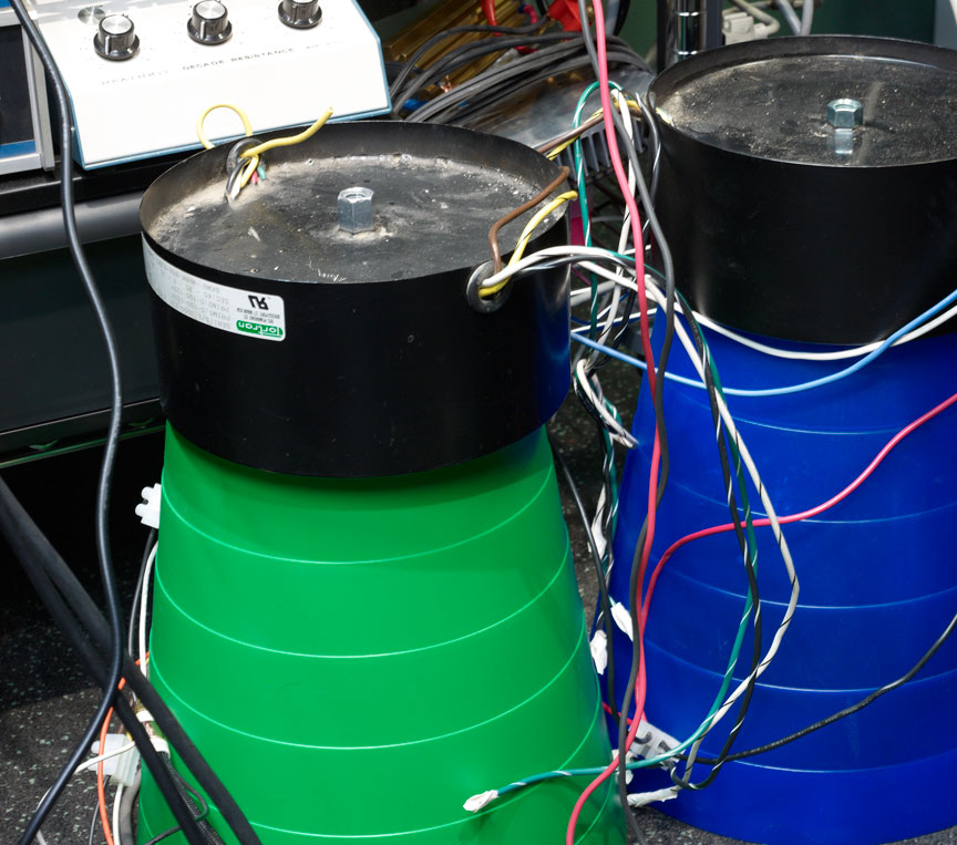

So what best use for the case than using it again for what was meant for? While I am waiting for the BA boards to be produced I wanted to test few amps and hear what they do. My planned line up include F5, F5 balanced, F5 with cascode drivers and two output pairs (schematic designed by Zen Mode) balanced, F3, Aleph J and Aleph JX, Babelfish by Zen Mode, BA1 and BA2... I also have huge transformers that Mr. Pass donated for the first BAF 2007. Those are real monsters, originally used in X1000. I do not know exactly, but I believe they are something like 3 KVA each, potted, center tapped with dual primaries (220 and 120V) and with equal secondaries: 45 - 35 - 0 - 35 - 45
Between two of these I could get any dual voltage that I could have ever dream off. From 18 V to 90V and anything in between. I have Peter Daniel's boards and Zen Mod's Babelfish boards, so all that was needed were parts for the boards which I just ordered and received last week.

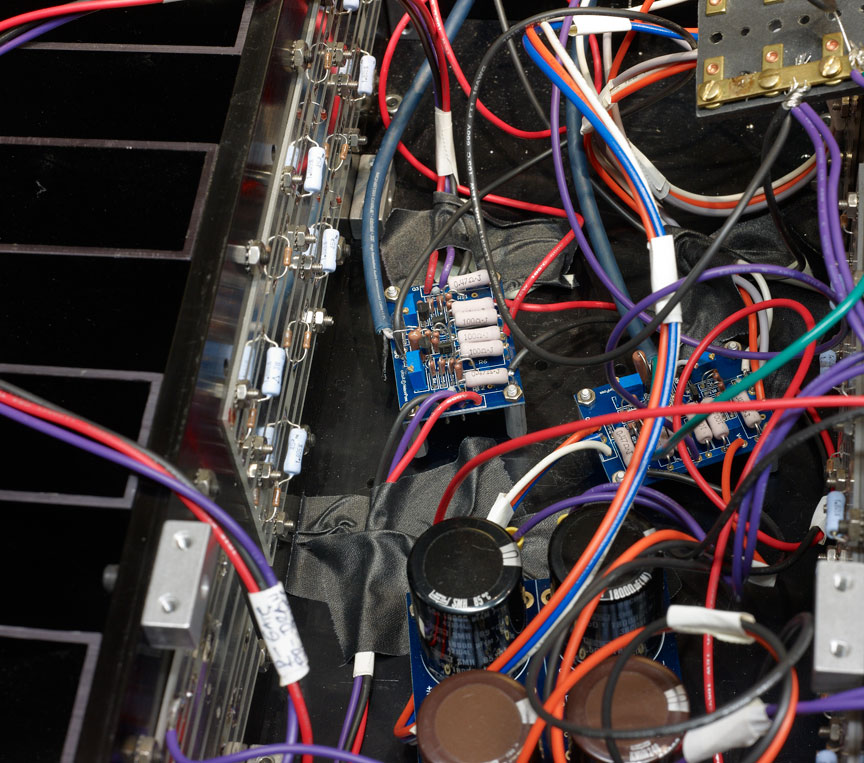

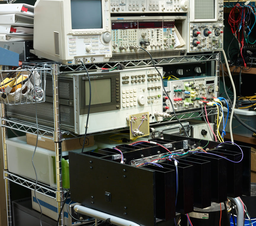

Case has already installed N and P channel MOSFETs, 6 pairs on each side. That gives me the opportunity to test any type of amp just by wiring needed output fets. I could even have two different amps in the same chassis. Since I do not know where I am going to end up I didn't mount anything permanently and everything is wired so that I could easily exchange input boards, add more output devices... Obviously trannies are outside of the case, as well as rectifiers. Here are the pictures. Obviously everything is mess, wires are everywhere, much longer then needed, but it provides me with an opportunity to test.
Here is the shot of the chassis in front of my test line up.
