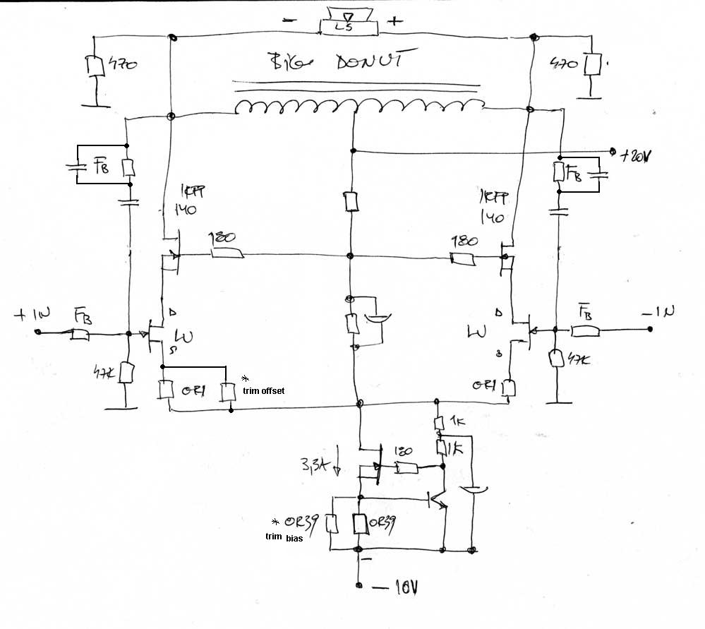

And how about driving somthing like an R1 ribbon? Would the close to resistive load be a good combination?

It's straightforward enough. One way is to get a big power
amp with about +/-80V swing (400 watts into 8) and place
the R1 ribbon in series with a big 8 ohm resistor.
The other way is to build an active current source capable of
about +/- 5 volts at 10 amp peaks. As a push-pull Class A,
this would need about +/-10V rails at 5A bias, for about 100
watts idle dissipation.
You could do this complementary Common Drain and with a
feedback loop for current source on the front end, or you could
do it complementary Common Source without feedback.
The latter would be the most interesting. If you guys are that
hot to have one, I do have a schematic and it could be a project.

For a ribbon amp the post #6 by ZenMod in the Choke Susy thread has posibilities. As it is posted the value of the 2 inductors
needs to be large for a fullrange 8 ohm load. But the value of
the inductor needed for a tweeter amp is a lot less and it also
falls when the load resistance is lower. For a .2ohm ribbon with
a low end cutoff of 2k a pair of .1mh chokes might work for
a low power ribbon amp. I am taking the liberty of reposting
the circuite ZenMod posted earlier.

I think that LU isn't capable of current needed to drive ribbon directly ;
maybe without LUs , but plain mosfet instead , still cascoded .
well - Papa probably have simpler and more efficient solution in drawer .........

I have several in the drawer. What would you like?
Something like that maybeNelson Pass said:...an active current source capable of
hot to have one, I do have a schematic ...
