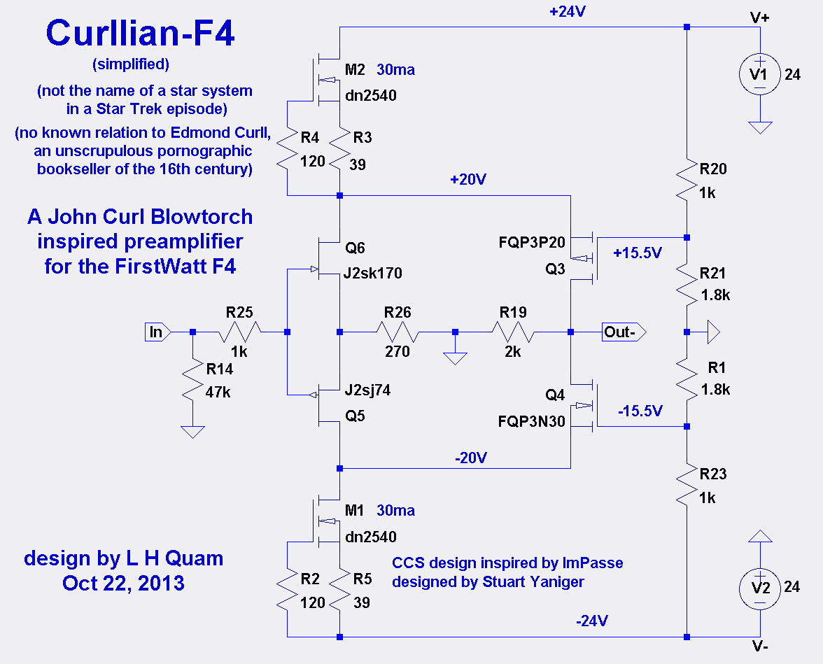

Here is such a tweak. I have been working on a Blowtorch variant for several months. This is a simplified schematic. You will find more on the F4 thread. http://www.diyaudio.com/forums/pass-labs/97540-f4-power-amplifier-384.html#post3678887
The variations in both Id and Vds in the output stage MOSFETs do not lend this circuit to low THD; because they are contra to the patent by Threshold's Corp. which taught STASIS; meaning contant current through and constant voltage across the transistor.Here is such a tweak. I have been working on a Blowtorch variant for several months. This is a simplified schematic. You will find more on the F4 thread. http://www.diyaudio.com/forums/pass-labs/97540-f4-power-amplifier-384.html#post3678887
Yes. The option of loop feedback to the joint gates to lower THD. Side effects are a low Zin [1K], and maybe triodizing the otherwise pentodish character of the parent amp.you can always cascode the cascode , even folded one![]()
This output stage MOSFETs acts as a folded cascode. See the Blowtorch thread http://www.diyaudio.com/forums/solid-state/71189-john-curls-blowtorch-preamplifier.html (good luck wading thru it).The variations in both Id and Vds in the output stage MOSFETs do not lend this circuit to low THD; because they are contra to the patent by Threshold's Corp. which taught STASIS; meaning contant current through and constant voltage across the transistor.
The main differences between the Curllian-F4 and the Blowtorch are:
- 40 volt peak-to-peak output voltage
- single ended
I show some build results for the Curllian-F4 in the F4 thread: http://www.diyaudio.com/forums/pass-labs/97540-f4-power-amplifier-385.html#post3684975. I am not sure which thread to use for this.
