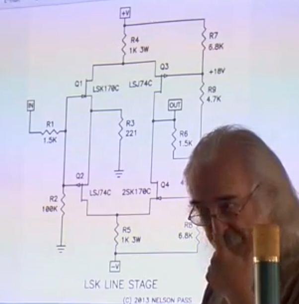

Yes, Juma, I heard it in the talk, but I could not see it in the first video....
I suppose it was on the later videos......
Thanks for the picture!
what is behind Nelsons head, or what is in Nelsons head hidden?....😀😀
Nice no NFB complementary Folded Cascode topology....
Nelson forgot to indicate the PS voltage in that slide: +/-45V
FYI JFets are selected for 15 mA Idss
Behind Papa's head: 1.5k + 4.7k + 4.7k node referred to gnd
Massimo,
thank you very much for filling in the values behind Papas head! 🙂🙂
I cannot believe such a high voltage of +- 45V for the J-Fets, at least not for the Toshiba version, would they not break down? and such a high Idss?
