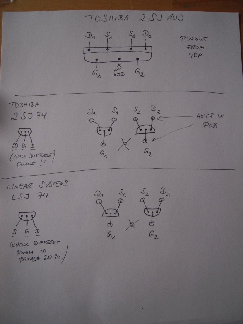

to COBAR53
Hello COBAR53,
as ZenMod wrote you can replace the TOSHIBA 2SJ109 (BL-grade)
with
TOSHIBA 2SJ74 (BL-grade) pinout is: D-G-S
or
LINEAR SYSTEMS LSJ74 (BL-grade) pinout is: S-G-D!!!

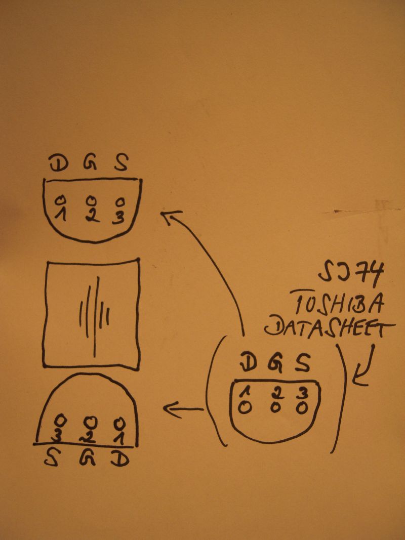

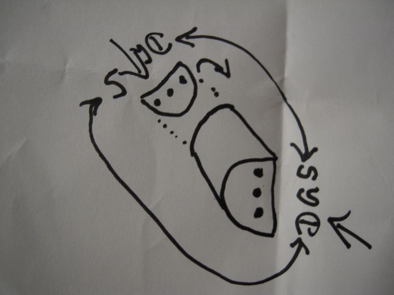

I tried to make a sketch that hopefully explains how to insert two 2SJ74 or
two LSJ74 into the pcb instead of one TOSHIBA 2SJ109.
Observe the different pinout of 2SJ74 and LSJ74!
Check the pic. I hope i made no mistake. 🙄
Greets
Dirk
Hello COBAR53,
with
or
Greets
Dirk

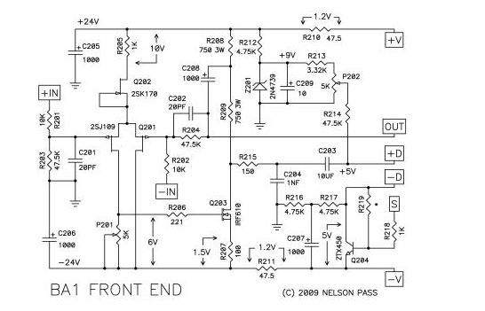

I have just re-read the original BA1 article and notice that the front end schematic is different from what has been used here. The original is below and has the Out terminal connecting to the feedback network of the LTP instead of the feedback being local coming from the drain of Q203 as shown the the schematics in this thread.
My question is: if I wanted to employ global feedback over the local, will the original version of the schematic work?

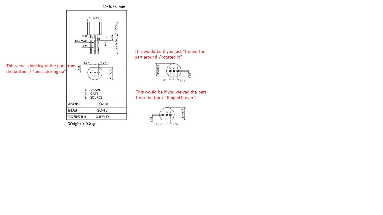

Hi Dirk!
Hope all is well. I have been confused about this for some time. I've accepted that I can't read a mechanical drawing properly (apparently I wasn't the only one confused). However, I believe that the pinout for the Toshiba and LS parts are the same. Thankfully, I caught my first error with some help before destroying parts. The stress from de-soldering the parts was enough to convince me to get one of those little testing thingamawhatsits that shows the pinouts. I installed my first set of genuine Toshibas incorrectly
Someone with more experience than I should confirm definitively!!!! My only advice is to pause prior to implementing until a smarter brain chimes in. I'm often incorrect.
Here is a nice discussion that can explain more properly.
https://www.diyaudio.com/forums/the-diyaudio-store/243148-jfets-linear-systems-4.html#post4306123
Edited to add - I believe the pins when viewed from the "flat side facing you and pins down" is D-G-S for both left to right.

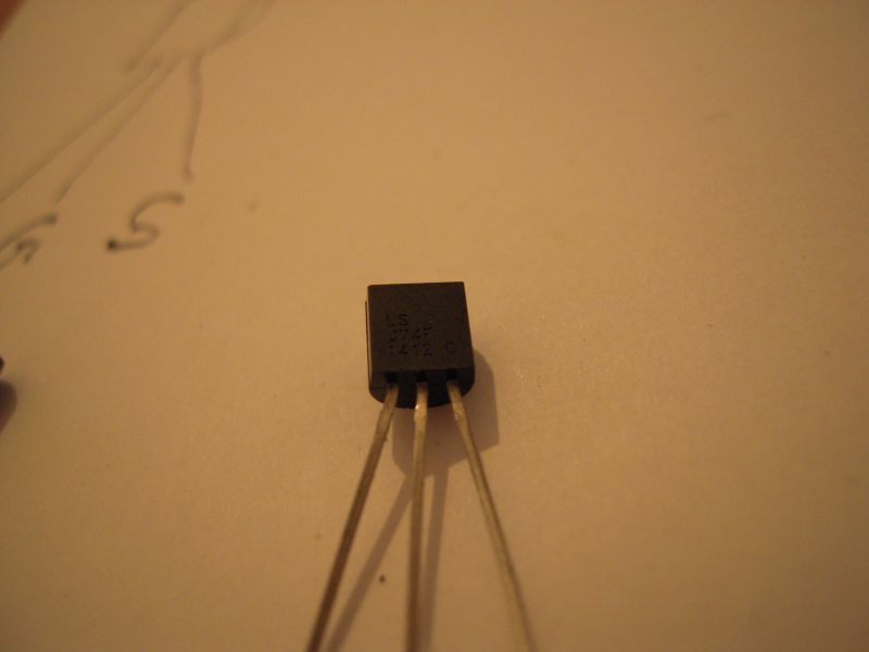

to ItsAllInMyHead
Linear Systems datasheet says clearly 'from top'.
Toshiba datasheet shows pinout from 'legside' or bottom side?-I think 😕
I am not 100% sure! I f I am back home, I will put those devices again in my
tester.
But I am not at home. Perhaps tomorrow.
tester.
Hi Dirk,
To me, the LS data sheet is a bit more obvious. You are correct, that the lower rendering on the Toshiba data sheet is looking at the device from the bottom vs. the top. So, when it's "flipped over", you can see that the pinout is the same as the LS device, and is the same DGS configuration. 😀

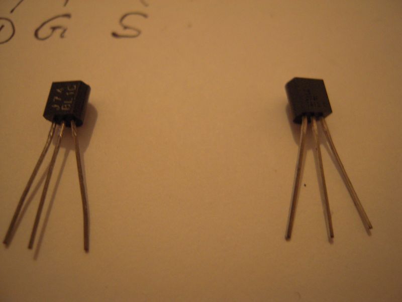

to ItsAllInMyHead
Yes, it's confusing!

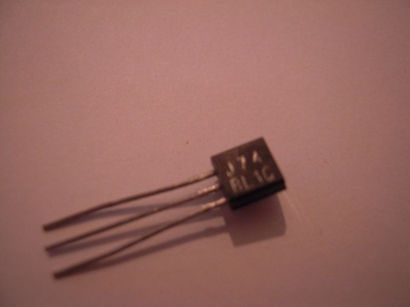

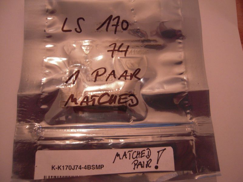

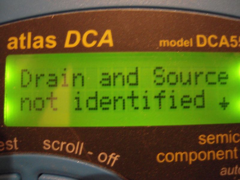

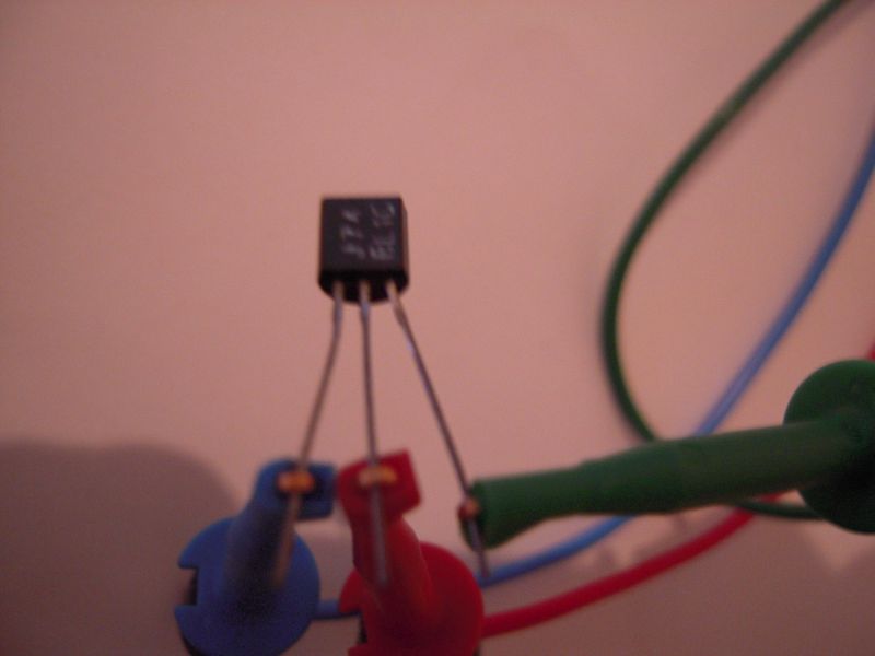

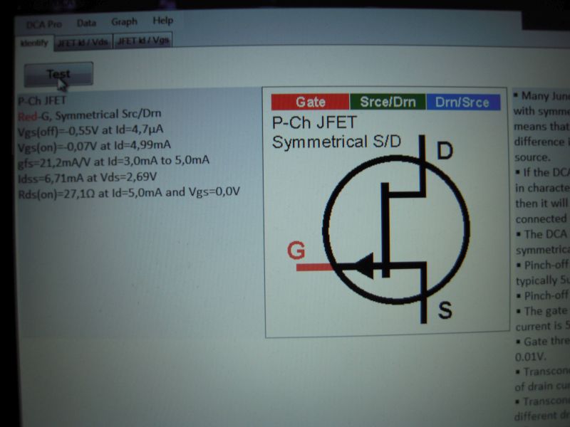

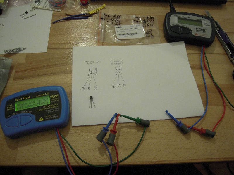

I measured a Toshiba SJ74 and a Linear Systems LSJ74 with my older DCA75 and with the newer DCA75Pro.
Only the 'gate' can be detected. 'source' and 'drain' are called 'symmetrical'.
So: some more confusion. 😕
Greets
Dirk
Greets
Dirk
