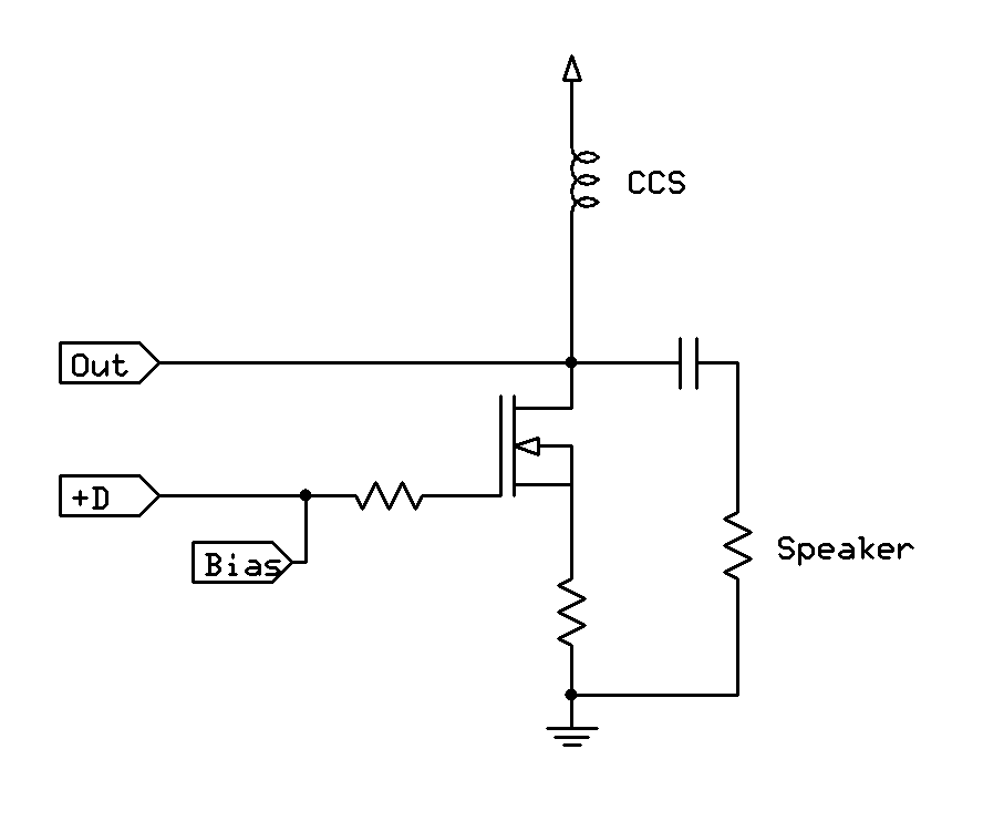

Is it possible to use the BA-3 frontend and the BA-1 outputstage?
How do I connect then?

you have all answers on beginning of BA3 article
Papa didn't include those schematics for nuttin'

I've been looking at a BA-1 frontend for a while as my current output stage ideas all have fairly low voltage gain... so I have questions about the bootstrapping of Q203: Does it work when combined with current source amps too or does it need a low output impedance voltage source output stage to function?
you need that bootstrap for obtaining proper voltage swing at node +D
that's your call which sort of OS you're going to use and , according to that , to connect or not nodes -D and S ......
however , I'm not fully getting what you mean by "current source amps" here ....... if anything can be called that , BA1 OS exactly can ......... even if I'm wrapping that in my head as function of entire amp topology , not just OS per se
btw. , you can also use BA3 OS (call it F4 if you like ) ...... which is classic source follower stage

Yes, the idea is to connect +D to the input of the output stage but to have a common source one instead of common drain. And then not add any feedback other than degeneration keeping the output impedance high at 100 ohm or more.
And lastly, if I've understood correctly the bootstrapping itself is kind of feedback but my hope was that it will not impact on the output impedance of the amp in any significant way. In that case it might be better for me to swap the bootstrap for a normal CCS. While this large voltage swing is nice my output stage will have some gain so I could get away with less swing on the front end.
I am not in any way gifted in electronics. I have been trying to assemble the BA-1 and do not understand how to interface the front end and output stage.
It seems to revolve around D and S but it is unclear to me

It has been awhile since I built this amp but without studying the article again I believe adding the FE + OS stage is the same as the BA-2 build guide presented here.
BA-3 Amplifier illustrated build guide
Stack the FE on top of the OS board per diagram and connection becomes easy. Excellent amp, one of my favorite FW builds.
