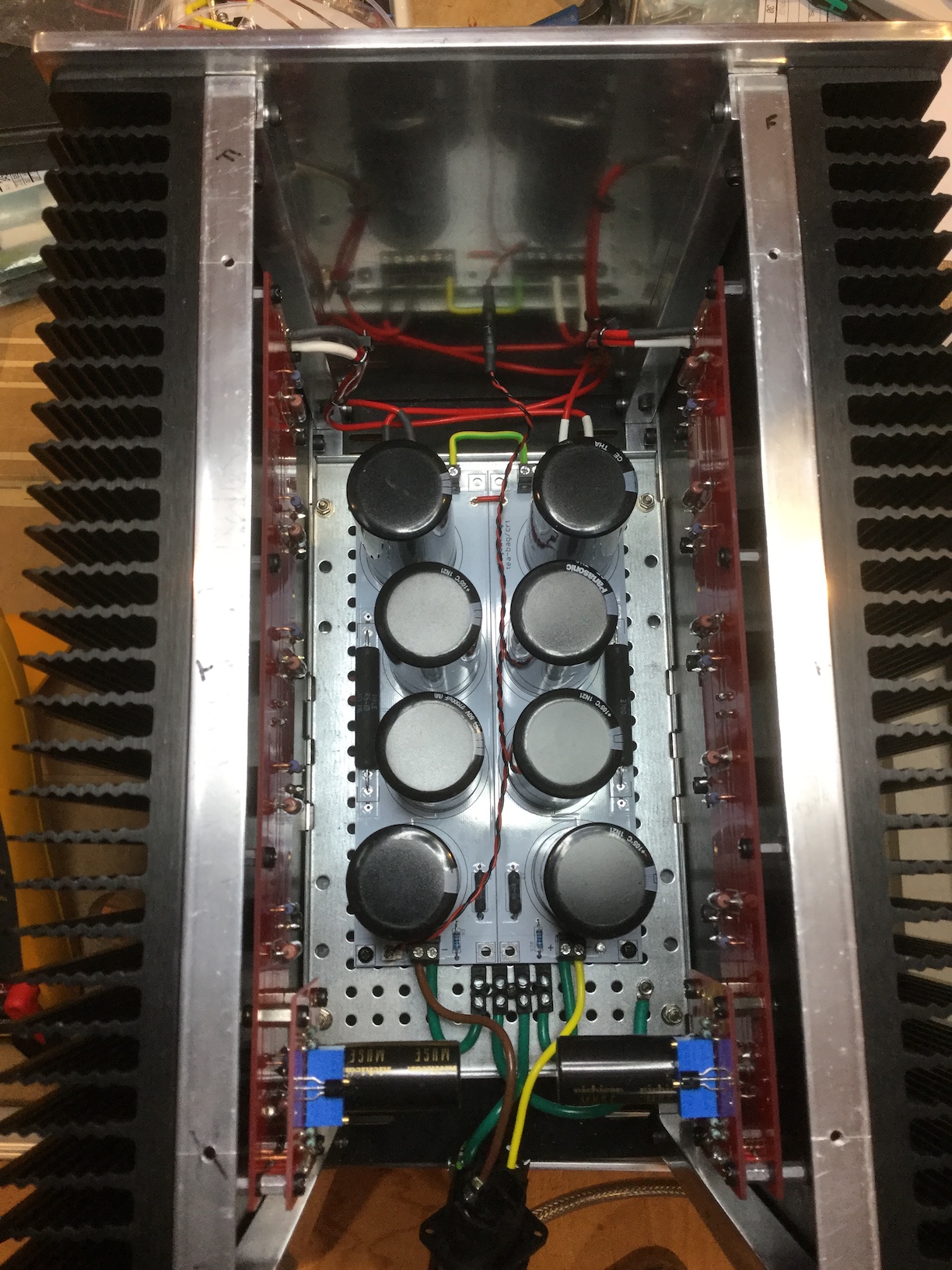

Help with Output DC Offset please
I'm building a pair of BA3-B monoblocks (complementary output pairs, 6 pairs per channel) and setting bias and dc offset on the output section.
The input power is +/- 25.2VDC, and there is no signal input or output hooked up at the moment.
Setting bias is straightforward and currently at 0.75A measured across the 1Ω source resistor(s).
The problem I have run into is that I can't get DC offset to zero by adjusting P2 on the bias board (I'm following 6L6's procedure in the BA-3 illustrated build guide). I am measuring dc voltage between "out" on the bias board and PSU 0V (believing that this is a proxy for measuring offset between spkr in and out), one side at a time. The best I can get is 48mVDC on one board and 109mVDC on the other. All parts are per the BOM except for a 2k pot at P2.
Am I going about this correctly or am I on the wrong track?
Why might the offset be so stubbornly high?
Could one put in a higher valued pot at P2 or increase R25?
Here is a picture of the internals of one channel.
Thanks,
-Keith-
Hmmm. Well, that is a good point. Both offsets are negative, measured with the common (black) probe on gnd, and with the red probe on “out”. P2 is turned down to about 0 Ohm, and increasing the resistance across P2 causes a larger magnitude negative offset.
Does that make sense?

Yes, both output sections need their bias boards. They won't bias without it. So for a monoblock, there will be one front-end and two output sections w/bias boards.
Bias is straightforward - set the bias of the front-end just like a F5. Once that's set, you don't have to worry about it again. Then set the bias of each output section, with it's own bias pot, and own offset pot. Because this is not a DC-coupled design, each section will set individually from the others.
Global DC offset will be bias balance between the two halfs (Phases). It will make more sense when you are doing it.
