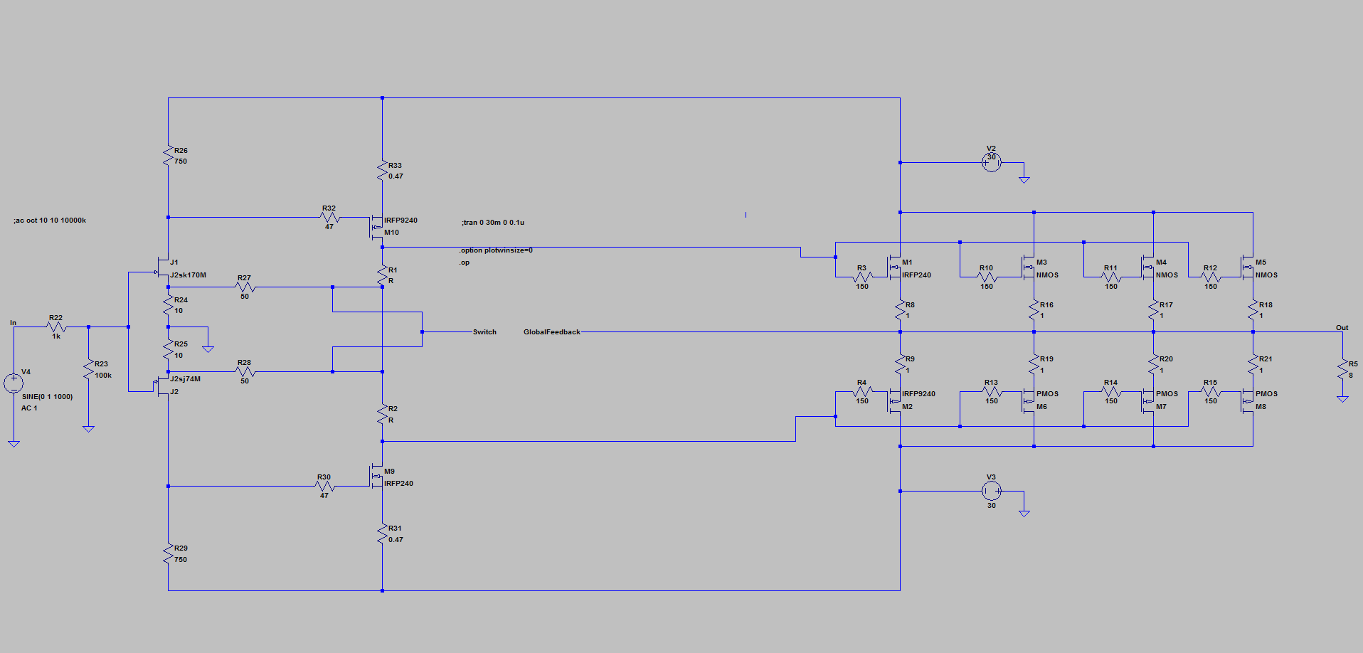

Just use a 2 pole switch or even a regular switch.
You don't necessarily need 2 wires at the output. You can just have one wire linking the ouput of BA2 to the dual feedback of F5. Then just switch it open and close.
With the feedback switch open (not grounded?) the output would see the open-loop gain of the amplifier. I think it would be far easier to compare the 2 different configurations as separate builds.
NO
The front end (ie F5) still has feedback.
I am saying extending a link from f5 output to BA2 output and just open and close that.
Maybe I should draw it

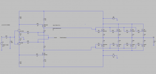

Here is what I simulated. I was lazy - only one output FET per rail and IRFP parts, just to get an estimate of the circuit.
Here is just to show you the feedback and where to place the switch.
The amp is not complete.
Just want to show you local and global switching idea
Something like that
