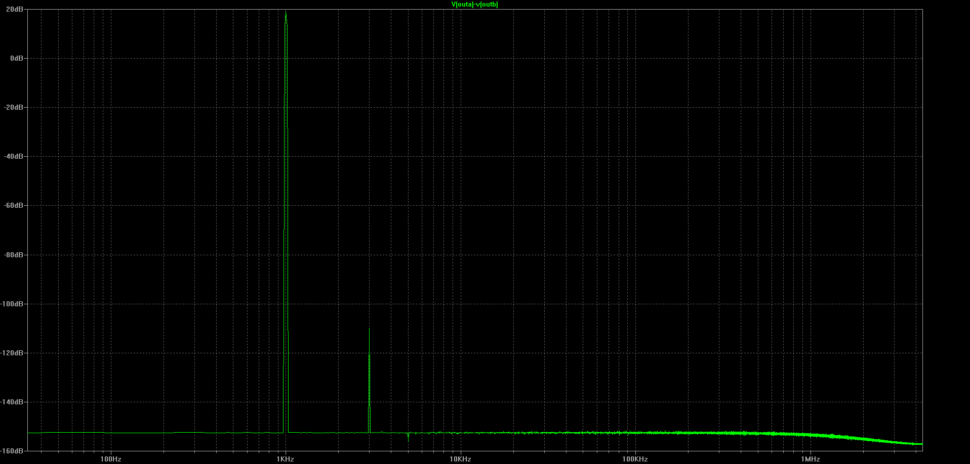

Is is heresy to consider 3 stage negative feedback in the PASS Forum?
I did a SPICE simulation of a low power F5 (using BA-3 output FETs) driving a BA-2 and negative feedback from the BA-2 output? Simulations look excellent, but it might be too much like a "conventional" production amplifier.
Has anyone sonically compared such an amplifier with the BA-3/BA-2 or equivalent balanced versions?
You could switch it in and out if you wanted to hear it
I am not sure how I could switch the negative feedback in and out without lots of poles on the switche. The biasing and JFET stage gains are totally different. I would have to look carefully to see if I could get an F5 to operate well in the BA-3 fashion with no global feedback.
I welcome your suggestions of how to do it.
Just use a 2 pole switch or even a regular switch.
You don't necessarily need 2 wires at the output. You can just have one wire linking the ouput of BA2 to the dual feedback of F5. Then just switch it open and close.
