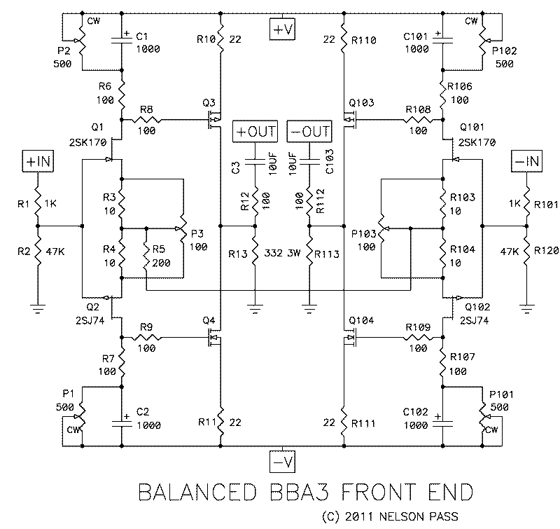

For those who were not at BAF 2011, here are the bits of my talk on the
balanced version of the BA-3.
Here is the schematic. Note that the two input Source load resistors have
been combined instead of going to ground.

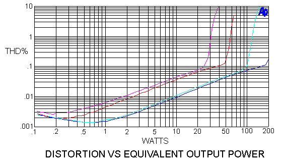

And here is the distortion vs equivalent output wattage for two values
of supply rails, and compared with the BA-3.
I think you can clearly see the lower distortion and higher power.

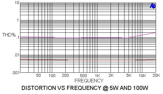

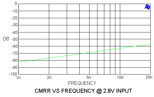

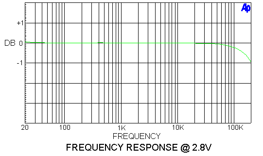

And here's the distortion vs frequency, frequency response, and input
Common Mode Rejection Ratio.
Ta daaaaa!

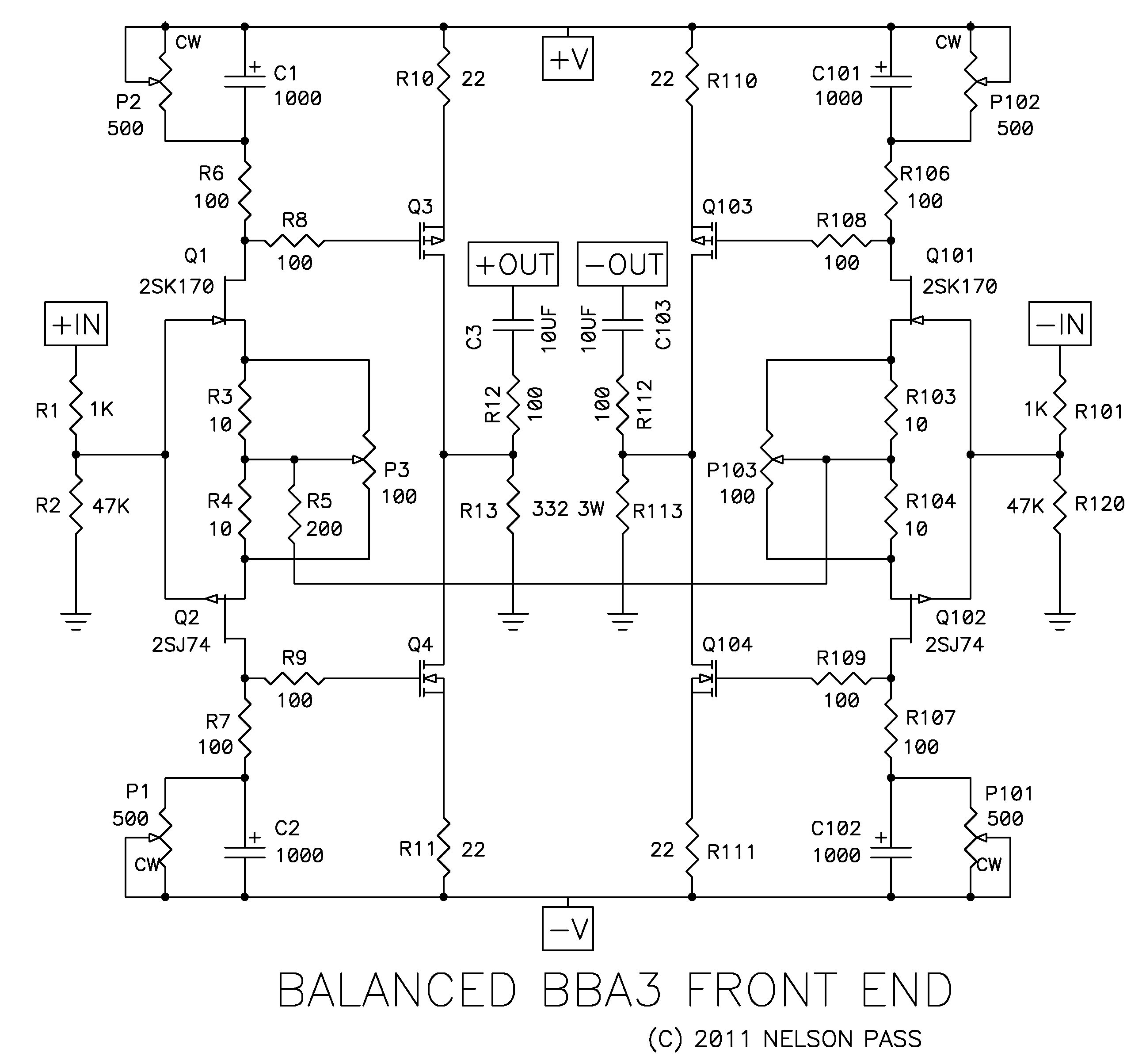

May I put on my image file format hat for a moment ....
may I put my Dunce Hat for a moment and say that any sort of file is good enough , when using it for good schematic ?
:rofl:
there are my two conversions , much neater in format , but I can't find them cleverer at all , than original one ........
:devily:
