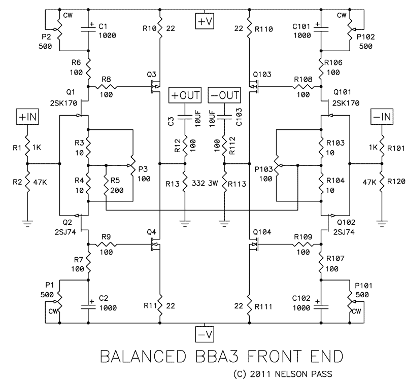

loading resistor , which is mutual for two mirrored halves , increases symmetry of output signal .
ya know - usual mumbo jumbo - just think about any out of phase garbage ....... ;
- what's happening when each half have own separate loading resistor , connected to gnd ;
- what's happening when that resistor is mutual (R5) ....

I would be interested in an explanation why it is useful that Papa connected the R5 in BBA-3 not to ground but together...? 🙂
Would you not want to be able to drive it with single-ended input?

nope ;
make it balanced all the way , as mono amp .
it will "just" have option to feed it unbalanced ( with FE acting as unbal to bal converter)
off course - if you make an option to cut mutual R5 and introduce separate one for each half , then you can have 2ch amp in same case

from manual
Coming off the Drain of Q1 is the loading network of R6, C1 and P1, and there is a comparable network of R7, C2, and P2 attached to the Drain of Q2. R6 clearly sets the AC load for Q1, but the DC requirements to bias up Mosfet Q3 are higher than that, so P1 in parallel with C1 provides a higher resistance value below about 0.5 Hz, and gives the approximately 3 volt DC drop required to bias the Mosfets.
well, Nelson clearly said if you use the parts specified
1000uf, wonder if size and type is important then 😕
but in paralel with bias pot ?
boy am I glad I dont have to understand it 😛
from manual
