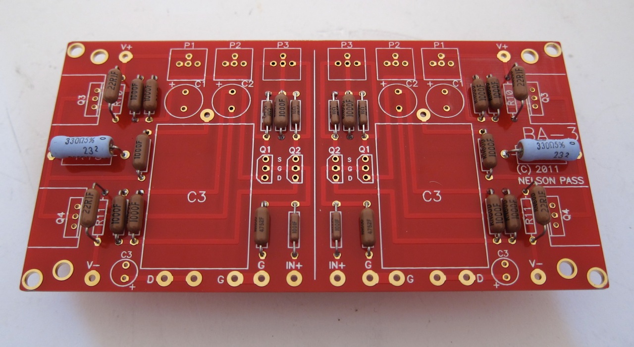

Click on the link I gave for the Elna catalog; p. 169 to 171; gives the dimensions for the silmic caps. Yes, I'll be using the Audyn or Clarity Caps (PWA) for the 10uF. I want to the 1000uF silmic for C1 and C2. See attached photo. Not my board; don't have them yet.
But I thought you said that you measured 7/8" = 22mm for C1 & C2. If so, then a 16mm diam 1000uF silmic cap should fit on those pads (50V); see it on p. 169?

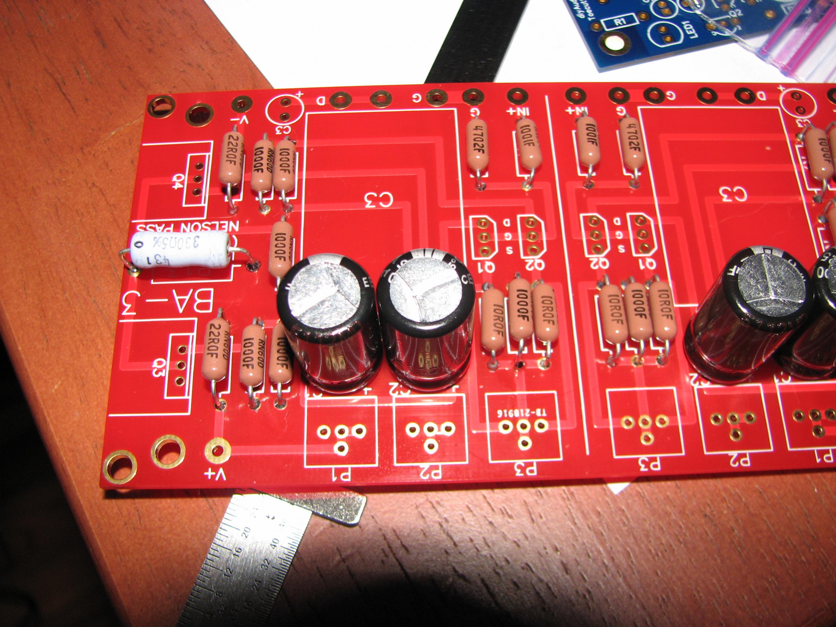

Im sorry, I thought you meant the small C3 pads next to V- and V+! C1 and 2 measurements: legs are approx 5.64 mm apart, cant see silk as cap installed, my cap is 12.79 diameter and approx. 22.18 mm tall
Some use a 10uF silmic in the small c3 pad and a much smaller, sa .1-1,0 film in the larger C3 location...that would lessen the height of the fat 10uf Audyn.
No, I want the Audiyn 10uF polyproplylene; I think they will sound better than E-caps, bypassed or not. And to play safe I will go with the 25V silmic for C1 & C2; the 35V might not fit. But I don't understand why you would advise stacking the BA-3 boards vertically (on standoffs) inside the 288mm chassis. With the 4 Goldpoint pots, input selector switch and RCA jacks two pairs of + &- reg boards will never fit in there. Do you mean just making extra room for a pair of 470uF caps per rail per BA-3 board?

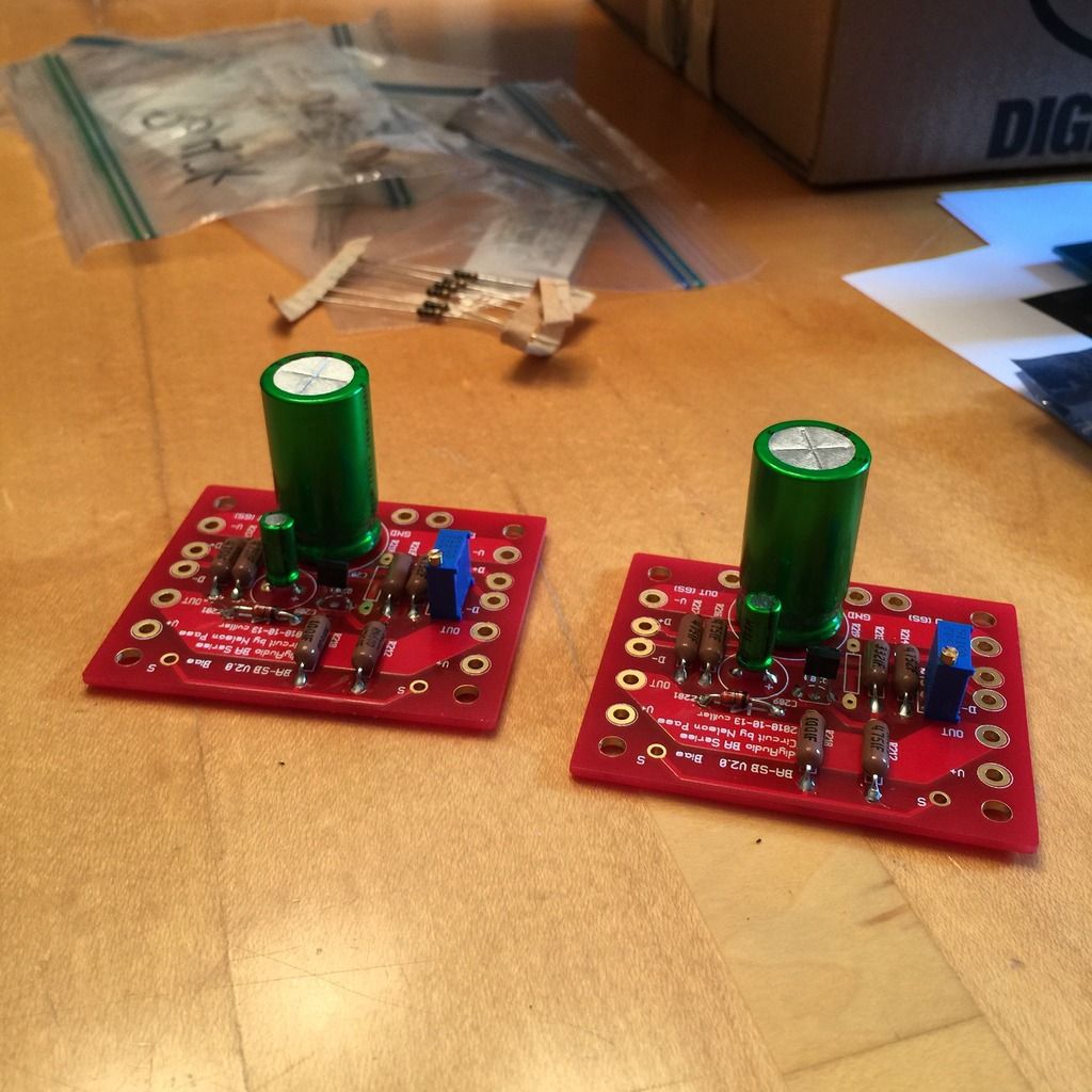

I just finished my single-ended bias boards last night. I'm a little disappointed though. The same 1000uF 25V caps are called out on the bias boards and on the FE, however, on the FE the space to put these caps is WAY smaller than it is on the bias boards...so either I work some magic to get them to fit, or order smaller diameter caps. I used Nichicon Muse ES series. From the article, I left out R219 as it says to add it later if I need to bias more.

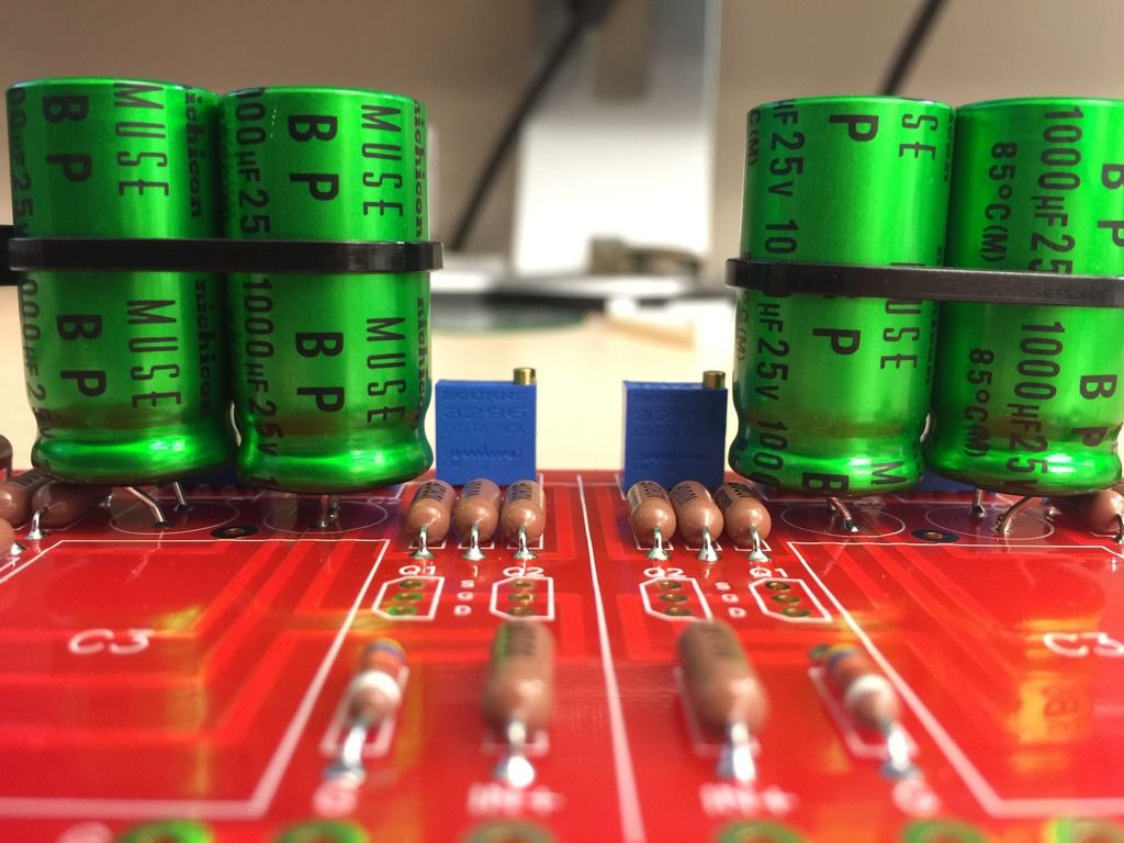

Nichicon ES is a bipolar cap, correct? That's why it's so big. Is it OK to use a non polarized cap on the bias boards and front end? I used 50V/1000uf nichicon KZ on my front end boards. They did not fit...I zip tied them above the boards.
I did some quick searching, and it seems that bipolar caps are typically used on actual audio signals, but should NOT be used in power supply areas, like on the PSU. If anyone can let me know on the caps, that would be great.
In the case, I did some fiddling with the leads and was able to fit them:
I am pretty sure a bipolar cap in both those locations is a bad idea but I was hoping someone smarter than me would chime in before I went ahead and said that. Typically, bipolar caps are used in AC coupling situations only...

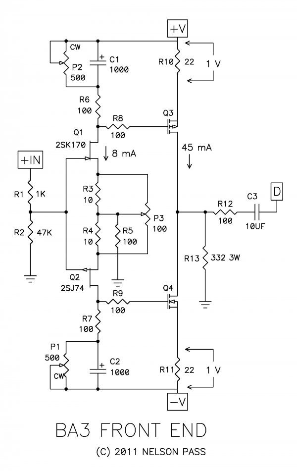

Here's the schematics if any one wants to take a look. The caps in question are C1/C2 on the front end and C101 on the output stage.
