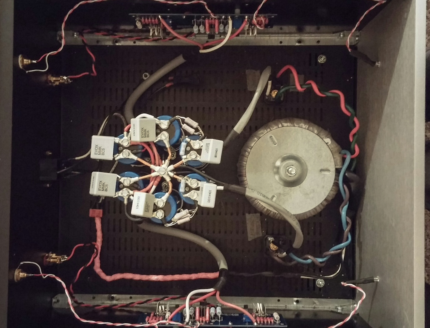

I've bypassed the power caps on my F5 with 10uf poly caps. I have 6x33,000uf caps in the psu, each one bypassed with a 10uf poly cap. Actually, the last caps on the rail are bypassed with a 10uf poly, a 4.7uf poly and a .1 polystyrene cap.
I thought the sound improved with the bypass caps. No joke...it got smoother and more fluid. I don't have measurements to support this, just my ears.
