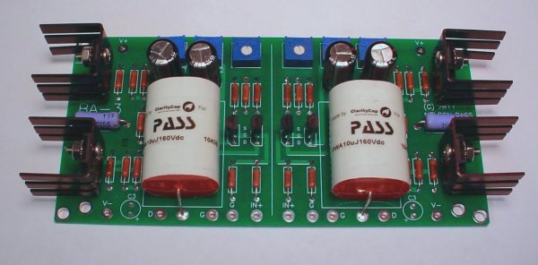

Can someone help me ?
Where i can find the BBA3 PCB like this ?
I need 2 SET " Green " PCB
Please PM or Email me
Best Rgds

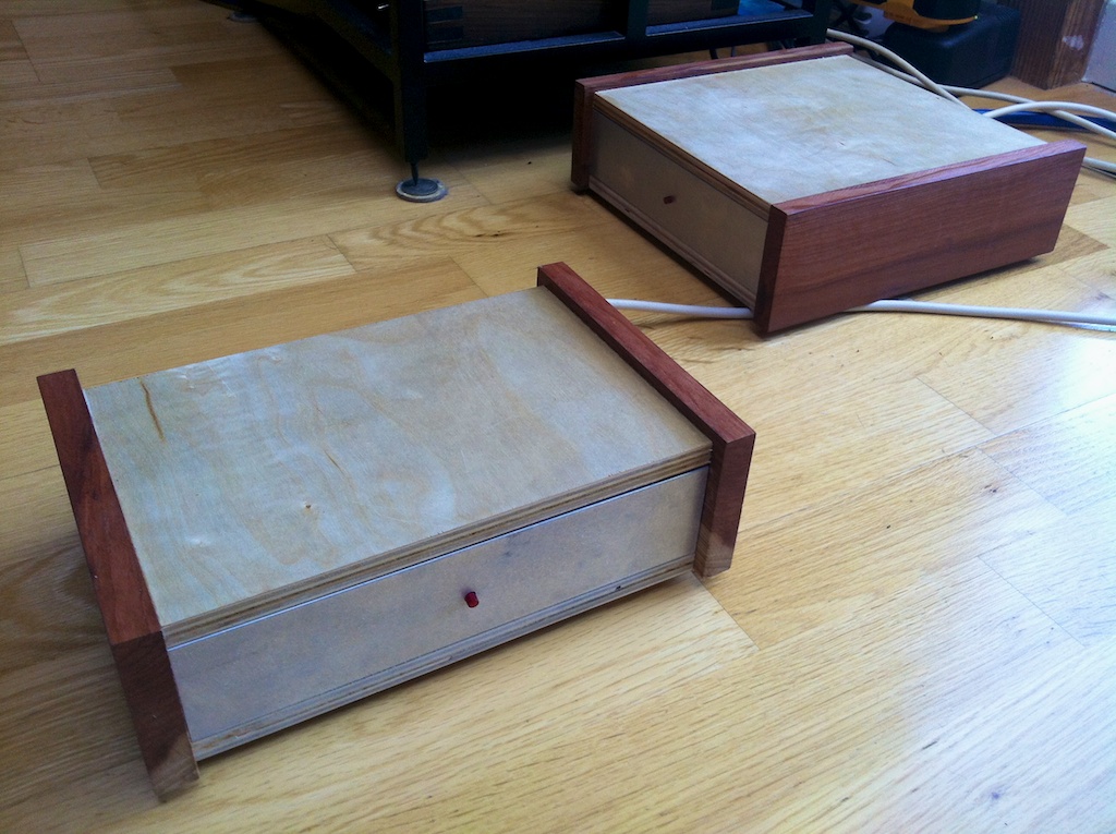

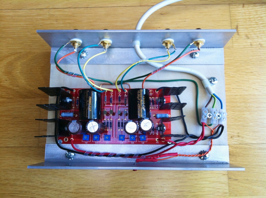

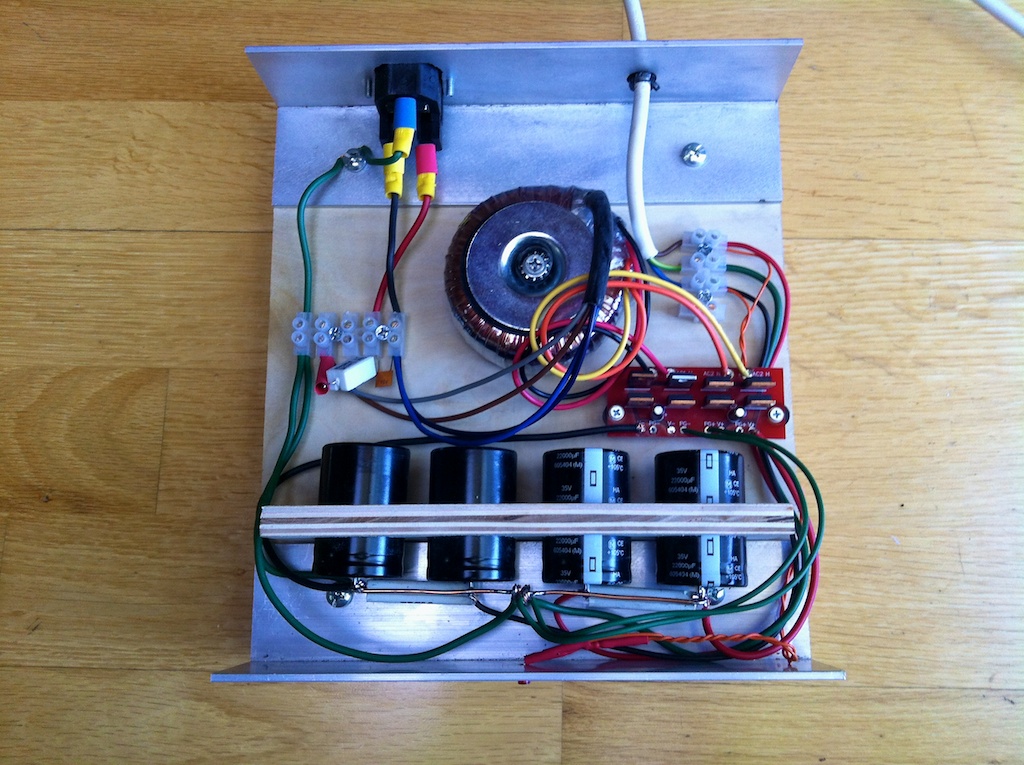

First picture is of the two units closed; second is the BA-3 and third is its power supply. The BA-3 is configured as a gain stage, following a passive preamp, and preceding my stereo F4.
tim
