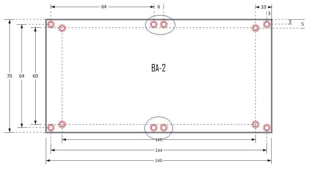

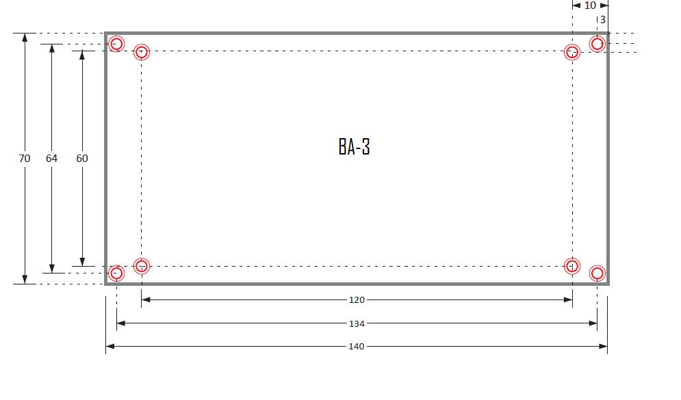

I have a BA-2 and was thinking of trying the BA-3. I have separated the PCBs for left and right FE for my BA-2 and I would like to do the same for BA-3 to be able mount them in the same place using the same wiring. When I checked the pictures of the BA-3 boards in the diyaudio shop I noticed that they do not have mounting holes in the middle. So if I separate the left and right FE I will only have mounting holes in one end of them. Is this done by purpose? Is there a reason why one should not separate left and right PCBs?
It just got too difficult for Papa to fit everything in and we didn't think many people were cutting them.. .. As far as I know, there is no reason not to cut them. Using 2 holes on the side of each piece is probably enough. and there's a line to help guide your Dremal tool!
Which of the corner holes are you using? the ones in the extreme corners or the ones inboard a bit?
Thank you for the quick answer Variac. I am using the holes in the extreme corners but maybe I should use the other holes for the BA-3 to get a little better force distribution?
I think either way will be fine, but I guess the inner holes would be stronger.
But bolting them right in is pretty appealing, right?
