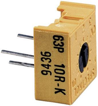

For those of you who have built the BA-3, what part did you use for the pots? I cannot find anything on mouser and digikey that is similar to what Papa has shown in the article.
They may be obsolete ..... I found only a yellow single turn looking at Google for Vishay and pictures
here is an example

I personally do not like the single turn pots. Multi are much easier to use and adjust and will fit the board just fine. BTW. I have single turn on my boards and when i got to balanced, I will be switching them out.

It seems that the pots in Nelson's picture are single turn ...... Of course I like the multi turn also more, but ra7 was looking for the same type so I wanted to help him....😀
I ordered some from Farnell in the UK which appear to be the same as in Nelson's photo. I think they were 0.5W
Order code: 9355014 (100R) and 9355103 (500R).
I know you were just helping, i figured i would throw in the multiturn suggestion. I have been in the situation too many times where i didnt think beyond what was on the page in front of me.
