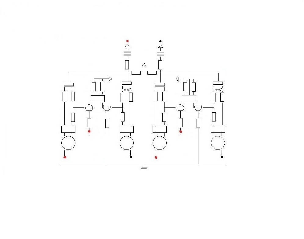

btw, genuine star ground means that every gound connection in the whole amp curcuit all meet in one and the same point, on the amp board
The first part is correct. "on the amp board" is irrelevant.... The single point is what matters, it's still a star ground if the single point is in the next room...

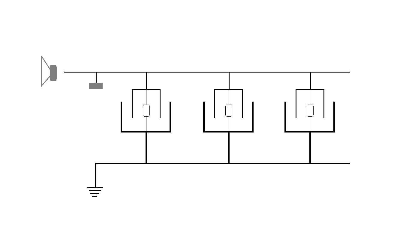

Yes. The whole point of the power supply caps is to minimize the noise between power and 'ground' so the cleanest ground will be the negative terminal of those caps.do you really want to place it directly on BA2 power supply caps ?
You do not want the chassis (box) to be the ground. Chassis should be connected to ground through a non-zero impedance, as shown in the schematics.or even worse, at bottom plate of box
The point of star ground is to minimize the potential of various "ground" references in a circuit. Every wire has impedance, and current is always being conducted towards ground, so as more impedance combines, the higher you get above ground. Chaining one ground to the next is a sure way to get further from ground, because each step adds mV. Star ground avoids this by having each ground connection go directly to the source, rather than chaining from some other ground that may have a voltage rise.calling it star ground is simply rubbish, and wrong in my opinion

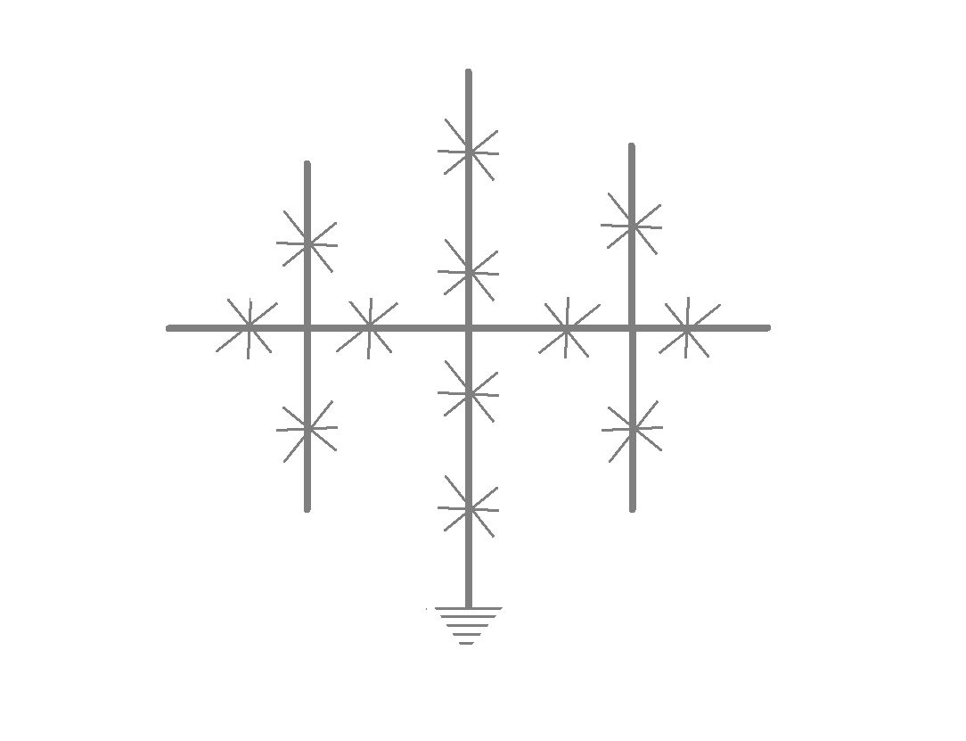

before this I also said that there is no 'single star ground'
but that there can be multiple 'star ground' in a system
now after we have this debate I googled googled the subject star ground
and now even more convinced I am right about this😉

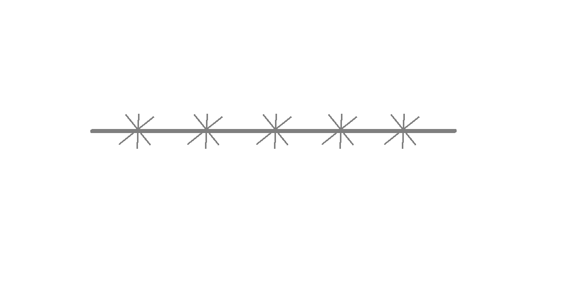

no matter how you do it, your 'star ground' scheme will look like this
if you consider the whole setup
the only choise you have left is what goes where
and that is basicly what we are arguing about
I have now found its called multipoint ground

If you look at Nelson's circuit diagram for the power supply you will see that the star ground is shown clearly. I have copied this layout (using a circuit board from Avondale Audio) so I have one ground connection from this star point going to the black speaker output connection and another to the BA-2 front end. This setup produces total silence.
Looking at the current setup with the voltage regulator I am now intending to connect the ground of this reg to the same star ground on the main power supply. Fortunately I have room on the power circuit board to solder this in place to the star ground but I can see for some they would not have the room to do this and therefore would need to have some form of staggered ground or multi-point ground. I think more importantly than putting all connections to the same point is that the connections along a multi-point ground are made good with minimum resistance. The ground wire which was connected to the front end of the BA-2 will now be connected to the ground of the BA-3. We shall see if this is successful when everthing is up and running.
