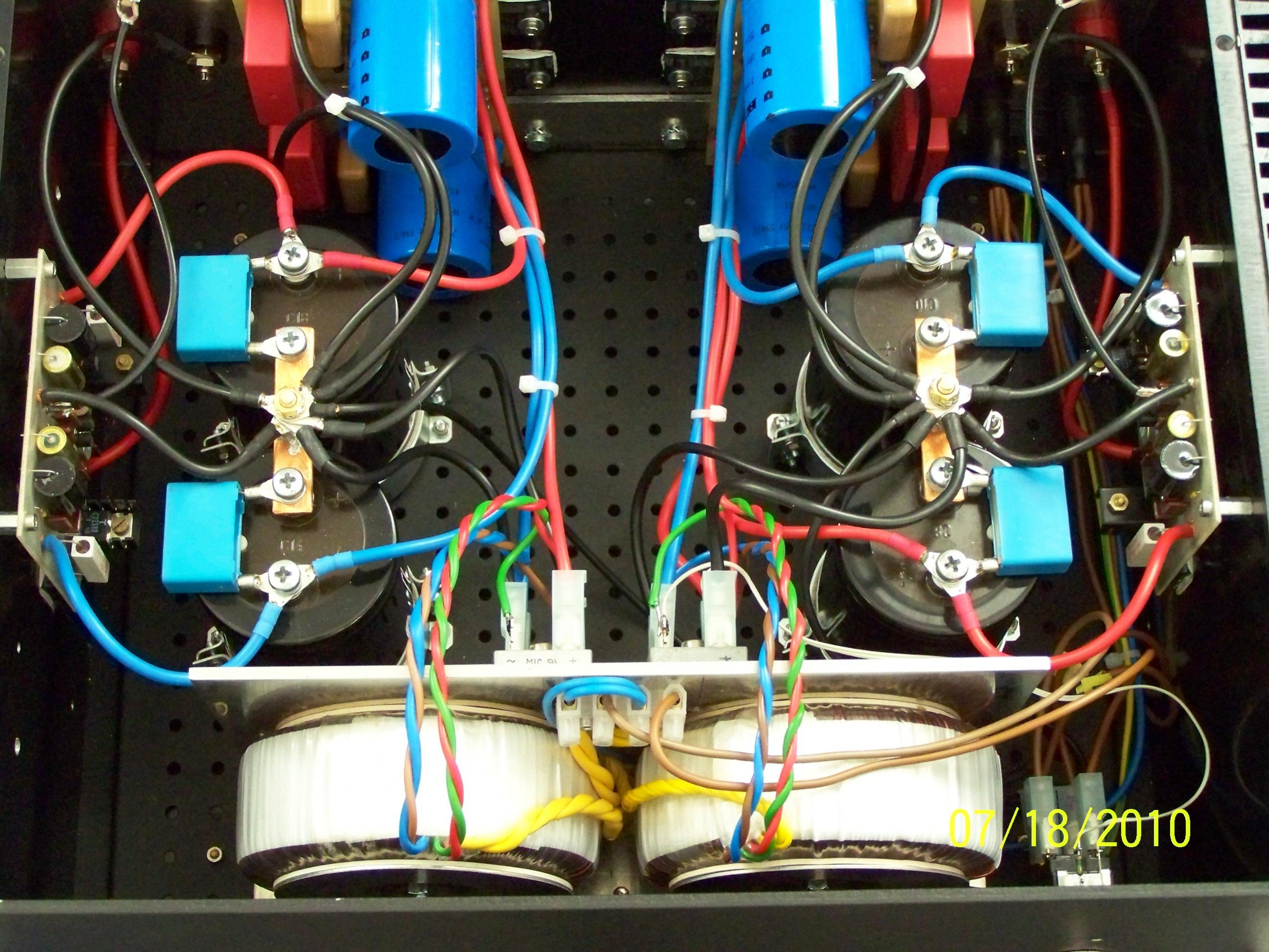

Star grounding is always practical and preferable. This is a dual mono Hiraga 30W Class A. It has one central zero point per channel, where all grounds meet except of the the input grounds. Both star groundings are connected to the chassis via thermistors.
It is dead silent.🙂

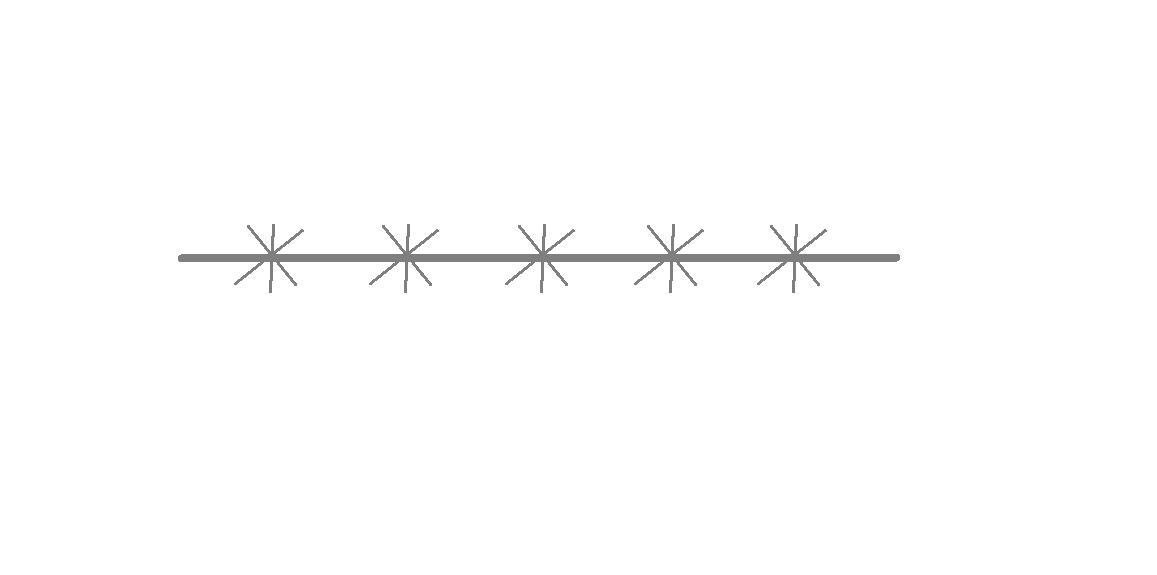

genuine star ground is a special 'theory' where every ground connection goes directly to the same point, thus called star ground
its just not very practical
look at your ground connections like branches on a tree
so, what you have in reality is multiple star grounds, connected to each other

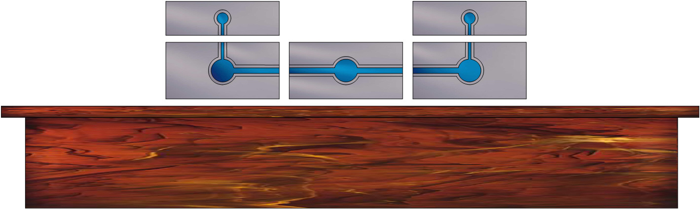

hmm, are you taking power from output amp trafo, or using smaller seperate trafo fore regulated frontend supply ?
but basicly, its a relation of how much current the actual curcuit draws, and how thick the wire is
multiple units could cause problems tho
I would claim that if connection between negative speaker terminal and amp board ground is used fore all ground connections, then it would be very safe, and hard to mess up
preferably placing the connecting grounds closer to amp board rather than speaker terminal, ofcourse
in other words
you have two possible BIG 'ground strings'
either the one between big power supply and amp board
or the 'ground string' between amp board and speaker terminal
Don't understand what you mean. There is only one star grounding per amp at the power supply. Only the input grounds pass the amp boards. I do practice this since about thirty years in all my audio equipment - preamps, filters, power amps - and it has always been working perfectly.🙂

btw, genuine star ground means that every gound connection in the whole amp curcuit all meet in one and the same point, on the amp board
the way you show it has always been common practice, and used fore ages, long before the word star ground was invented
essentially 'star ground' relates to how the amp board layout and its curcuit is designed
as far as I know, but maybe I'm wrong
like I said, it will always be multiple star grounds connected to one string, no matter what
the only choise you have is to choose which goes where
and each can have only one connection
but if you begin to look at it like one single star ground, that's where the trouble starts
I still don't understand. There are two separate amps in one box with separate supplies each = dual mono.
