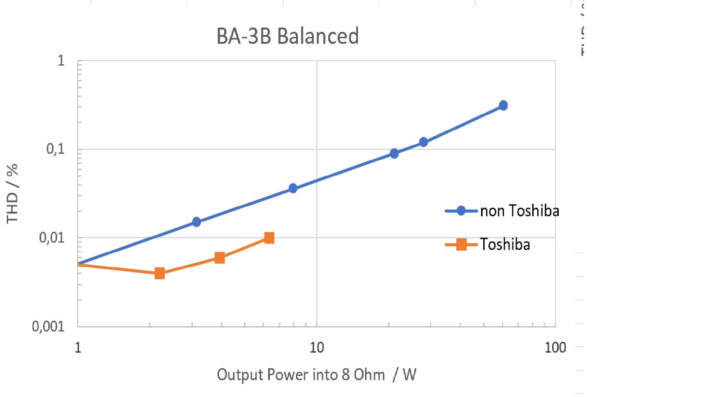

I could add:
3: SE I could hear a little difference. Balanced I could hear and measure a significant difference.

Toshiba Mosfets+Jfets were totally worth it for me. I cannot say if it were the Jfets or the Mosfets that made the difference. According to ZM its the Mosfets.

In SE i heard a bit more clarity and detail. I guess it gets overwhelmed with the drekload of H2 from the complementary output stage in my case, so the difference is small single ended.
In bal. I heard much more detail and clarity and less harshness. Unfortunately I measured before listening so might have been biased. 😀
The price for the Mosfets is much less than what I splurged e.g. on the caps and the benefit much greater. 😉
