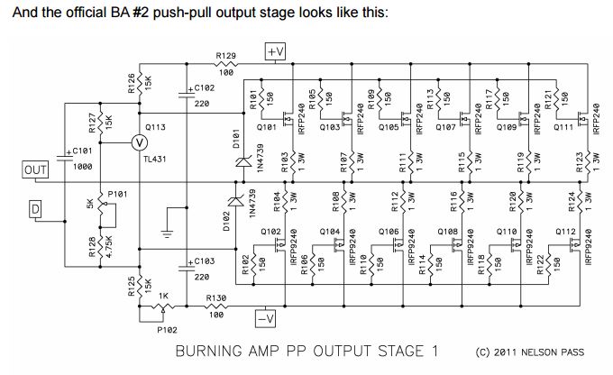

Hi, my BA3 has started to sing few minutes ago.
My case is a 4U 300mm, Output bords are P-BACO, bias 0,2V and stable offset around +/- 0,2mV, dual mono 24V PSU.
I just check, my sinks are almost cold even after almost 45min. How high can I rise the bias ?

What value are your source resistors?
If 1ohm then you only have .2A running through each mosfet. At 24V that is under 5W per mosfet.
With 1ohm source resistors then you can at least go to .4V and have 9.6W dissipation on each mosfet. That should give you some heat on the heatsinks.
