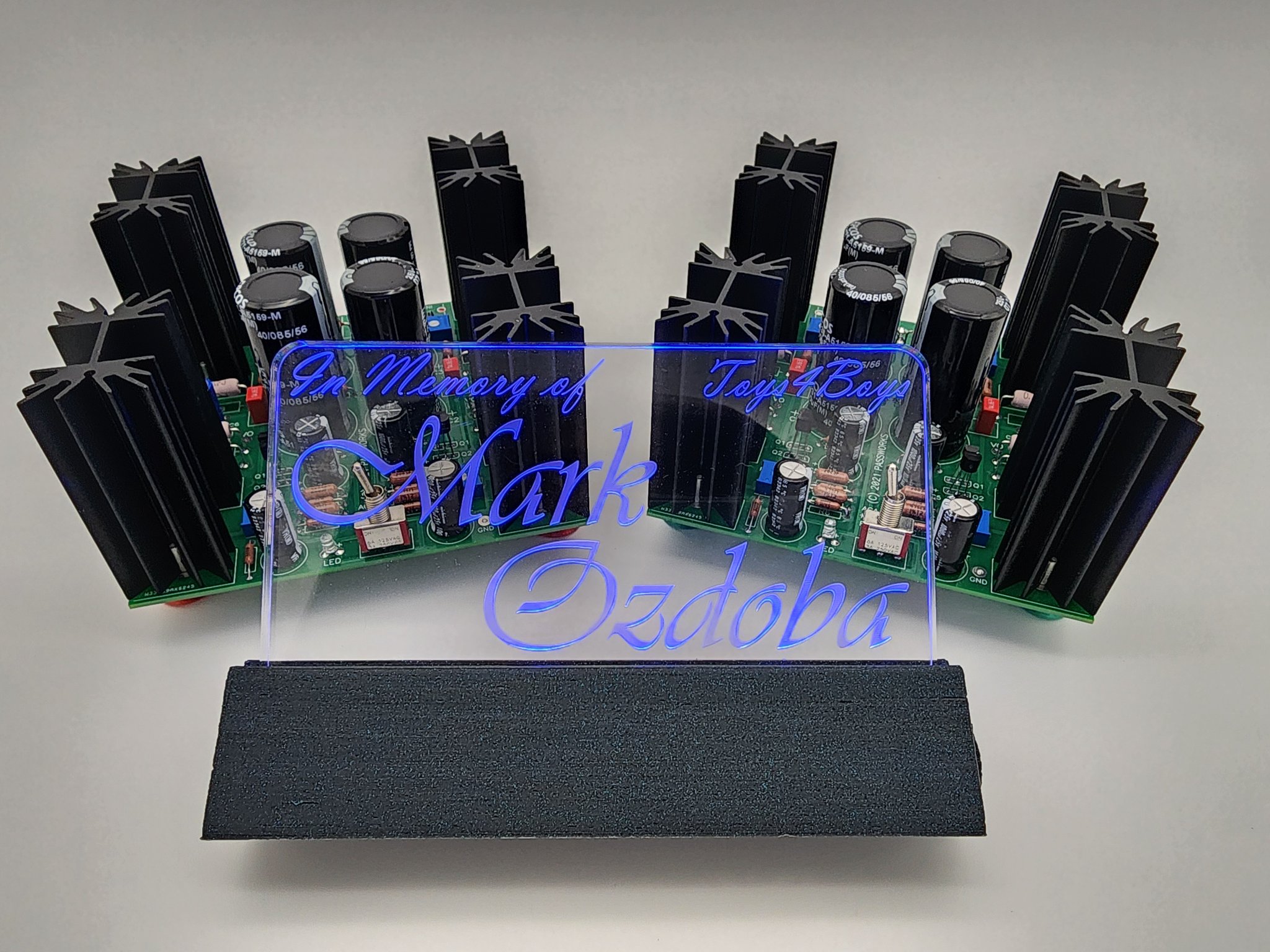

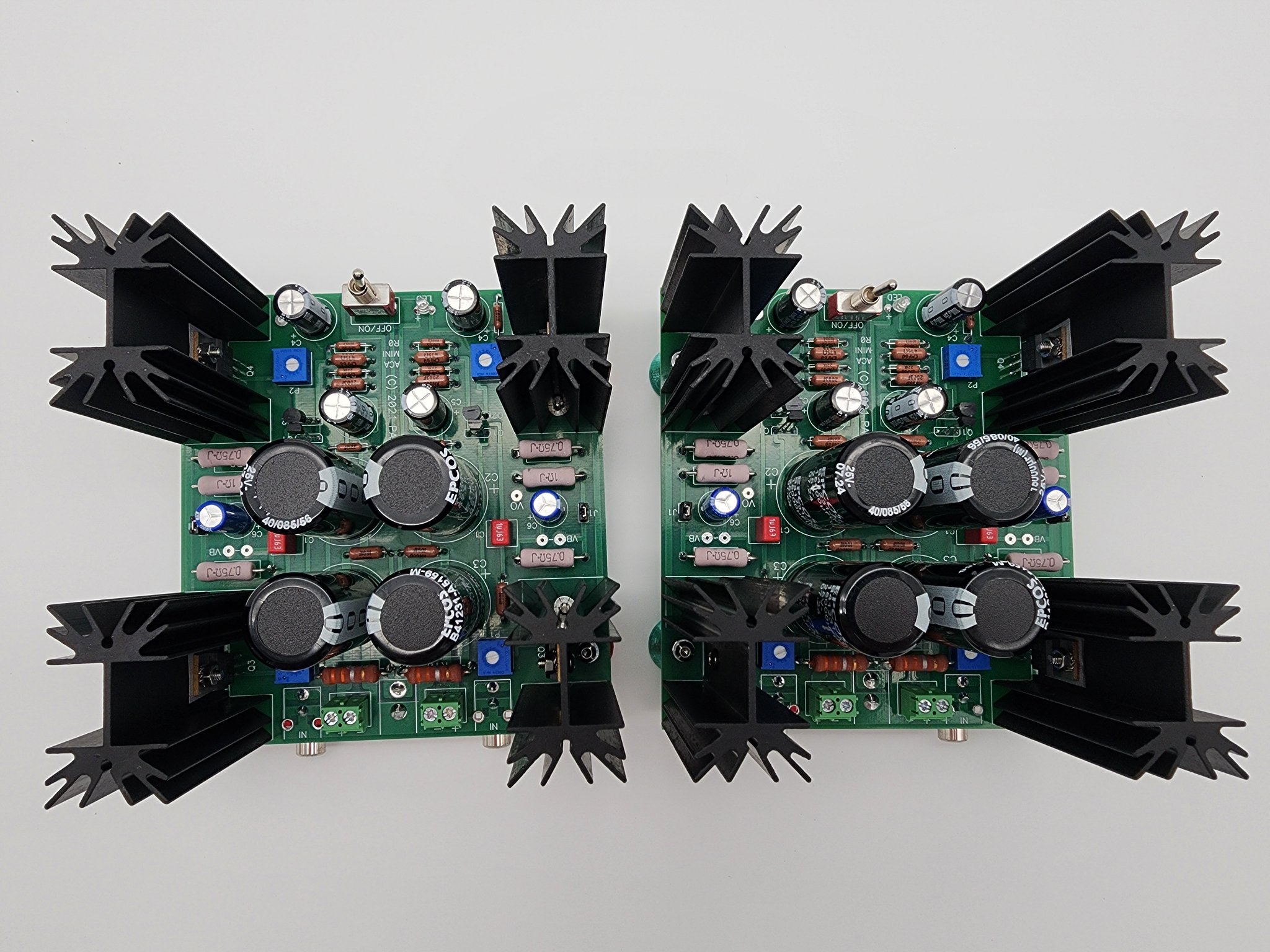

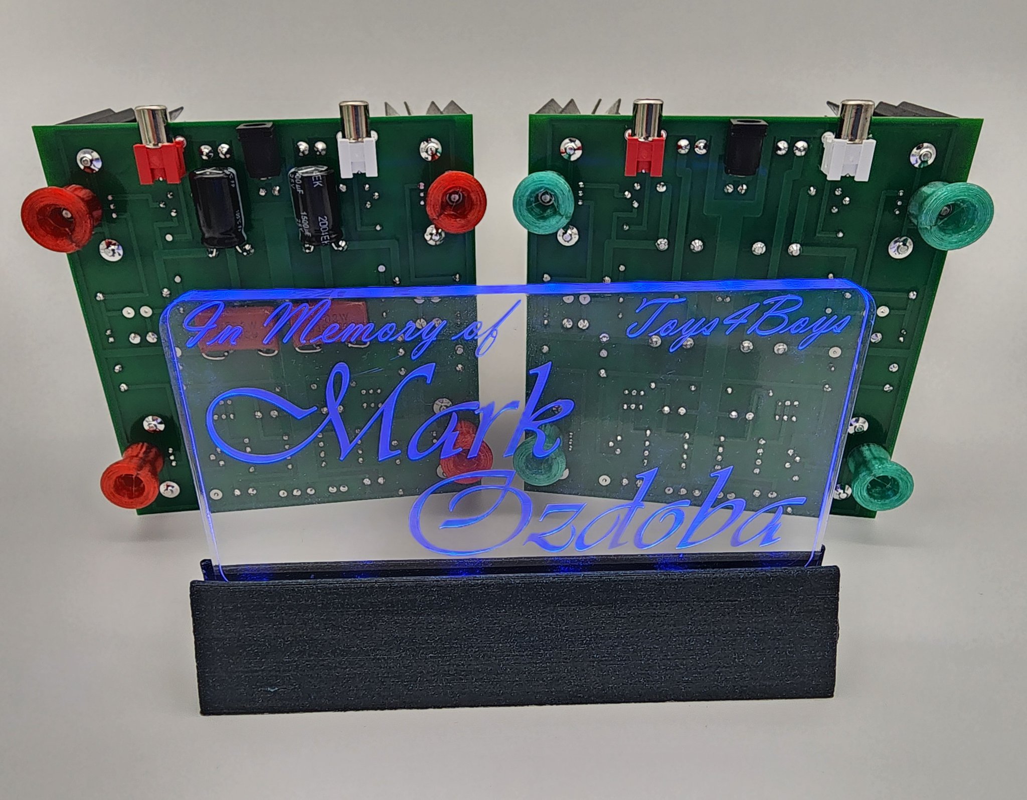

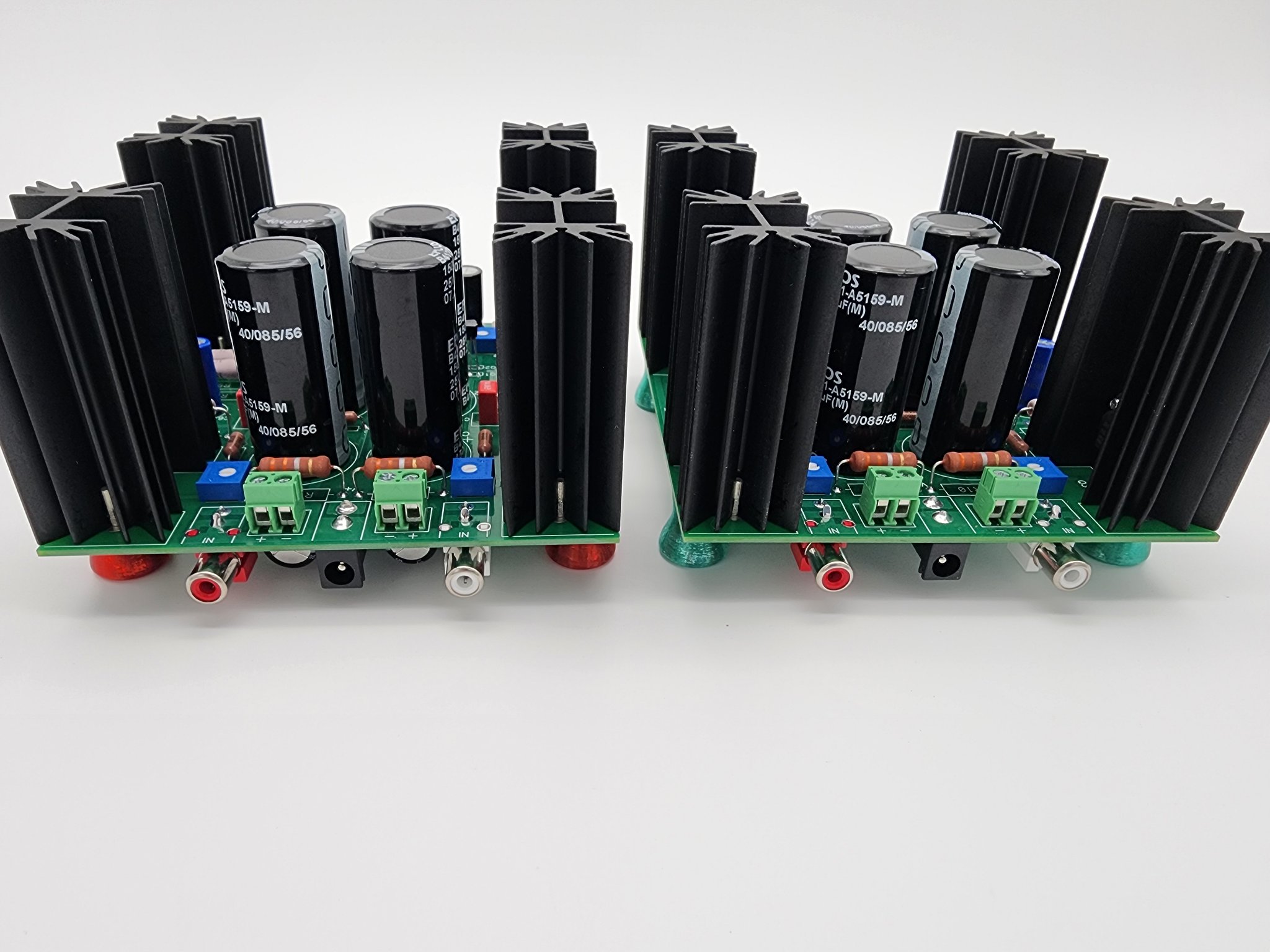

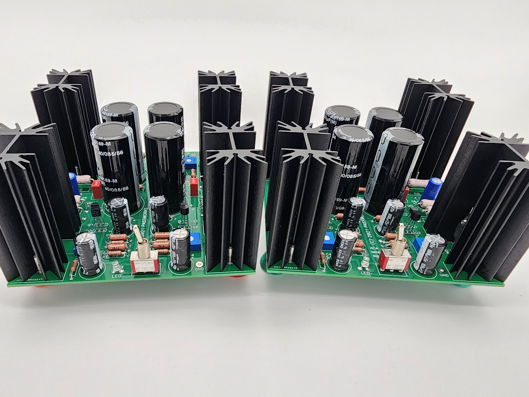

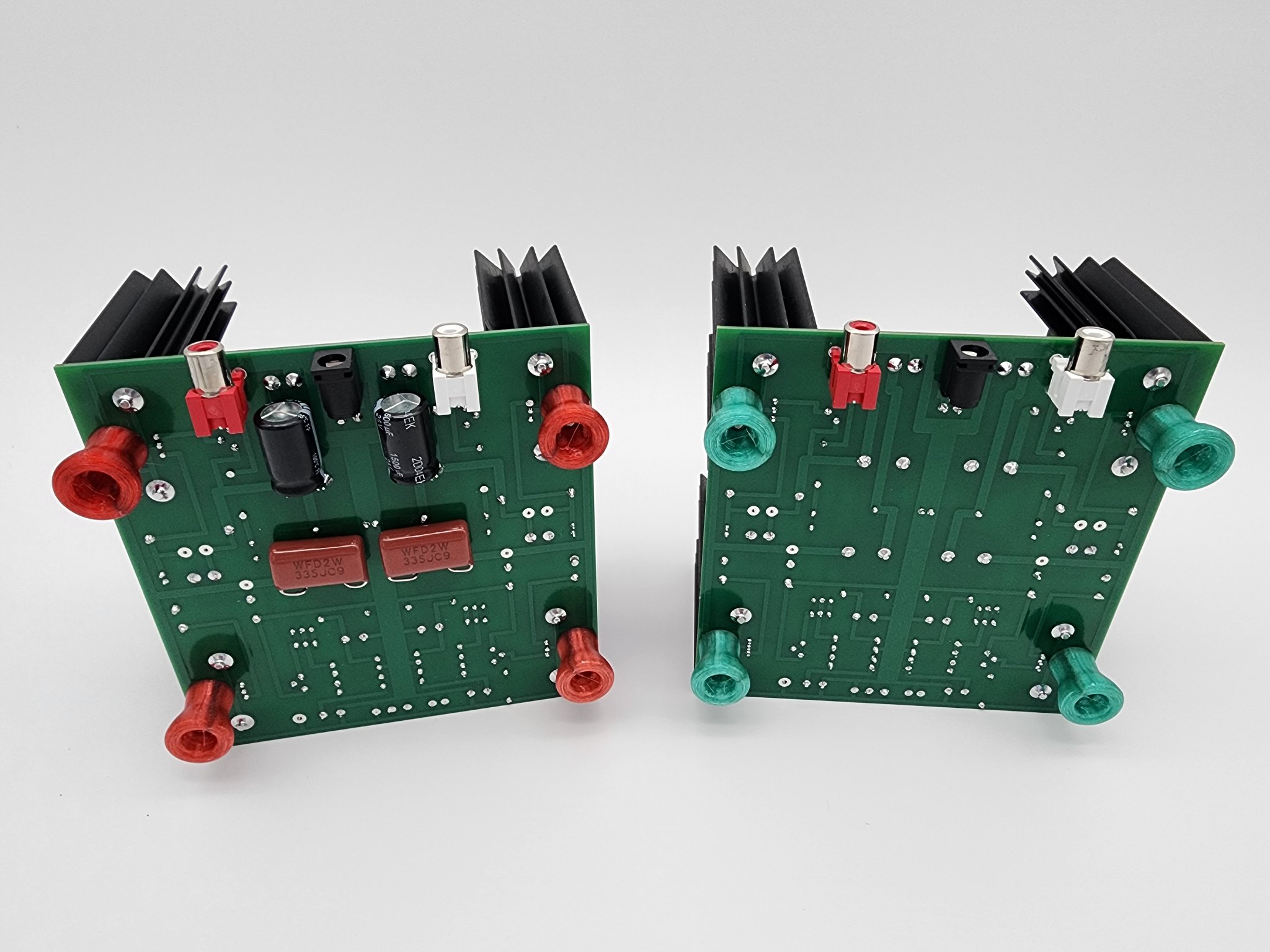

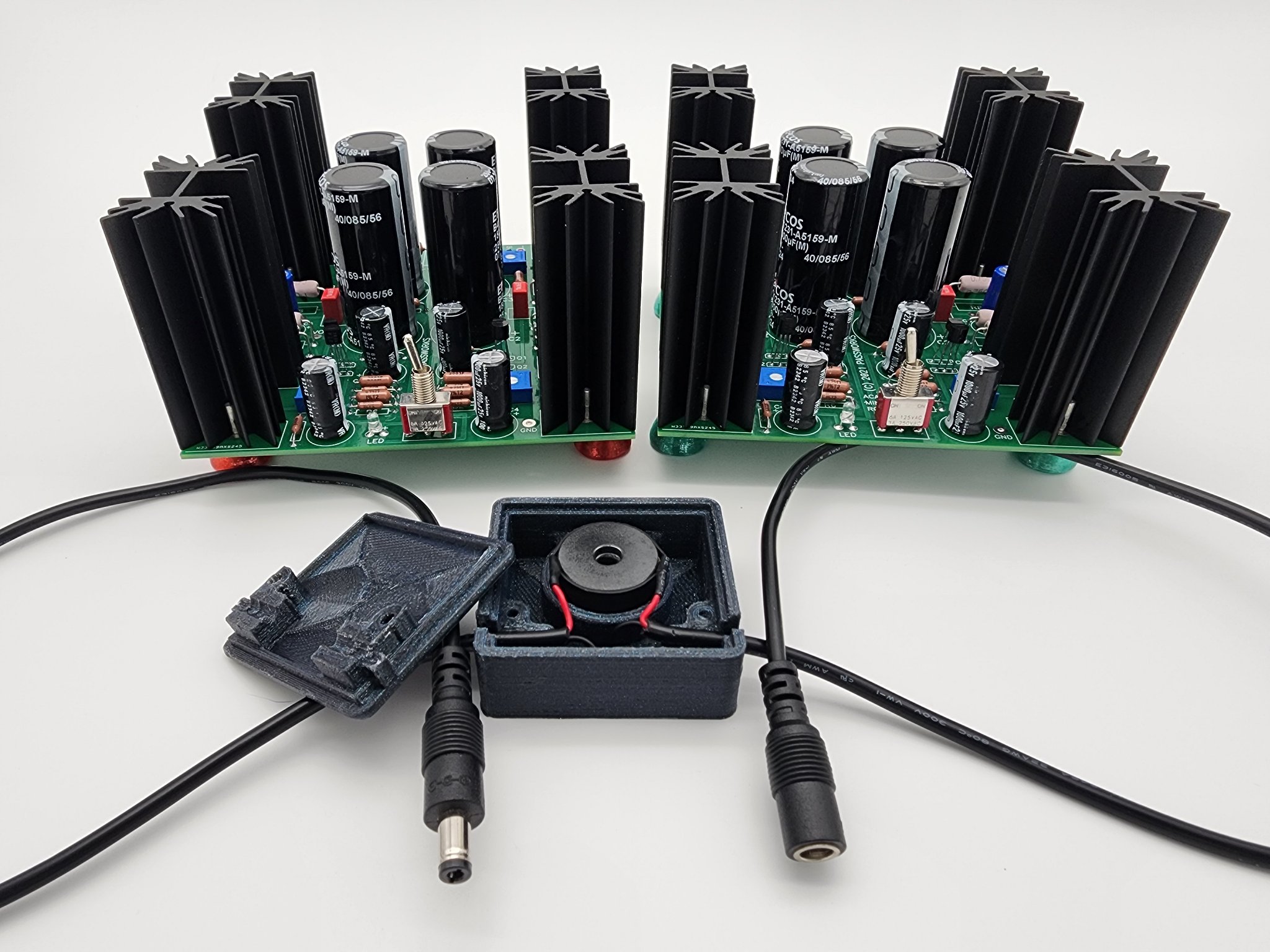

Speaking of two amps, I'll be bringing two freshly finished ACA Mini's to do some AB testing with anyone's speakers who are willing. One is stock build and the other has @ClaudeG modifications. Otherwise they are identical builds (ok, the 3D printed feet are different colors).
After doing some AB listening Saturday, they will be donated in memory of @Toys4Boys (Mark Ozdoba) to the event (raffle or auction based on preference of event hosts).
Both have had music played for a little over an hour and they both sound great even on my cheapo test speakers. They each include a 5A SMPS PSU (not shown).
Details: Cardas Quad Eutectic Solder, Vishay Dale Resistors, All resistors lifted off board, custom 3D printed feet, both biased per article to 0.3V for Vb and 11.5V for Vo. Boards were cleaned top and bottom thoroughly many times during the build with MG Chem 413B (they are shiny clean).
