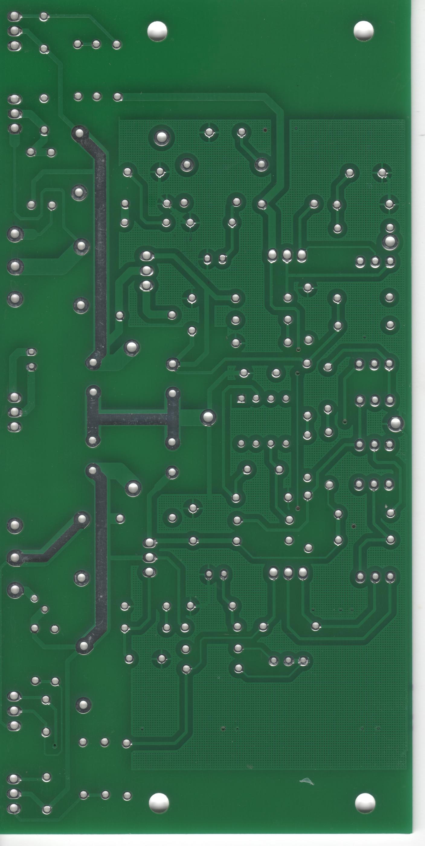

The PCBs are of a good weight and are well made.
Any comments about the layout or design ?
Building these is fairly intuitive, just as well as there are absolutely no instructions.
There are two test points marked TEST. You have to reverse engineer the board to discover that they are across the upper emitter resistor.
The bias current is 200mA but with the wrong resistors supplied.

Studying the schematic against the component count there are a few questions.
I'm presuming that LD5 and LD6 are the two CCS semis fitted.
LZ1, LZ2, LD7 - 10 are the zeners fitted.
How has the vendor got rid of the diodes between LQ6 and LQ7, there are no other diodes on the board.

Output voltage vs supply rail.
Hi, i also have this amp.
My supply voltage is +/- 40v but the output signal is already distorted at +/- 30V. This means you loose 10V on each side of the supply rail. Does someone have any idea why it is this high? Some volts is ok, but this is to much.
I had to place a 22pf parallel on R25 (27k) according to the circuit in this tread.
otherwise i had some ringing when a square wave form is connected to the input.
