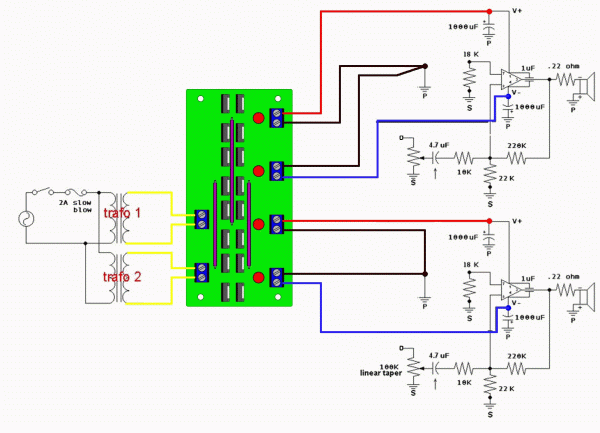

carlosfm said:
Yes.
The problem is the two 0V wires.
In fact, it works MUCH BETTER if you join the grounds of the two channels with a very short (but thick) wire and then run a single thick wire from a midpoint of that short wire to the 0V point on the PSU.
No more noise, just complete silence.
This is new to me.
How come this circuit recommends seperate 0V wires until star ground? What's the idea behind it?
I did as on the circuit and does not have any noise.

That schematic is for one channel.
For two channels you should have two transformers.
With only one trafo, just do as I say, it's better.
Put your ear on the speaker and take the volume to the max.
You'll hear some noise.
If you make as I said, you won't.
2Bak said:
This is new to me.
http://ampchipdiy.com/invertedLM3875_r2_1.gif
/Jan
By doing that you are crating shorter GND loop, so less noise. Don't forget that the GND of the L and R chanels are connected together at the source. As Carlos mentioned it's valid only for 1 transformer for the two chanels setup. With 2 separate transformers (secondary windings) it doesn't matter.
2Bak said:OK
I understand.
I have two 250 VA trafos with single 26,4 v secondaries. Do they count as one trafo then?
In the sch you have, the two trafos are connected as one trafo configuration. Only if you have separate GND for L and R canel. In your case it's the same GND point for both chanels. If you had two trafos with 2 secondary windings each, than it doesn't matter.

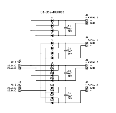

2Bak said:schematics
Hold on. I'm confused now with this one. I have to think. Sorry.
I'm not 100% sure, but because the separate bridges it might not be as sensitive to the GND connection, but I'd still do what Carlos suggested, just in case. Do it both ways and tell us if there is a difference.
One transformer two channels
... ok, so where the ground point is ? Is it at the bridge or at this short thick kable ? I mean where is the place where the two polarities (+) and (-) are joined ? Is it on the bridge, i.e. only one cable connect the ground to this "center single thick wire", or is there two cables from the bridge and they are connected right at this "center single thick wire" to form GND ? ... or doesn't matter ?
