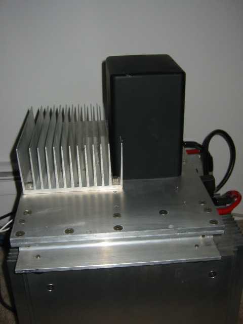

It was a rainy day, the game was off because of it, I had the samples LM3875 so I caved in and built it.
I put together my 7-component GC today using what I think is Peter's schematics. Since I had a trasfomer with 2 CT secondaries I did a dual mono. The rectifiers are standard monolithic bridges digikey stuff. For PS I used 20 Panasonic FC 2200/50V/chn. The input cap is the N-type BG 4.7/50V

The Gainclone is "now playing" it's really heavy pics will come later. It is built like a monster and it looks like a monster, since I use the chassis of the Hiraga Monstre. It is a tube-like chassis open at the bottom made with 2x1/4 in channel, 1/4 in plate and 1/2 inch main plate, all recyled Al.
Why should anyone doubt that I used 20 caps/chn to keep the ESR low?
Anyway, although the sound is pretty good it's not at par with the AX, especially under the point of view of load versatility. It was very much a learning experience though! Now I know that the AX is NOT yet optimal, and that there is more to be squeezed out of the design in terms of imaging and transparency where the gainclone seemed to excel.
A statement like that and no photos yet. Inquiring minds need to know.

Ok, since I am home for a couple more hours...
it's just sitting on top of the AX.

grataku said:Ok, since I am home for a couple more hours...
That's one heck of an amp.
It's build like a tank, and i like it !
I just hope it sounds better, than a tank.
Grataku,
Sorry that does not qualify as a gain clone. It is too big. 😉

Size doesn't matter (when you have a big GC)
The transformer is a potted RCA that was probaby used for biasing tubes it's only 350VA but it's nice because of the two secondaries.
I used the chassis to try out a variety of designs, it's good enough to test out a stereo 30w classA amp and I can heat up the water for the tea
One day I will change the diodes, I have a few fast diodes I may try. I need to print out a few rectifier boards. I hope to be surprised. 😉
The alephX is now back online, this little chip-amp diversion has a renewed my faith in PassLabs designs!
