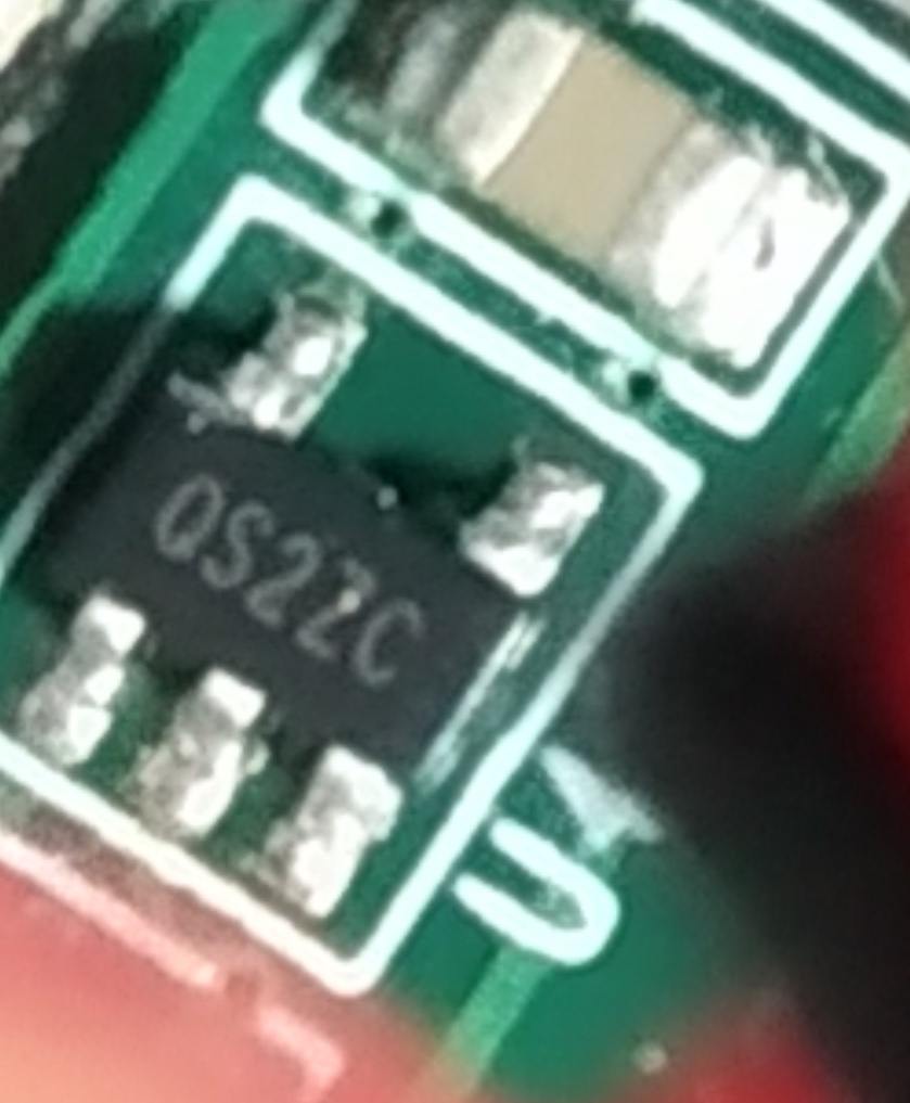

Help! I had a perfectly working DAM 1121 until I recently moved. The output now sounds as though its over driven, raspy sounding. Checked all the input voltage levels, they all looked correct.
FYI - I use 3 Salas BiB shunt regulators for the digital 5V, analog +/- 5V.
Any clue on where to troubleshoot?
Well, its safe to say that it is a regulator I think - but which?
Maybe. Could also be something like: https://www.torexsemi.com/file/xc61...XC6112-XC6113-XC6114-XC6115-XC6116-XC6117.pdf ...Measuring voltages should make it more clear.

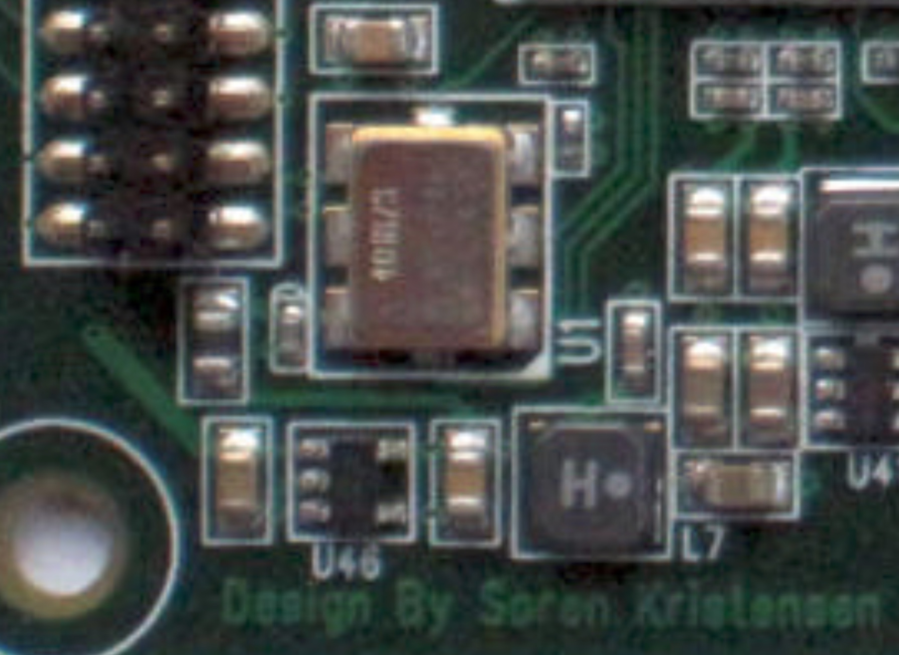

Has anybody done any improvements to the powering of the clock on 1121? How? Pictures?

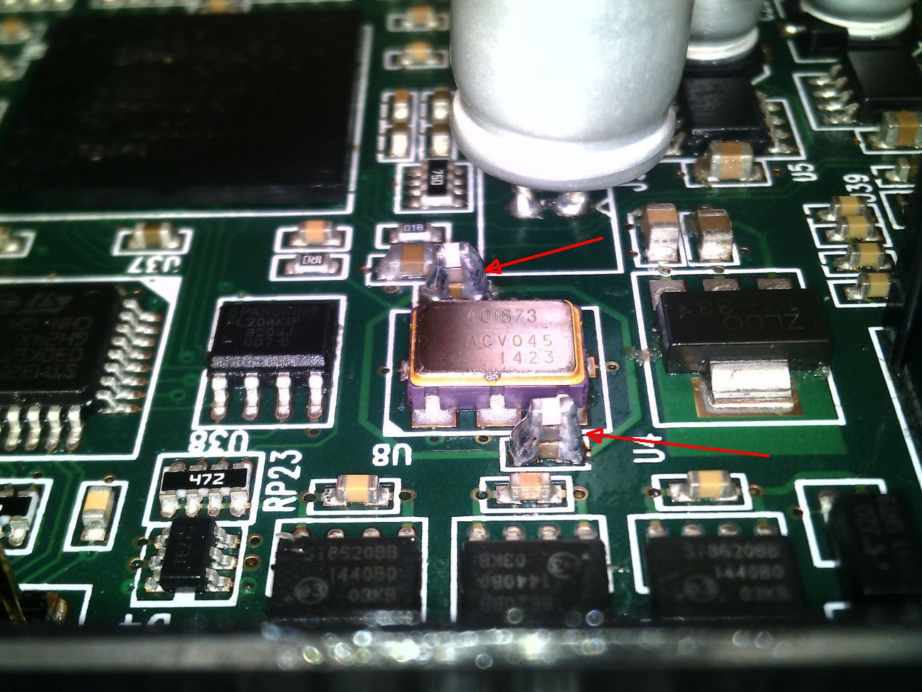

Here's what I did on the DAM1021,
I've added caps to the two nearest caps of the clock, to get best decoupling into MHz.
If there are vias around those two caps in the 1121, the same should be possible

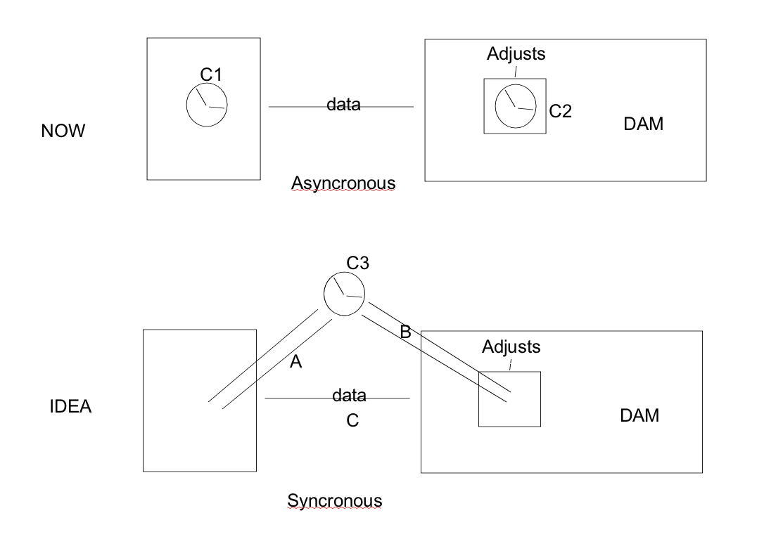

Anyone tried feeding I2S_LRCK_O and I2S_BCLK_O into a Raspberry Pi source? So that the RPi uses the dam's clock to generate I2S data instead of its internal clock?
I tried on my single-board dam1121-01 but to no avail. I'm not even sure it could... is the dam's clock running at a set frequency at all, or does it first wait for an external I2S clock signal to match?
What I did was tap J3 pins 9 and 11 (before the 3K3 strapping resistors to ground -- as per the example schematic) and feed them to GPIO 35 and 12 on the isolated header of an IanCanada IsolatorPiII board. This resulted in no audio regardless if the IsolatorPiII was in master or slave mode.
I'm not sure it'd matter much, but thought it wouldn't hurt to try!
